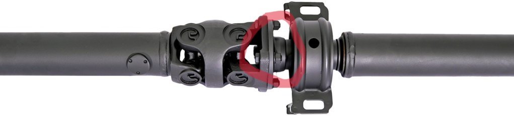

    I can almost bet exactly what's causing that click sound. There are splines that are concealed underneath the flange that joins the drive shaft by the center bearing. If the castle nut comes even slightly loose, you will get a click, sometimes a creaking sound when you take off from a stop or sometimes when you are braking. It is very common with the gen 1's and older Tacomas too.
    If you pull the flange off, you will see the splines. Slop some grease on them and retorque the castle nut. That will fix your problem. Try this first before tearing into anything else, it is the easiest thing to rule out.
    I'll bet 10 bucks right now that your cardan joint is fine.

    Took everything apart again today. Watched the video above and broke down the cardan joint. There were no needle bearing left inside the ball of the cardan joint. The spring was broken and the "tube" that the spring sits inside had been worn down and the end mashed partly shut. Due to the amount of damage to the tube, just replacing the ball, spring and seal probably wouldn't totally fix my problem. I'm done throwing money away so I guess I'll be buying a new driveshaft. Or a good used one if I can find one at my local yard.
