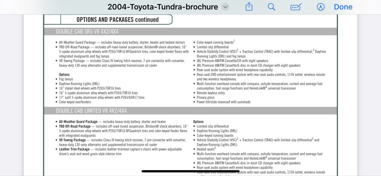

    My guy added a number of things but not VSC. According to the 04 Brochure, it was however an option for SR5 and Limited.

    Nice. I thought it had something to do with the 5spd and the weird speedometer/wheel speed sensors.

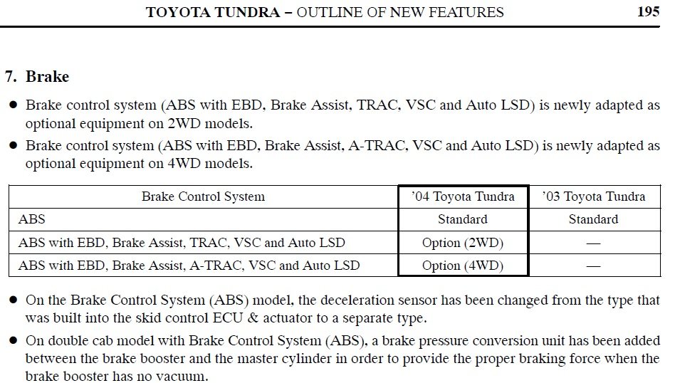

    Looked little further after yard work in this God awful heat and according to the 1st Gen New Features of each year, 04 was indeed the year they made VSC optional.

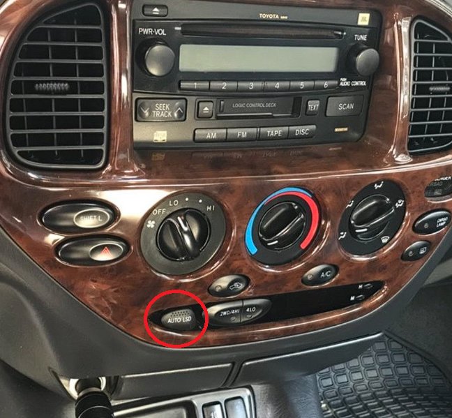

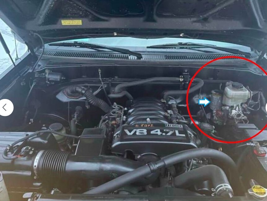

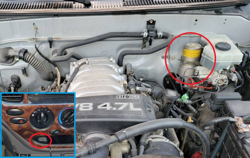

    I'm tossing up two examples of VSC identification in 1st gens, pulled from my local CL
    Keg can + the stubby MC + "Auto LSD" button, this is on a 2004 DC 2WD:
    This is taken from a 4WD:
