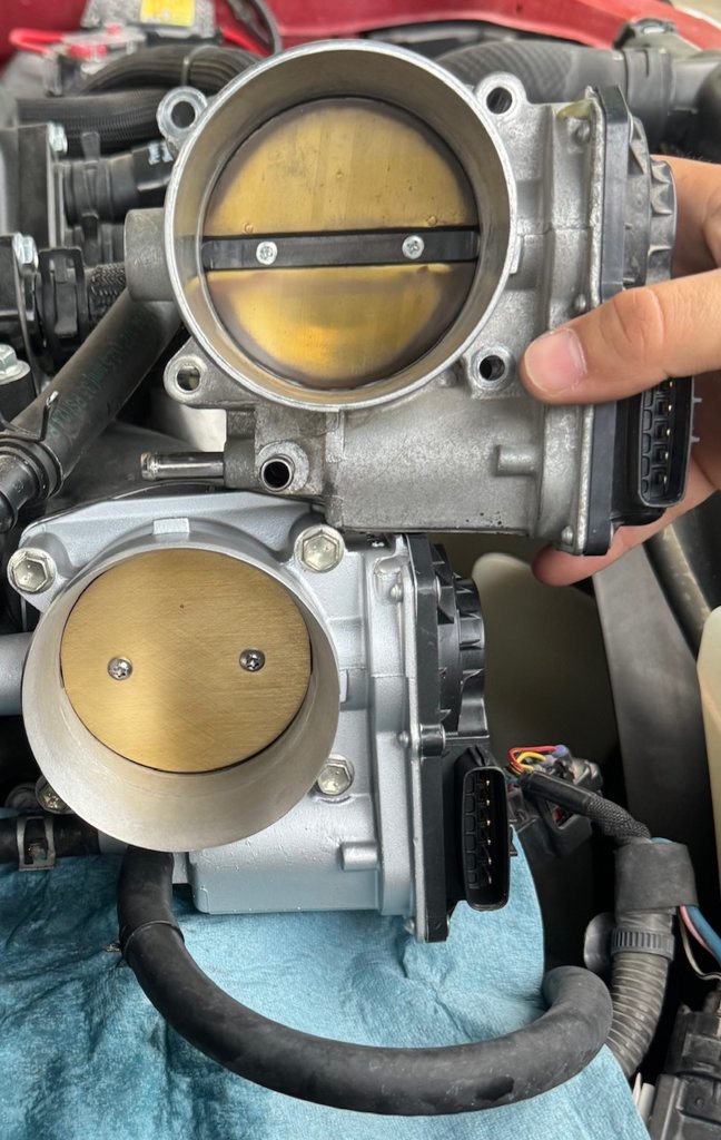

    Having had issues with Jet performance products in the past, I wouldn’t touch it.
    Given the options available right now, keeping it plug n play, the rcf+adapter like others stated or ported.
    personally I swapped to an OEM ported TB.
    Cost was a lot lower compared to the RCF when I was looking at the time.
    Stored away my original OEM since I plan to swap to the @snivilous TB when it becomes available.
