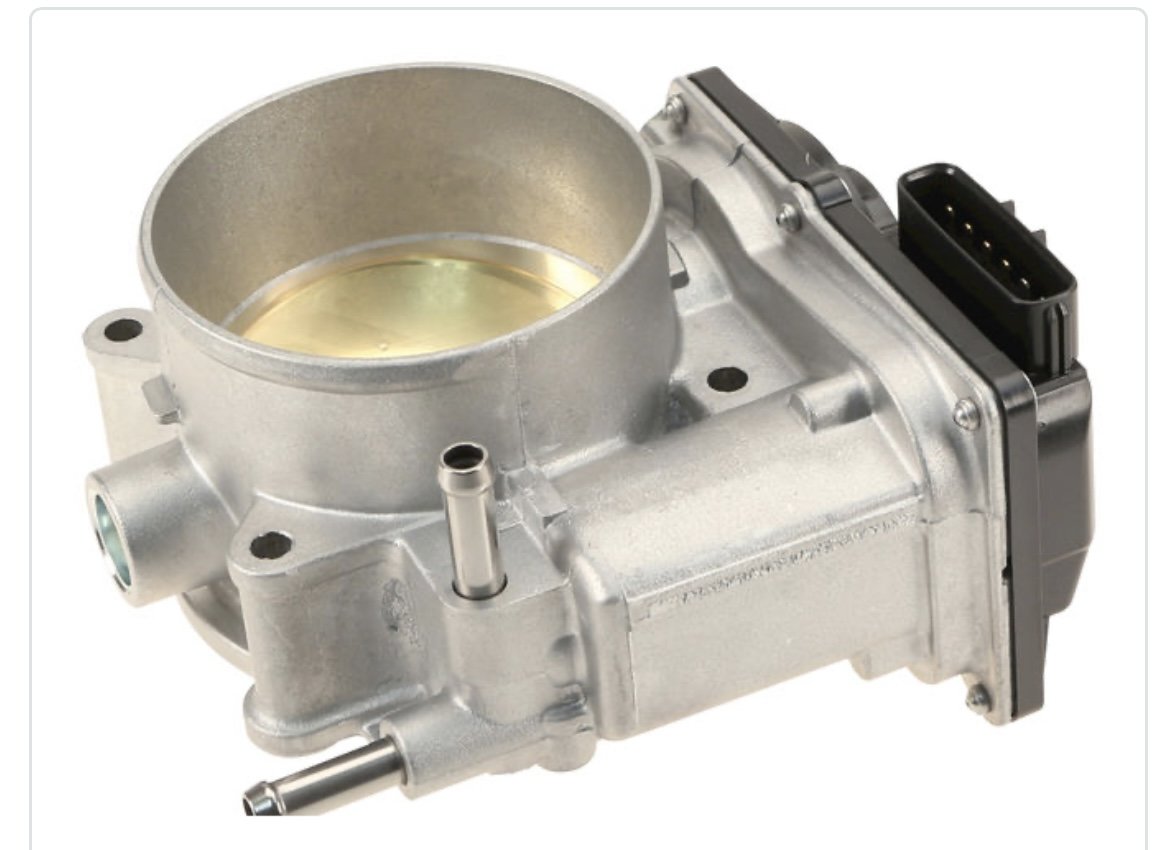

    No problem will answer to best of my abilities, ask away. As stated earlier I installed and new TB and the picture I have attached shows the connector in which I remove to stop the noise. All I removed the old and installed the new TB. I have done the relearn procedure you have posted from earlier a couple of times without change. The boy will go work on his truck and forget to unplug the TB and the battery will be dead so numerous forced relearns. I bought this truck for $2k with 159k miles on it, project for him and I to do together. Teach him how to use tools basically. The Throttle position sensors is part of it correct? The new one I installed was plug and play for a lack of better terms.

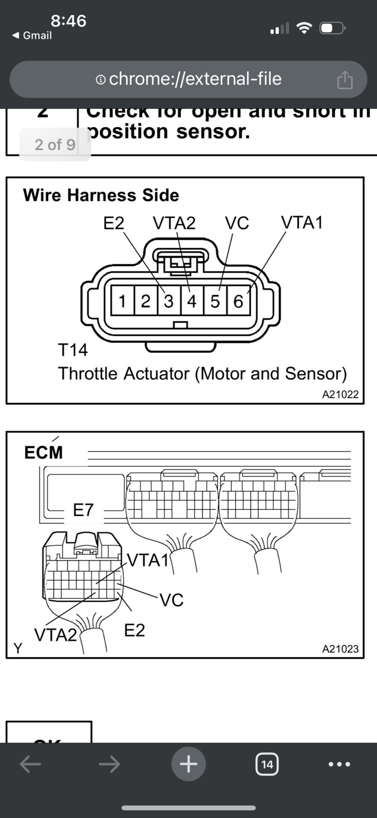

    Throttle body position sensor is part of the throttle body for 2004 (and later years I believe). Here are the relevant pages from the FSM if it helps...
    shifty` likes this.
  12. Jul 30, 2024 at 2:12 PM
    w666
    w666 D. None of the above
    Dec 17, 2019
    #40020
    1,860
    Maryland
    04 Access Cab SR5 V8 4WD
    And this

    Looks like I have some work to do this afternoon. Thanks guys for all the information. Time for my son to learn how to read a meter today…

    Looks like I have a break in continuity on E2 from the throttle body connector to the ECM connector. Gives me something to look for now…
    Thanks for all the information fellas!
