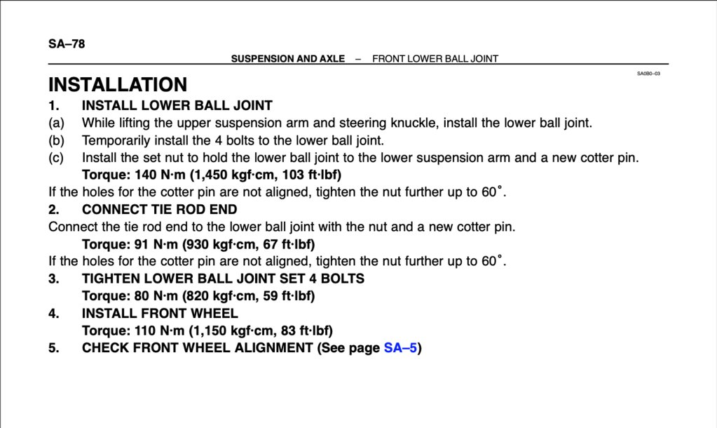

  25. Sep 11, 2025 at 3:21 AM
    #25
    The Black Mamba
    Sep 6, 2023
    #103472
    5,285
    BlackSnek
    Flower Mound, TX
    Black 00 SR5 AC 5VZ PreRunner
    Imma keep it stock
    Taken from the FSM. No thread locker mentioned
    KNABORES and Jack McCarthy like this.

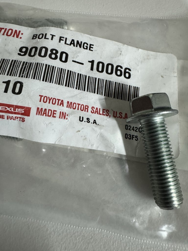

  26. Sep 11, 2025 at 3:39 AM
    #26
    bfunke
    bfunke Tundra Curmudgeon
    Oct 13, 2019
    #37321
    2,735
    South Carolina
    2018 SR-5 CM 5.7, 2000 SR-5 AC 4.7L
    The new bolts have a greenish coating on the threads which may be a threadlocker.
