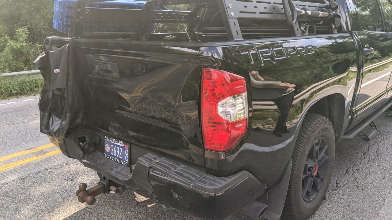

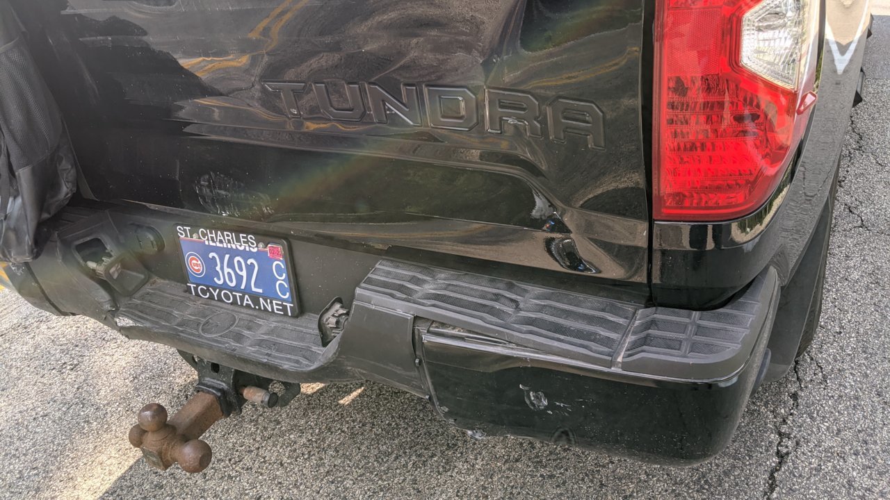

    7 months old and this..... stupid ford guy, we were dead stopped in traffic and he claims to have slipped off the brake and onto the gas. So far it looks like bumper and tailgate but I am hoping no frame damage. Computer is flashing airbag system light malfunction and a seat belt light wont go off, truck drives fine, gate wont stay closed.

    edit. your trailer hitch kicked butt.

    sorry about that. Just get it checked out and hopefully it is just some parts and no frame issues. Looks like your bed is not buckled, which is good.
    His ford looks pretty damaged, and leaking. Going to be a big bill for him, full front clip and hood, lights and some mechanical components at a minimum. Also looks like his driver side wheel may be sitting back farther than the passenger side $$$

    Yeah Ford is dead lol. I looked under mine and I don't see frame damage, hoping its just a simple bumper and tailgate, bed seems fine. I always leave the tow ball on for this reason. I am just pissed we just got the truck in Jan. I thought having the same insurance would make it easier but after searching and reading some others posts in here sounds like that makes it harder. State farm and the guy totally admitted is was his fault, which was obvious

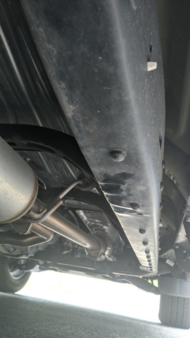

    I am guessing this isn't normal or good right? Its on the passenger side a little past where the bed and body come together.

    mine is smooth. That looks crinkled

    Yep I am sure he was fiddling with his phone, really irritating having a truck so new and this happens and now it looks like there is some frame damage

    Really surprise to see the frame distortion with what looks like somewhat minimal damage to the AFT end of the vehicle. Guessing the hitch displaced all that force right into the frame rails. When the insurance gets you a new Pro, maybe look into a stout set of sliders to help strengthen the frame? Hopefully you wont need it, but "a just in case" like the hitch.

    I definitely thought if there was frame damage it would have been down towards the bed and where the impact was. What should I do if they try to just fix this?

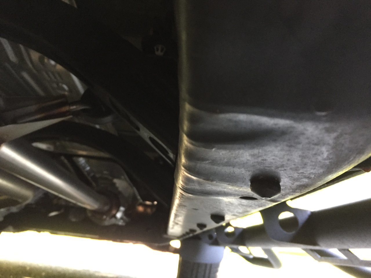

    Siberian, I'm pretty sure that section of frame you have pictured is normal, and just due to the way our frames are manufactured. My frame is the exact same way and has never been in an accident. If you look closely at that area where the ripple is, its right where it begins to bend and head up to the bed. I'll add some pics of mine, and a vid I found of a Tundra on its side. Look at the 10-11 sec. mark, and you will see the same ripples. Maybe others here can take a look in the same spot on theirs to confirm this.

    the thing with trailer hitch is that it will transfer the blunt of the impact to the frame.
    Best in this case is not to have any where the impact is all across the rear bumper instead.
    However it does a good job at messing up the culprit front end :)

    I think you got lucky with the hitch being in and not bending the frame down. Those receivers act like a lever.

    Here's a few more ripple pics.
