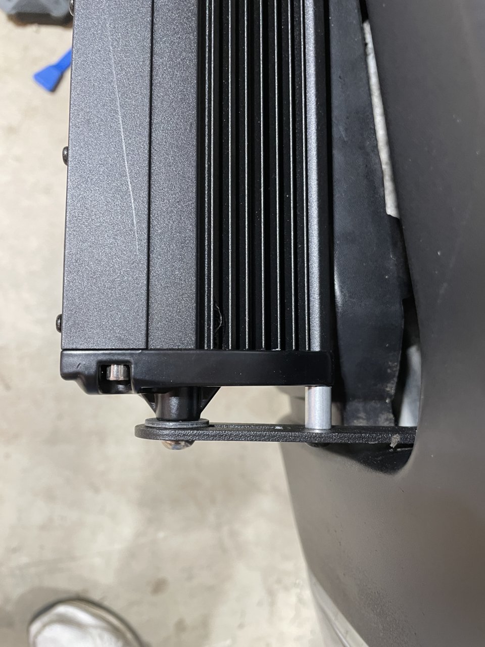

    This is what I did to fix the bar from moving. It’s rock solid:
    the back screw is already threaded on the light bar, so just picked up a short screw and aluminum bushing. Just have to drill the back hole in the bracket and put that all together before you actually bolt the bracket to the bumper mount.

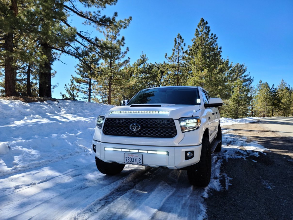

    got the 42" and very happy with them.

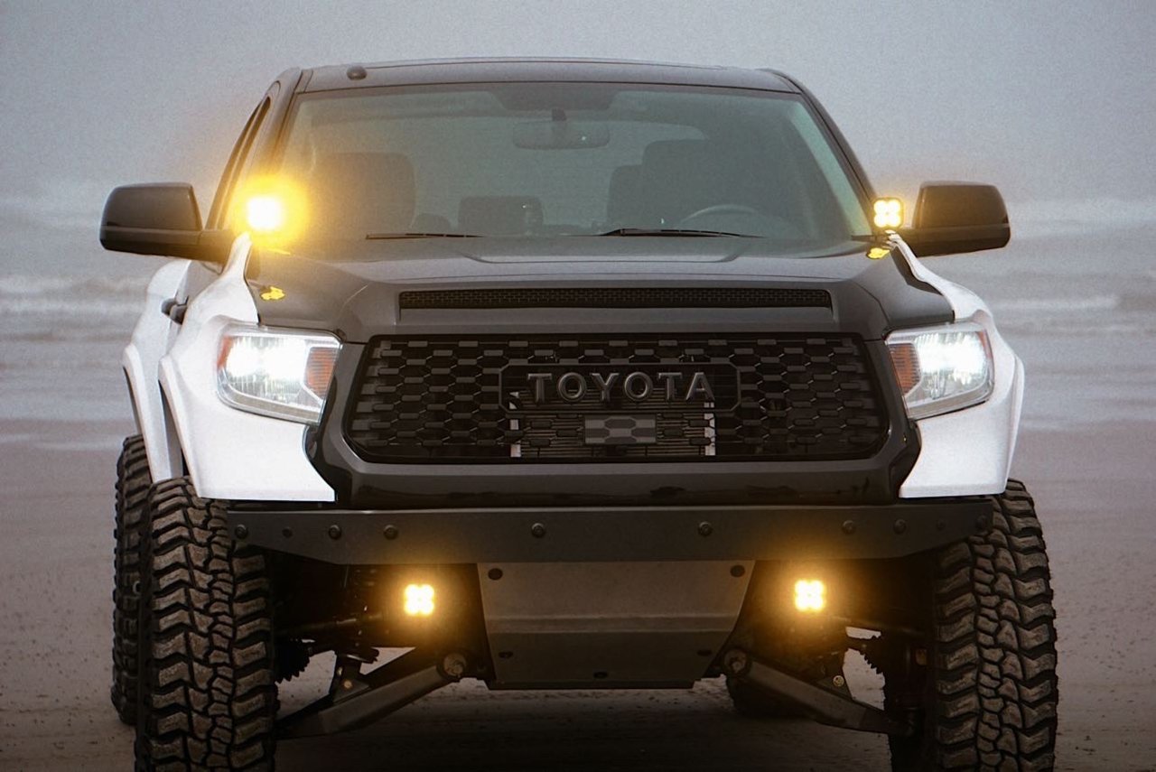

    Big fan of their lights and customer service is top notch. Probably throw some white SS5 Spots behind the grill later this year.
