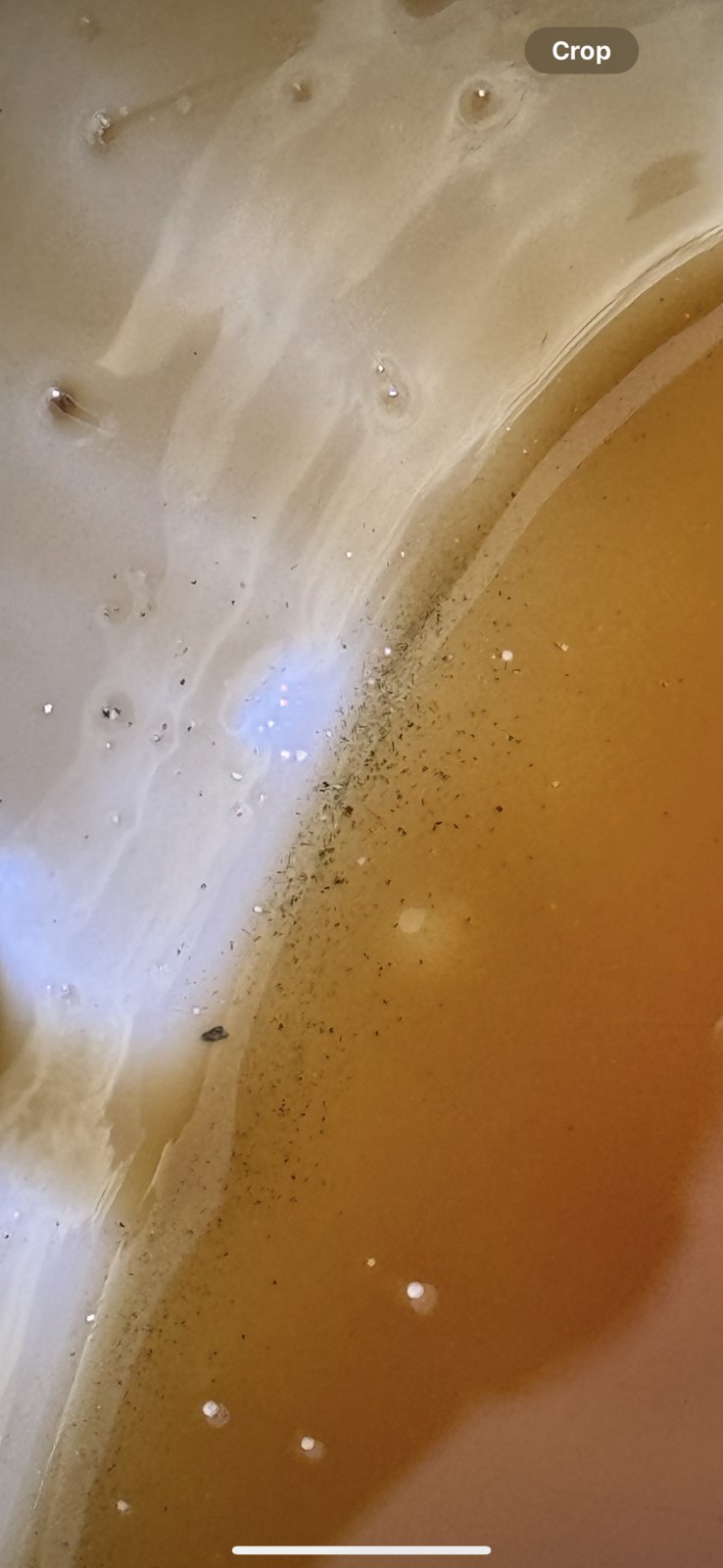

    I have been changing mine every 5K. I had a cam failure at 19K , but since the repair no issues at all. Now at 41K
    The shavings you see after an oil change is not telling the whole story. Like it has been said earlier , open your filter. That’s where it’s all at .
    The ones that will do the most damage are in your filter and they were in the bearings doing damage before they were filtered out.
    I’m having difficulty believing this is strictly a cleaning issue.
    These type of issues can be relatively easy to resolve in the production process. The design problems are not.
    My camshaft was frozen in the seat. it went from 0 to failure . Tried to start in the morning and it wouldn’t move.
    They had to replace the cover as well due to damage. So I’m thinking its more then shavings.
    We will find out in time.
