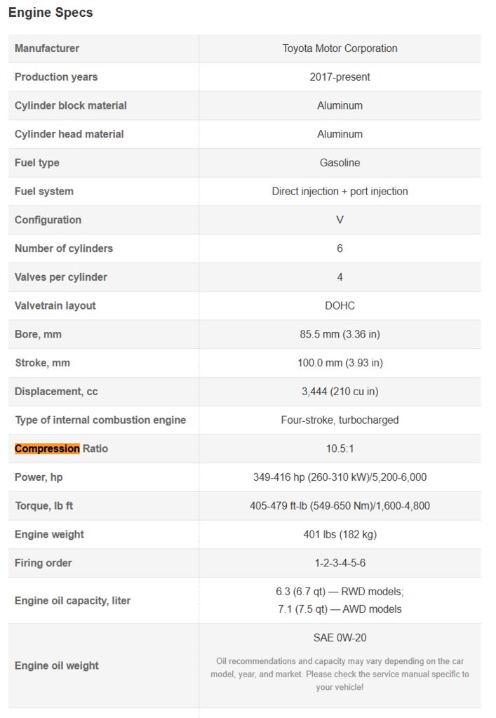

  27. Jul 10, 2025 at 7:12 AM
    #27
    badass03taco
    badass03taco [OP] New Member
    Mar 8, 2024
    #113307
    495
    2005 Limited Double Cab 4wd
    10.5-1 compression isn’t all that bad. It makes a very lively boosted engine with decent power off boost. But my point is if that thing is creeping up to 12-16psi or more at 10-15% throttle on high load situations, this is a major recipe for detonation. The Direct Injection atomizes the fuel into even smaller droplets than a standard injector which furthermore increases the Likelihood of detonation. The direct injection is supposed to be able to control when the injector sprays better than a standard injector but…. If boost is creeping up at low throttle and the tables in the computer are looking at commanded load and throttle percentage and calculating fuel delivery and not accurately also accounting for boost build up in off throttle situations you got an extra volatile and ever increasing recipe for detonation. Detonation creates every single problem we are seeing in tear down videos.
    I don’t know what the factory boost is on the new tundra. Does anybody know what it actually builds? Seat of the pants and listening I would assume it’s 20-22psi

  29. Jul 10, 2025 at 8:15 AM
    #29
    Daedalus
    Daedalus New Member
    Feb 24, 2025
    #130881
    340
    Factory boost i believe is around 12-15psi ish. Nothing big. LSPI, and poor fuel quality and oil quality..sure i can see that happening.
    10.5:1 is fine on a NA engine..but compounded with boost, it HAS to have 93.
    For reference, my GTI had a 9.6:1 CR, and was 8-10psi, and factory mandated it run 93. At the end of the day, its about cylinder pressure, octane rating and nothing getting into the combustion chamber (oil that can precombust).
  30. Jul 10, 2025 at 9:02 AM
    #30
    badass03taco
    Mar 8, 2024
    #113307
    495
    Yeah i agree, 10.5:1 compression ratio is perfect for an NA engine and on low boost like 6-7psi its an absolute hoot. (with 93) and yes for these higher boosted engines if its 1bar or more, you cant run without 93.
