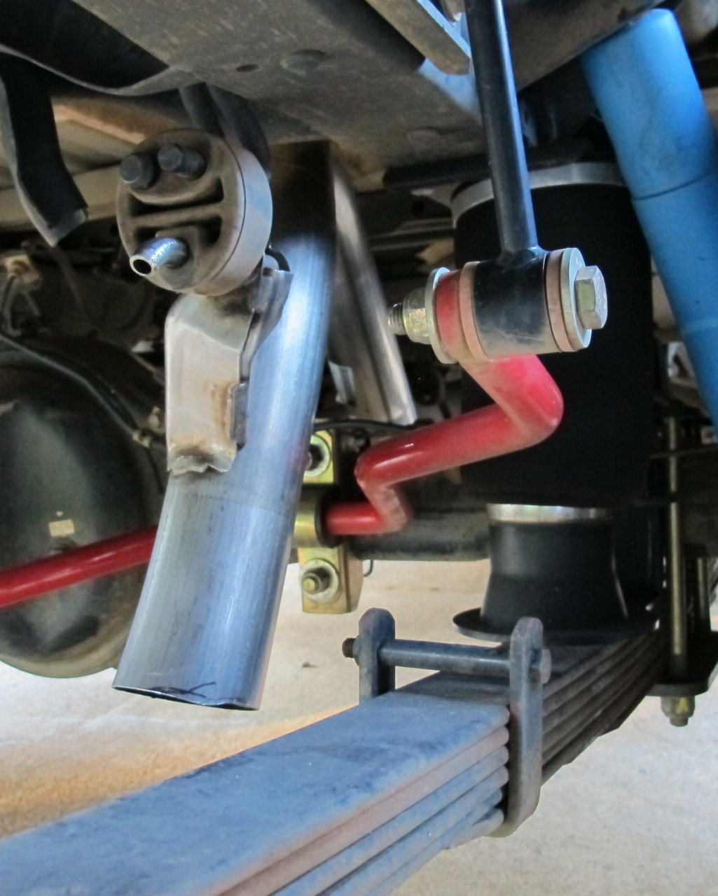

    Rex Kramer
    Rex Kramer Vinyl Spinner
    Apr 9, 2017
    #7181
    6,612
    Georgia
    2002 4.7L RCLB 4X4 2007 5.7L RCSB 4X2

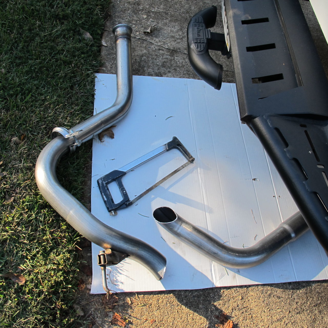

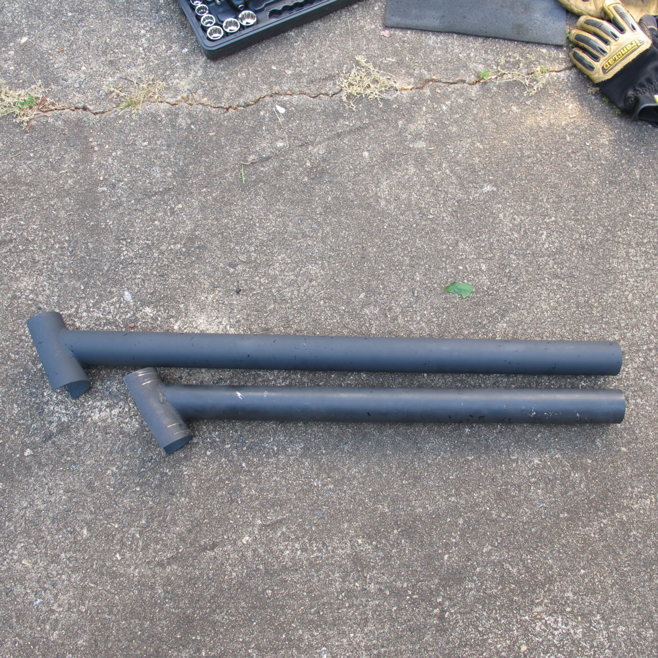

    Dumped BEFORE the axle sucks.
    Dumped AFTER doesn't produce as much extra torque as a factory length tail pipe, but it's still a net gain if you have a BAMuffler system. You will want the extra long resonator that Keith makes for the over the axle cut & dump.

    Another vote for dumped over the axle.

    Todd
    Greenwell Springs LA.
    2019 1794
    Kings, 5:29's, E-lockers on 37's
    I have this same setup, cut in the same place. EXCEPT I do not use the resonator, absolutely love it
