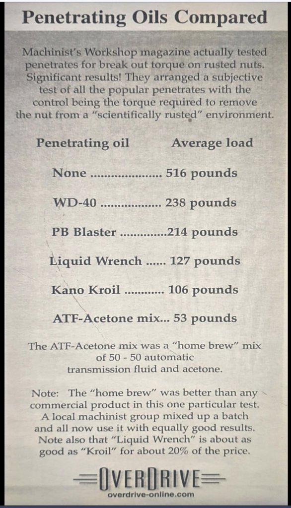

    Funny, just saw this today. Might help someone with rusty nuts.

    Well that’s good to know going forward.
