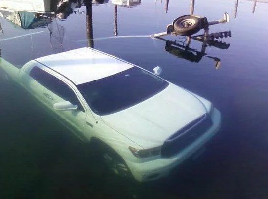

    =BAD
    PhotoNerd, blackdemon_tt and hagrid like this.
