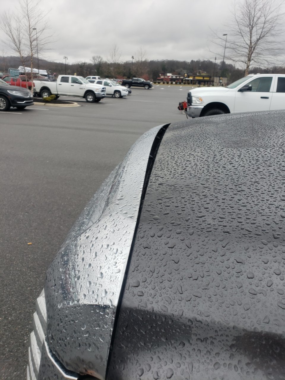

    I'm at last whits trying to figure out is causing this???
    It keeps popping out!!

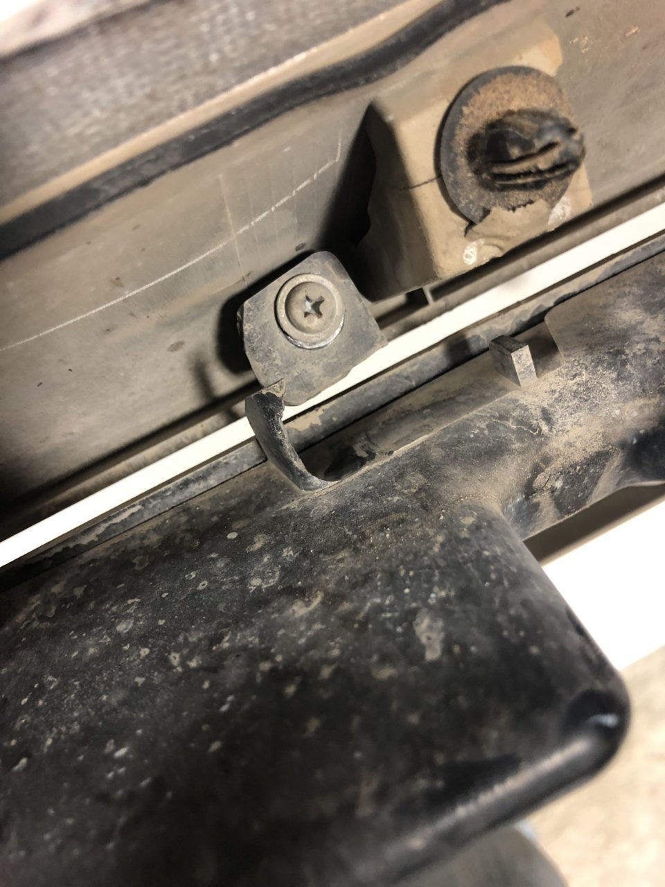

    First time I've seen anyone mention this before here. Are the plastic mounting clips damaged?

    Worn retainer clip or warped bulge. Loosen all the 10mm bolts, snap it back in and tighten, but not too tight.

    Had an sequoia do that and the clip was broke. It’s was on a 08.

    Mine were wore out to the point I had to replace the hood bulge.
