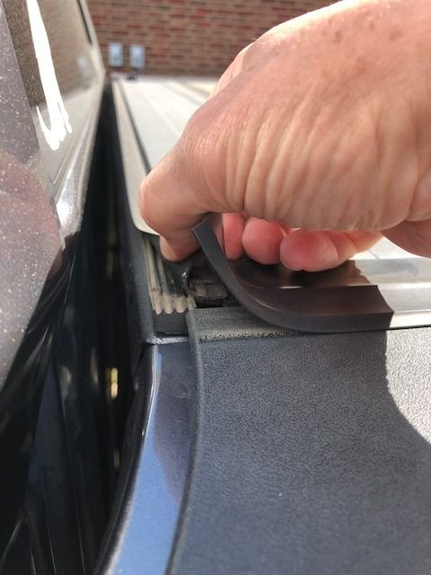

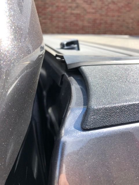

    I just installed an undercover flex armor. Probably going to return it. Two big issues:
    1. I can almost guarantee it is going to leak like crazy based on the gasket at the cab. The first picture shoes it the best. As you can see the gasket lifts up off the rail as it gets to the side of the truck.

    You need to scoot it more towards the cab then use a heat gun to form the gaskets better.

    I think it absolutely should seal well that is the point of the product.
    If it does not you/the product has an issue. Our bed dimensions and construction are nearly identical.
    I agree installed as in your picture it is going to leak a ton. But you need to push it more towards the cab and massage the seals a bit.

    My man! Slow down, take a breath, there is nothing wrong with your cover or your truck. It is designed that way.
    The reason moving it forward just slightly (have the rubber front seal flush with the front lip of the bed) makes a difference is because when you move it toward the cab the water will run off between the bed and the cab. The cab itself blocks water from coming the front. The only water you need to worry about is that on the cover and when the truck is sloped towards the cab that water running forward and getting in.
    Line that rubber gasket up on the lip or even a little bit over it and you are golden.
    It is the same way with our 2022 and the OEM trifold (not sure who makes it). It’s not here at the moment or I’d snap a picture of it too.
    If it makes you feel a little better you can add a little bit of your own weatherstrip on the inside of the bed for a little more protection.
    The place you will get a few and I mean a few drips will be at either side of the tailgate.

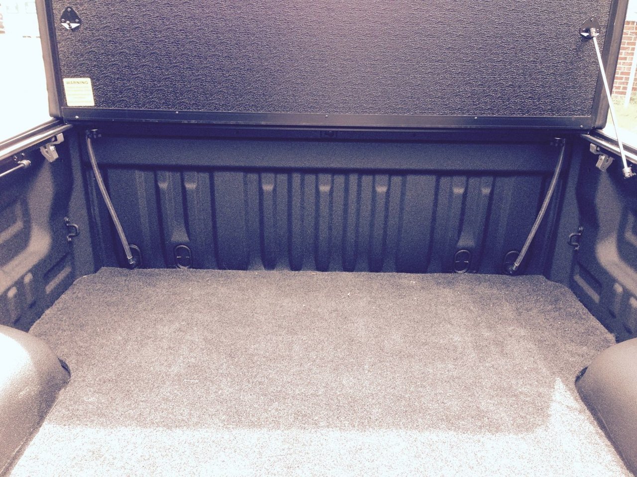

    Mine looks like the OP's pic and it doesn't leak.

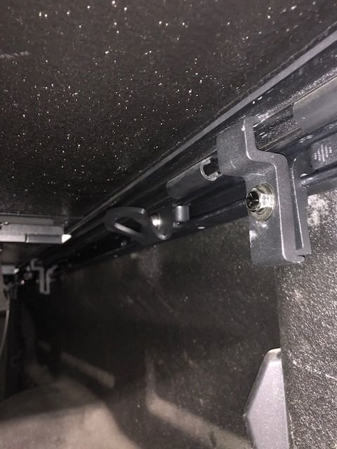

    There should be an additional seal that goes on the front wall between the bed and the cover.
    twjpizre_61f5c2505b9658f8b346a7ef7a5d3fccd0f93fc1.jpg abva8840_e0e868e041ba324b6837757e0efc9e5b49005c34.jpg
    If it does leak, Undercover has great customer service.
    They warranted my first Flex and sent a new one when the middle panel leaked.
    They also sent me free clamps when I bought the OEM rail system..
    The original bed clamps, as seen in the pic below, sucked.

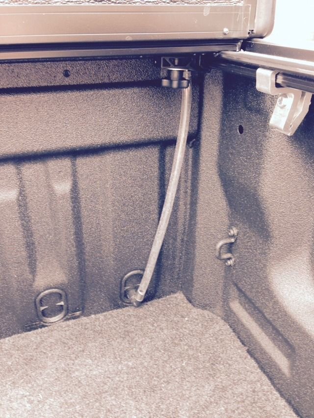

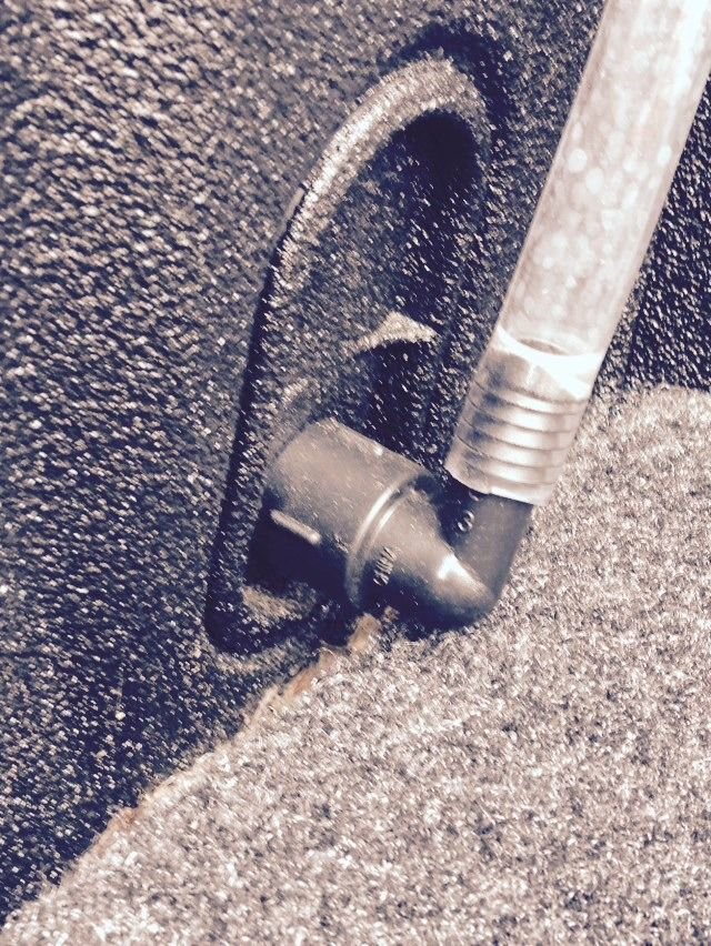

    As far as the drain tubes, I'd think they all come with cheap stuff.
    It isn't that hard to get some quality clear tubing and a few lawn sprinkler parts and make your own.
    I don't know if the 2022 has the rubber plugs in the front wall like the Gen 2.5.
    I should have put the fitting in the top of the plug instead of the bottom.
    But I'm too lazy to cut the hose and flip them..:cool:

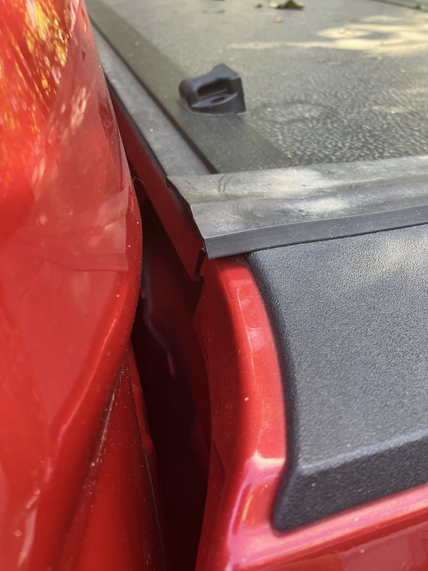

    So I tried to adjust the cover. I was able to move it back some but not as much as folks have suggested. The tie down rail on the front of the bed prevents the tonneau rail from moving back any further and if I don’t move the rail back I can’t move the cover back any farther because the cleat that clamps the cover down is blocked by the drain hole.

    Love you drain tube modification. Care to share exactly what parts you used to install? Just ordered my undercover armor flex for my 2.5 gen. Thanks!

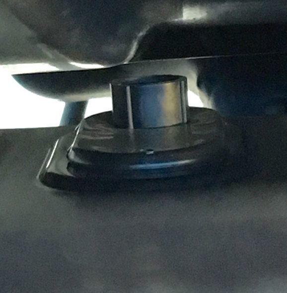

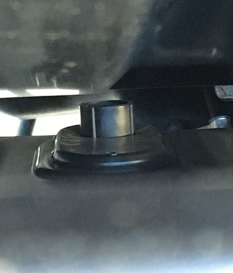

    I used some lawn irrigation fittings and clear tubing from Lowes, not exactly which ones.
    If I had it to do over again, I'd put it on the top half of the wall plug.
    45DD71E3-56FA-4AC4-865A-5F78C4F7FBFE_zps_5a53d706e2b839782ecfb17498f64efdd2e635c4.jpg C53E03AA-7462-4102-9DC9-BA6292984014_zps_c4f917294ff669ac78af1fbc5e92f77498f5207f.jpgE7CD8E3E-AEF1-433C-B495-EC0FB09F2937_zps_1e076b61158e9520cb2cc041c4885debcd7f3e47.jpg

    Awesome, thanks. So you just made a hole in the plug and put the fitting through? I’ll do it on the top like you recommend. Seems easier than a grommet.

    I have the same cover on my 2023 tundra, and same issue. If you climb inside and lock the tailgate you can actually see two spots where the light comes beaming in from the outside, in the corners. As you mentioned, you can only move it so far towards the cab of the truck. Doesnt come with an additional seal like it did for the previous generation models. I also paid $11xx for it. so kinda pissed off but. spring time comes maybe will try to mod it somehow

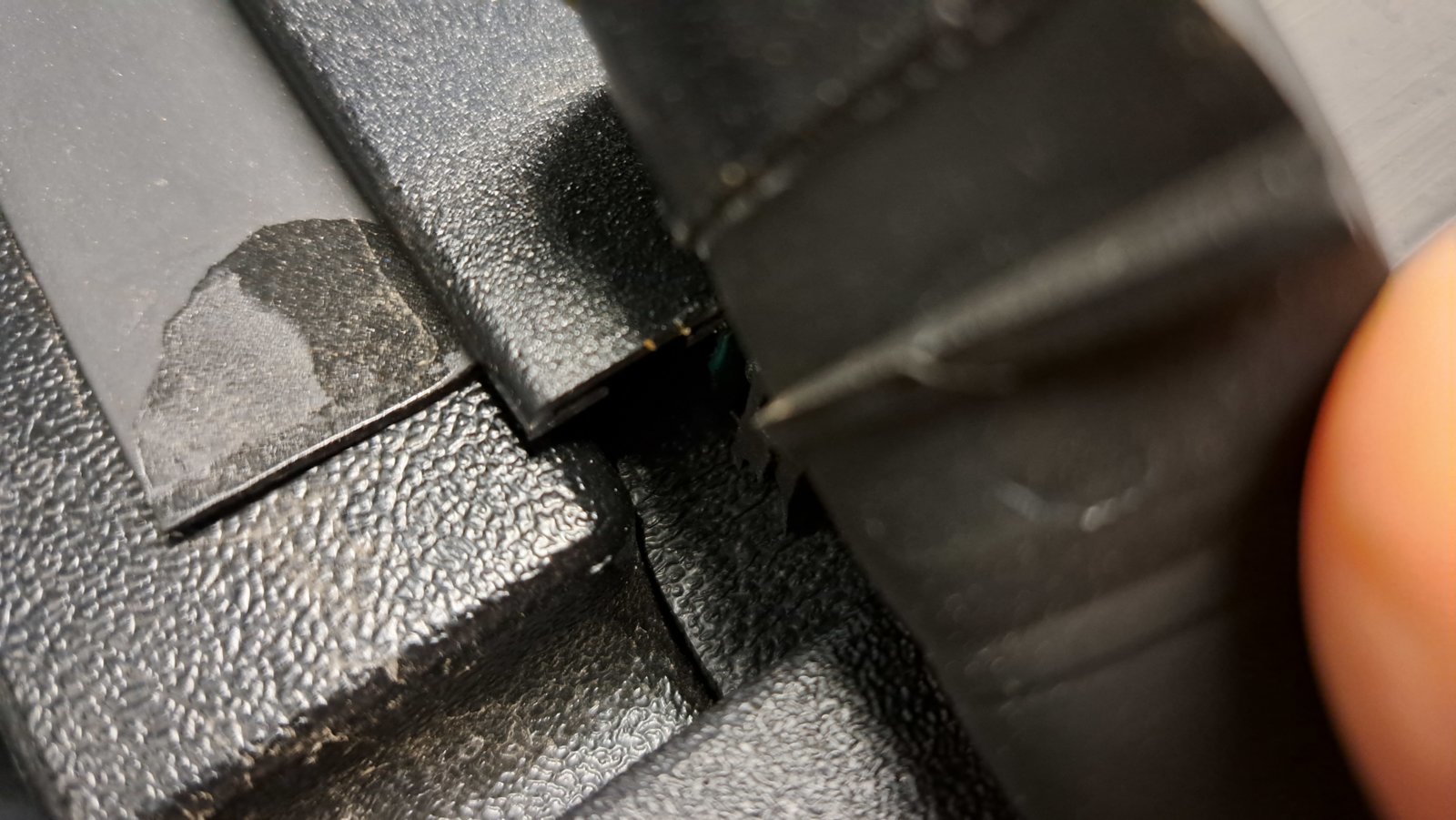

    I have the Undercover Armorflex installed on my Tundra in August 2023. I noticed those holes under the seal at the cab end. What I did was plug them with some black open cell foam tape. I also noticed that the drip rails are also open ended at the tailgate end. I sealed those off as well with exterior silicone chaulking. This way any water collecting in the rails will be forced to drain towards the front where the drain tubes are. After I did that I had no water inside the bed of the truck.
    Here is a picture I took with the seal flipped back showing the foam plug I put in at each corner.

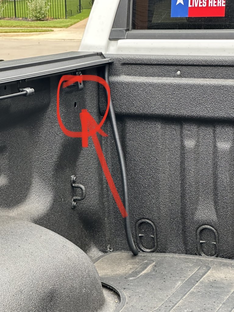

    A little late here…just installed a “new” version MX4…got it nib fairly reasonable. Really disappointed that I can’t use the cleats on the bed rail/track system! Stupid. maybe there are more low profile cleats? I removed and put that in my son’s truck.
    Anyway, about to drill for the drain tubes…would this hole work? What’s it for? Would it just drain into the fender?

    There should be 4 holes on the flat floor just under the front of your bedmat along the cab side (very tiny).
    You should only need to open up the 2 outer ones a bit and run your accordion tubes through the bottom.
