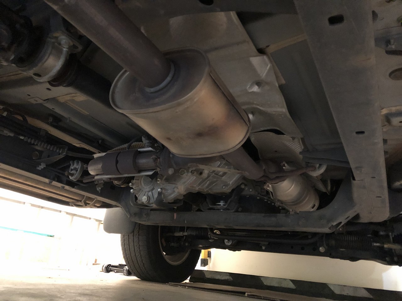

    Not the best picture, the muffler is just out of frame on the left.

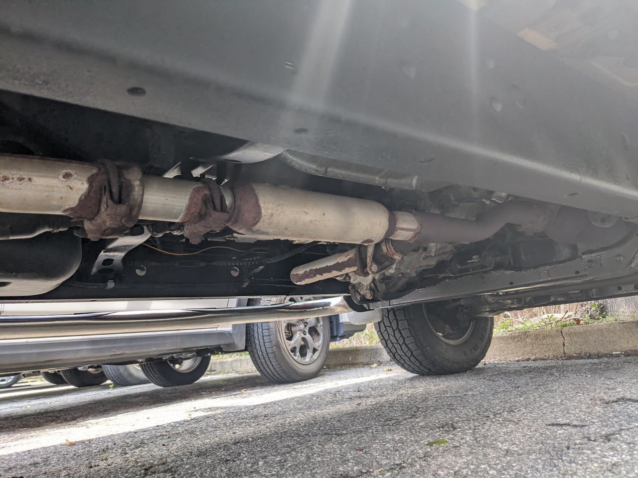

    w666
    w666 D. None of the above
    Dec 17, 2019
    #40020
    1,750
    Maryland
    04 Access Cab SR5 V8 4WD
    1lowlife and Vallejo206 like this.
  6. Jun 24, 2022 at 10:50 AM
    BromousAcid
    BromousAcid [OP] New Member
    Aug 10, 2020
    #50624
    20
    Shane
    2003 Salsa Red Pearl Limited
    This is exactly what first tipped me off to it on mine as well - O2 sensor codes. This thread seems like its what I'm looking to do. I'm hoping the flanges on mine are good, if not then looks like I'll be bringing it somewhere to get fixed up then.

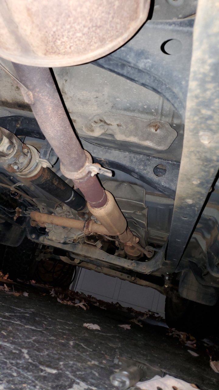

    I found the same resonator underneath my truck too.

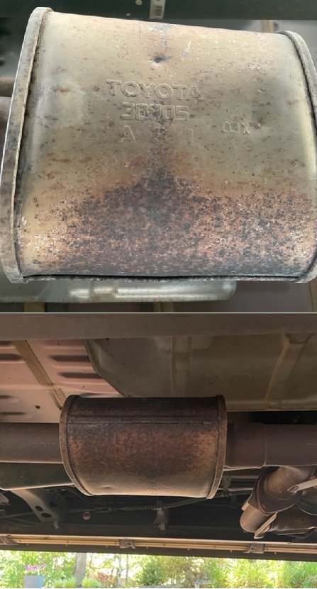

    I may be wrong but I would bet your 03 came with the same/similar resonator as my 04 DC LTD came with !
    my original resonator....

    That's the one I keep seeing when I'm searching for replacements, and should have been OEM on everything but California cars as far as I can tell.

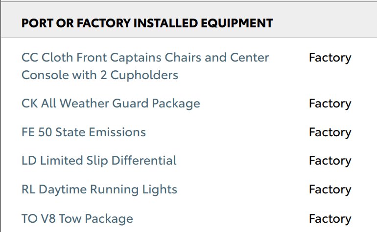

    [Edit: I'm totally not right]
    I have "50 state emissions", not CA emissions, but have the resonator.
