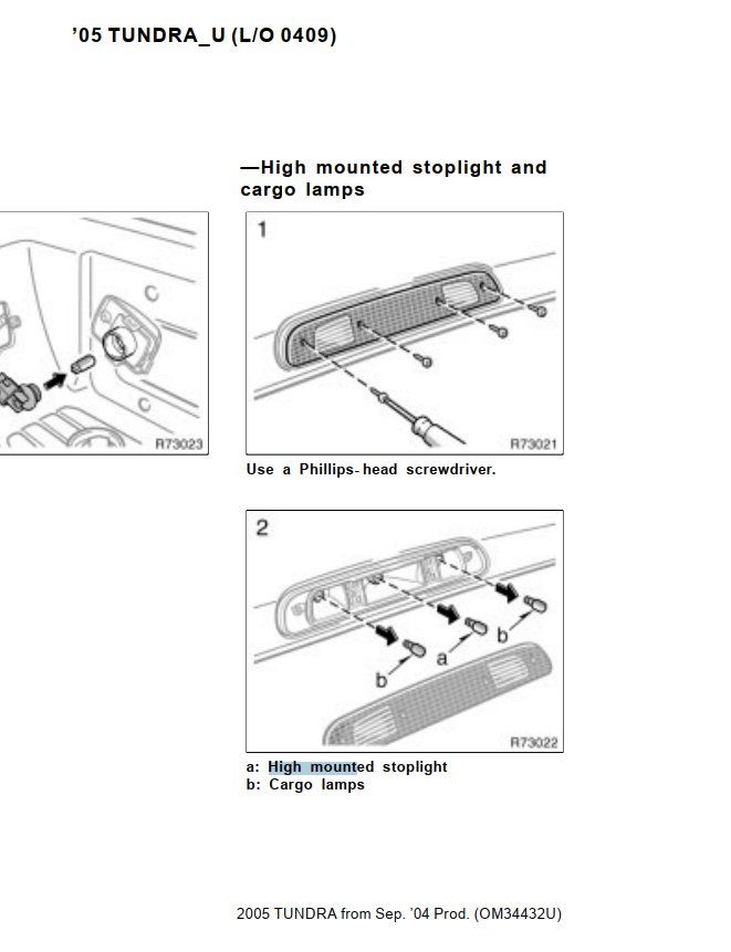

    It's my understanding it's glued in with the double-sided foam seal around the edge. I have the full assembly in my hand for the AC cab (costs $$$) and I don't see how it would be bolted in, but maybe I'm missing something. This is all I found in the FSM, they don't show removal anywhere I could find. But maybe for DC it's differnt. Does it flex or show movement when the cover is off? Maybe it has posts on the back side on the DC?

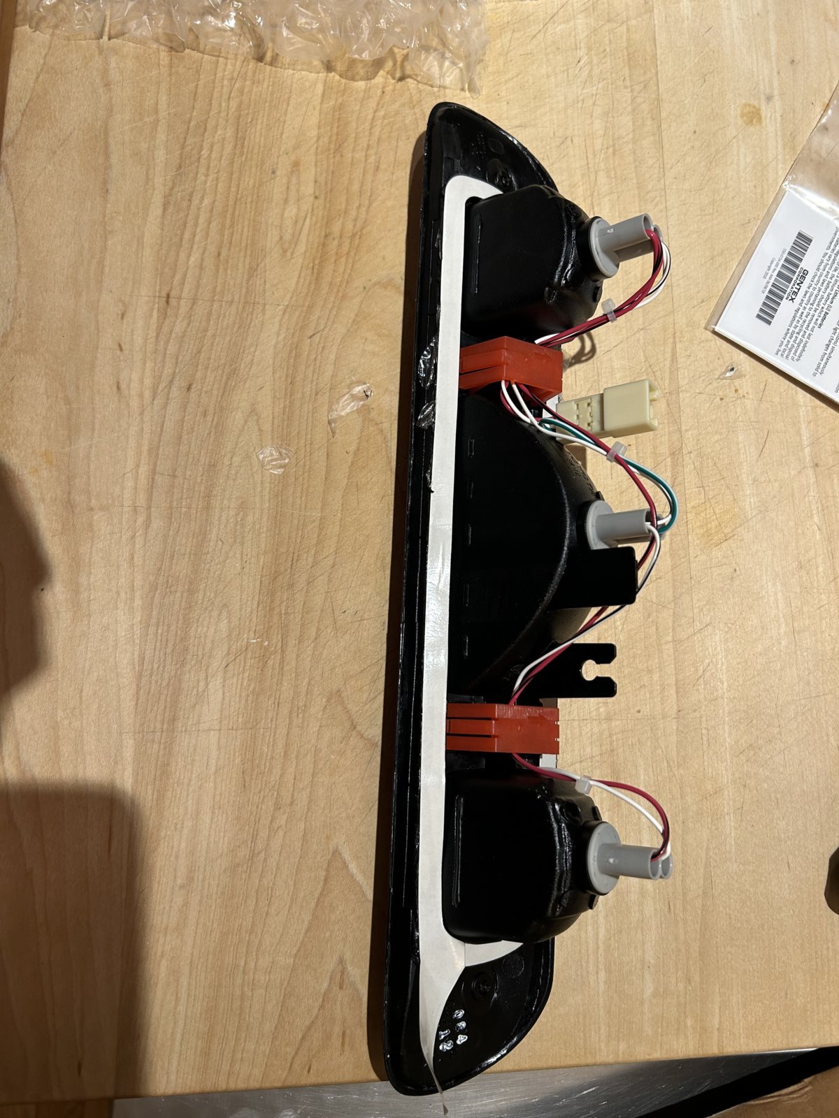

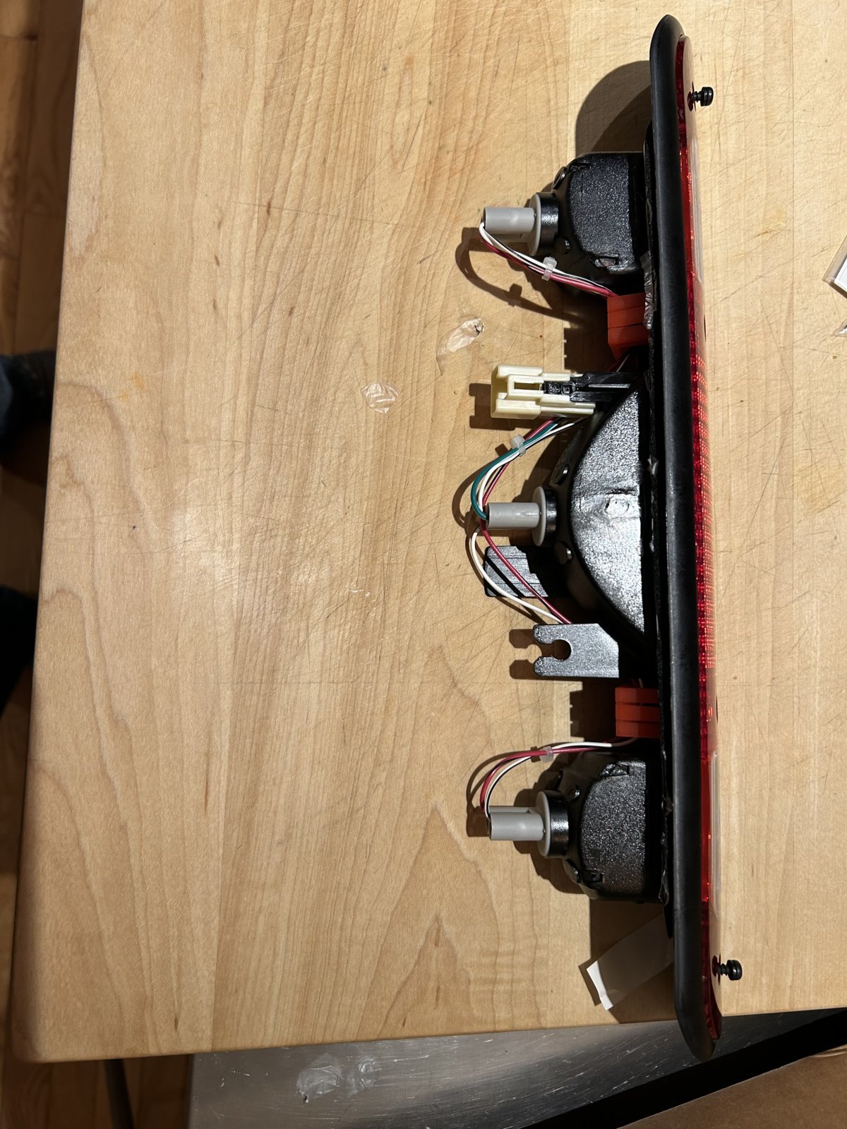

    Here’s the rear of my new assembly for historical purposes.

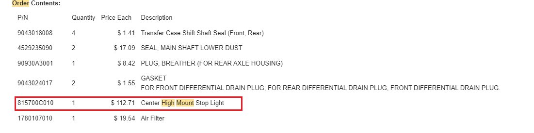

    OK, so it looks like the new assembly has a gasket on it that seals to the cab. I found a dealer in state that will ship the OEM part to me for about $125 or so...twice as much as aftermarket from Amazon, but I likely don't have to worry about the OEM one leaking as long as I clean the mating surface on the cab. I'll run over to my local dealer tomorrow to see if I can get it through them for the same price (or cheaper). Thanks much.

    Yeah, it's definitely not a cheap part. But if you need it, you need it. I paid $112 for my assembly.
