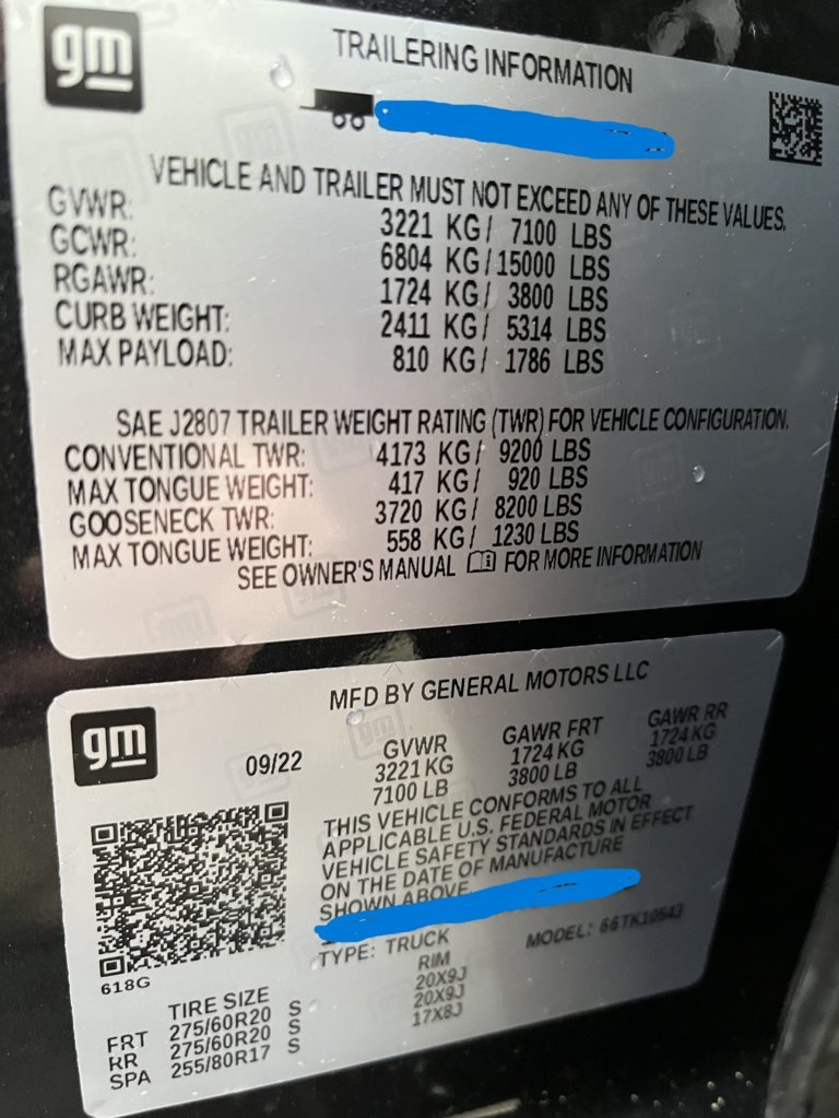

    I'm looking to switch from a 2022 GMC 1500 Elevation to a 2025 Tundra Limited. I tow a 21' fiberglass 5th wheel and called Toyota yesterday, they couldn't provide me with gooseneck towing specs. Interestingly, my GMC list the specs on the door frame sticker. Does anyone know where I could find this information?

  8. Sep 10, 2025 at 7:47 AM
    EscapeTower25
    EscapeTower25 New Member
    Monday
    #140477
    4
    Yes, here's a copy. I'm just surprised Toyota doesn't make this readily available:
    Cpl_Punishment likes this.
  9. Sep 10, 2025 at 7:50 AM
    KNABORES
    KNABORES Sarcasm incoming
    Jan 1, 2020
    #40572
    15,228
    Arkansas
    Pardon my ignorance on this, but is the gooseneck rating the same as the 5th wheel rating?
  10. Sep 10, 2025 at 7:59 AM
    EscapeTower25
    Monday
    #140477
    4
    As I understand it, there is a gooseneck rating which is the weight of the pin box (Max tongue weight) on the bed and the trailer weight. On my half ton with the tow package a bumper pull has a higher spec than a gooseneck.
  11. Sep 10, 2025 at 8:08 AM
    KNABORES
    Jan 1, 2020
    #40572
    15,228
    Arkansas
    Has a higher tow rating, but not a higher tongue / pin rating
  12. Sep 10, 2025 at 8:14 AM
    EscapeTower25
    Monday
    #140477
    4
    Yes, sorry mixed that up.
