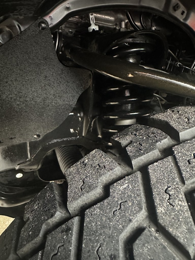

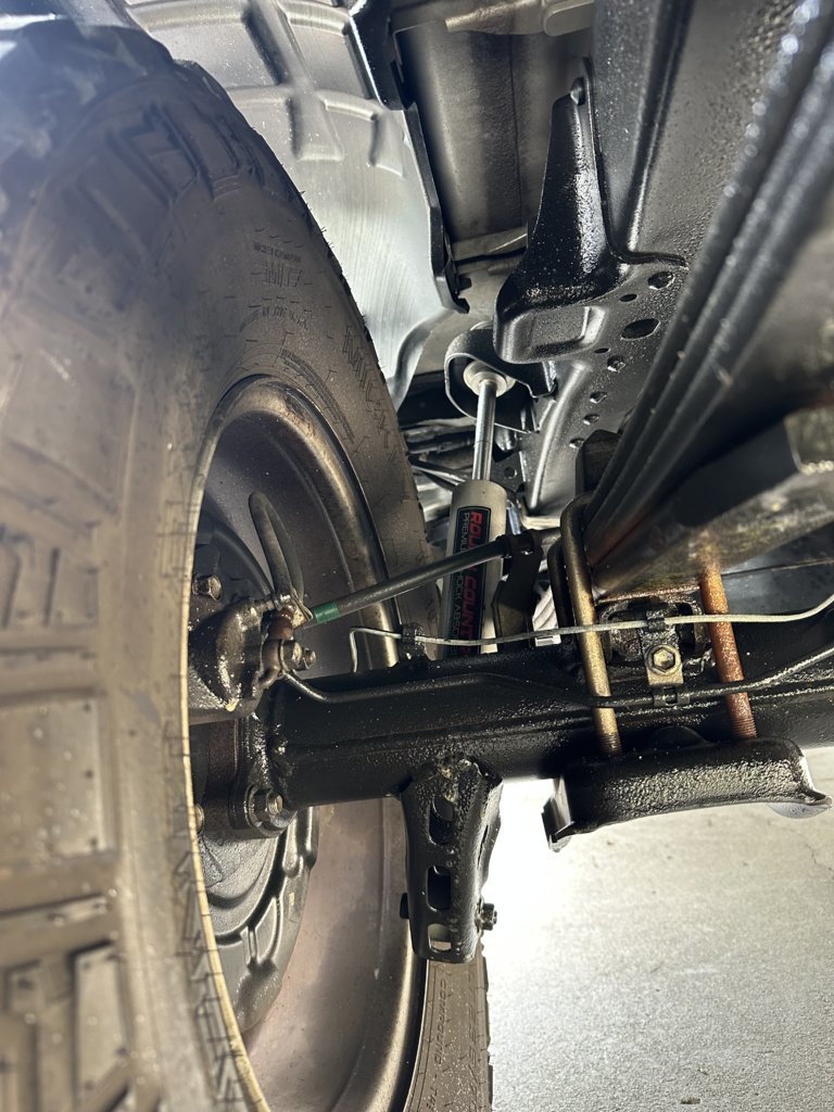

    I bought a new project , ‘14 SR5 CM with 150k , old owner installed RC 2” coilovers . I feel every crack in the pavement. I would like to get something better than the RC (they have 40k on them according to service records) Is the 6112s the go to? Is it going to ride as rough as the RC ? Is there something better than the 6112s or are they what I need? Pic of front and rear

    “Comfort” is subjective. If a soft plush ride is what you seek, factory black shocks are soft. 6112s are not typically described this way. Most will call them firmer than factory, but well controlled. They will be a major improvement over any crap RC sells.

    @SC SR5 - I can absolutely help get you a suspension upgrade that will be a dramatic performance improvement over what you have. The million dollar question I have for you is this. Are you willing to spend ~$4-5k to get a very high performance suspension system, or is sub $2k more your speed? There's good options at both levels, and perks to be had at the upper tiers. Just gotta know where you're at, and I can make some recommendations.
    Does your rear end have blocks or anything back there, or is that at stock height?

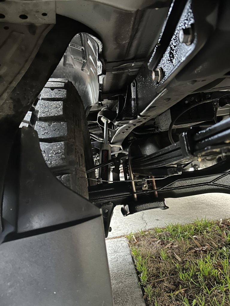

    They look stock , I sent a photo

    Correct. Stock rear so you're all good there.
