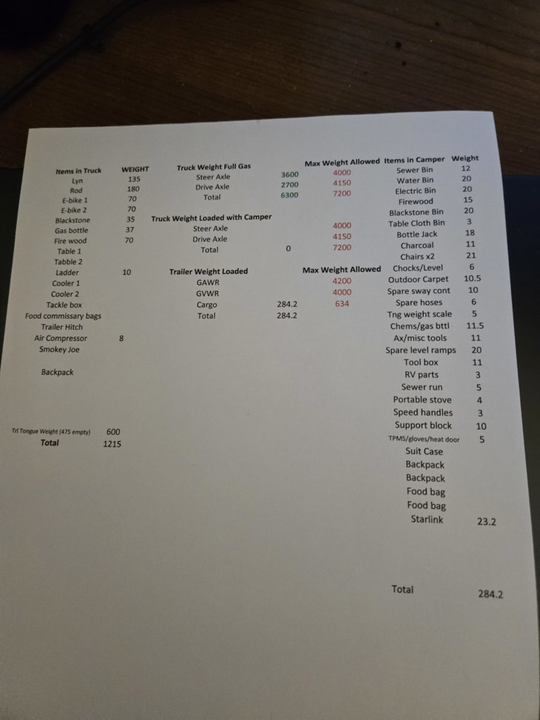

    Crunching numbers for shits and grins and almost weighed everything ... even with a lightweight trailer we're going to bust somewhere. Hitting the scales fully laden in about 3 weeks to see where we end up and possible reconfigs.

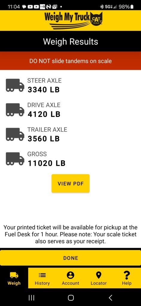

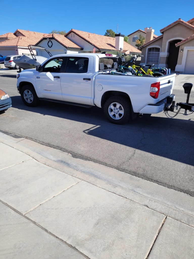

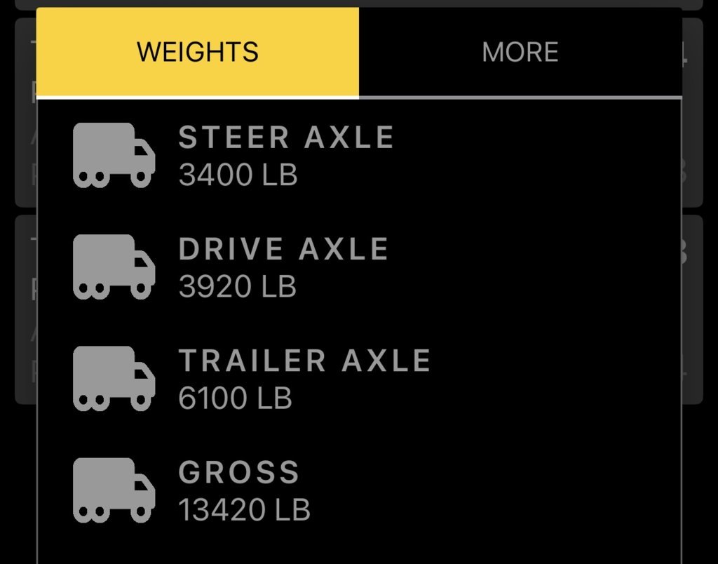

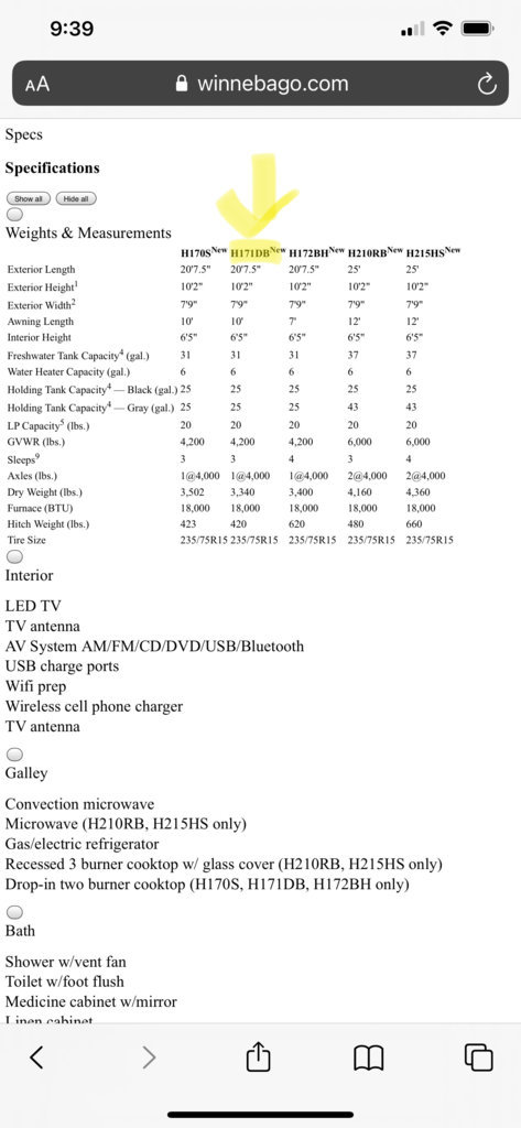

    Hit the scales on the way out and not to pretty. Will reconfig prior to homebound by adding some items from truck to back of camper and hit scales again. Trying to avoid dicking around with a WDH.

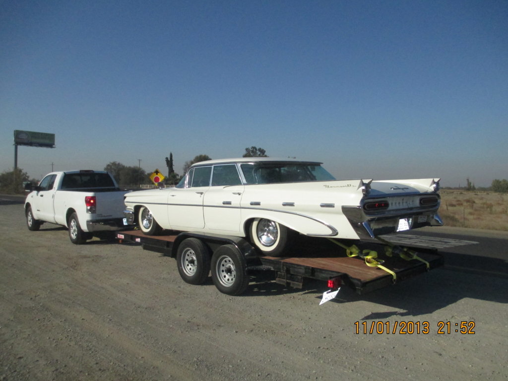

    4800 pound car. I have retrieved cars from Idaho, Oregon and So Cal among others and driven right, they pull just fine. I am not pulling D9's or anything,IMG_9843.jpg any fullsize would struggle with that kind of weight

    Mr.Lifer, what is that spaceship?! Cars of the past were wild!

    1959 Pontiac Bonneville all 222 inches of her!

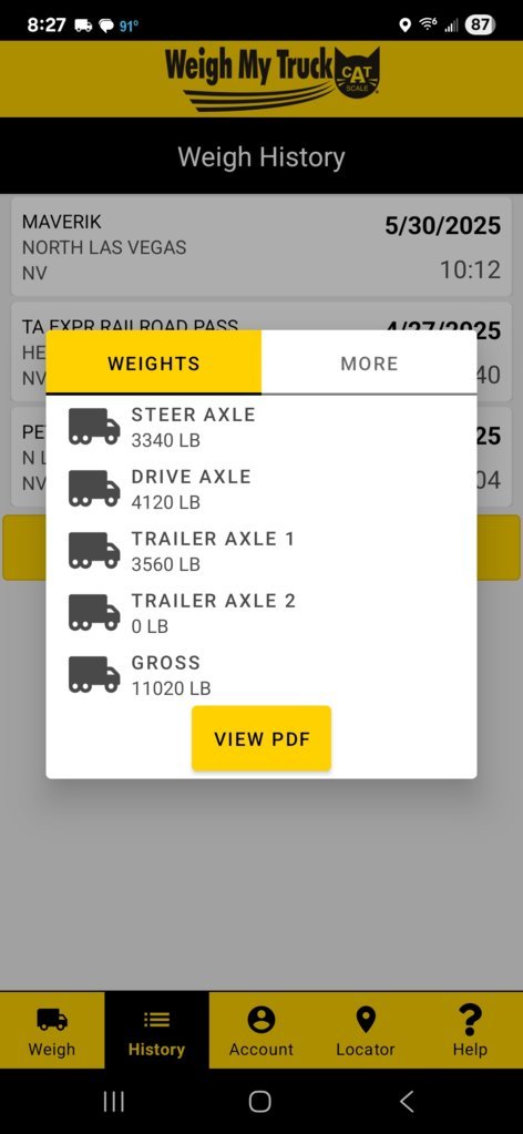

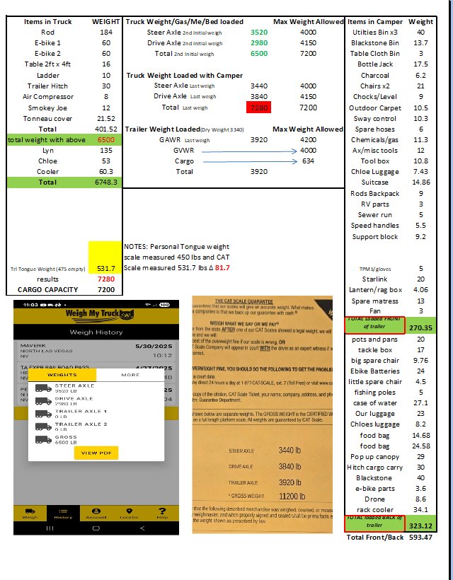

    I kinda wish we still had our 1st gen Tacoma to use as a support truck.:)

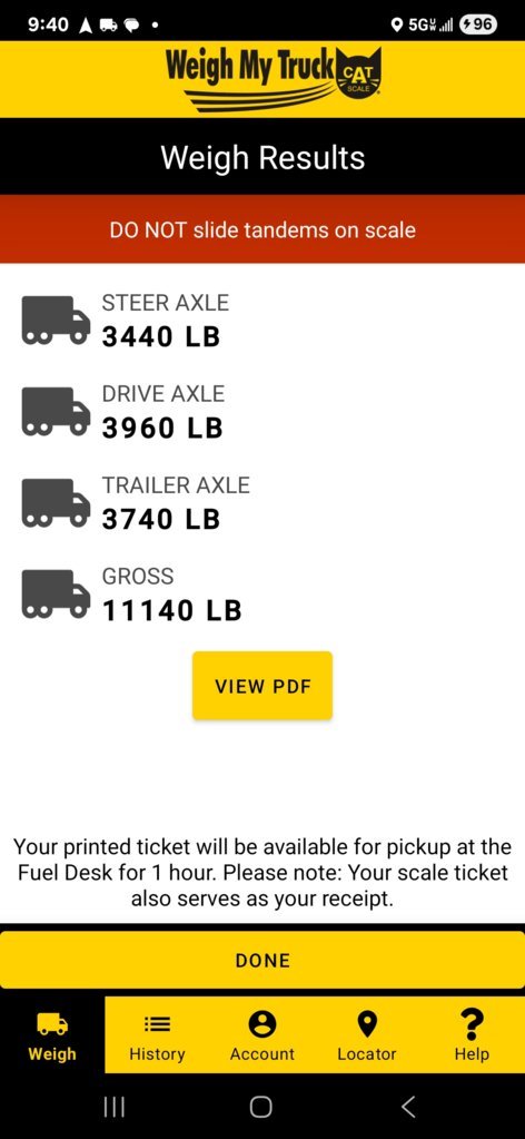

    Nonetheless, moved Firewood and Coolers to back of camper on the way home and made small gains. Still didn't remove unnecessary gear from camper forward cargo bay but that's less then around 80lbs.

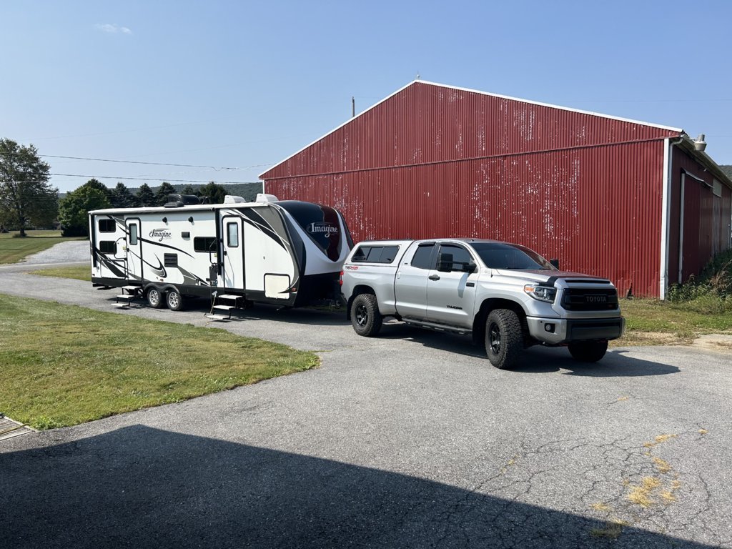

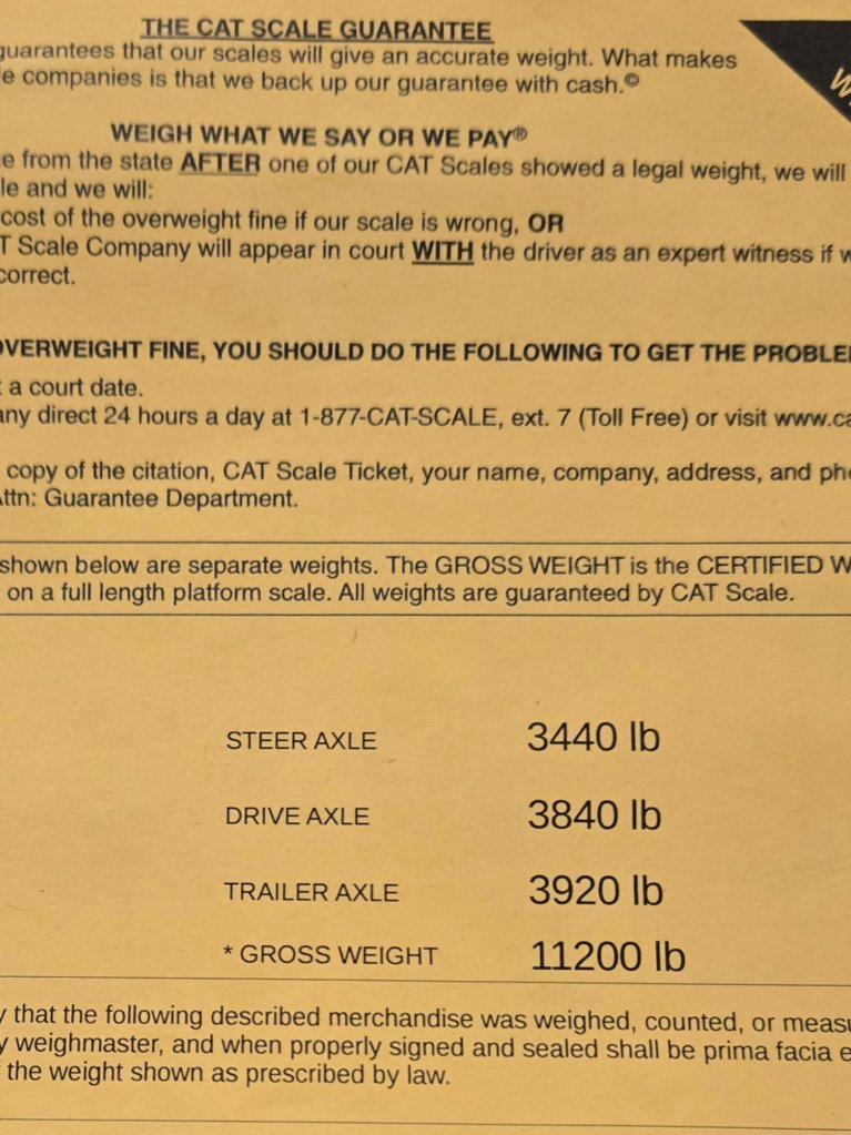

    Here’s my cat scale slip with my GD 2800BH hooked up. 32’ total length, truck weighs 6560ish on its own, and the trailer when hooked up as it sat at the time was 6880. Not fully loaded as if going on a trip. This is with a weighsafe WDH, and before I set up the bars it was showing 850# tongue weight. It’s a much larger trailer, but the numbers look even a hair better than yours without a WDH. You can see how the WDH really transfers the weight from the tongue to the front truck axle and the trailer axles looking at the big picture. upload_2025-4-27_20-35-45.jpg

    Lordy that's a beautiful Pontiac! They just don't make em like they used too. I kind of miss the older Pontiac brand at large, especially the Trans Am. I bet Burt Reynolds is saying the same.

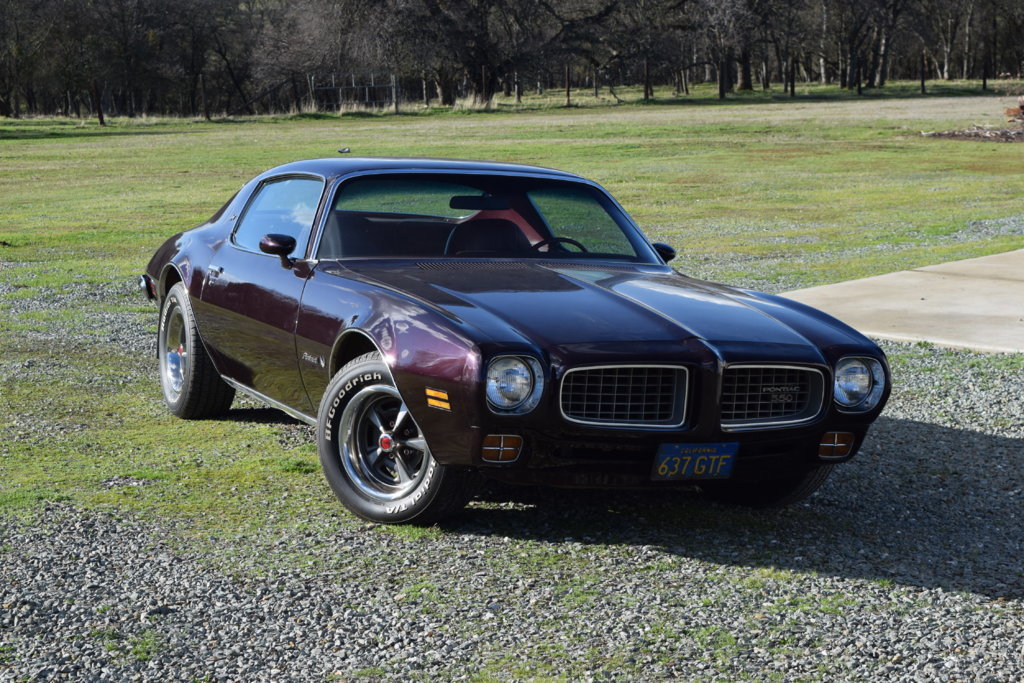

    Thank you! I have a 73 Firebird too that is a slug by my standards but handles amazing for a 52 year old car. I DO miss the Pontiac brand for sure.DSC_0395.jpg
