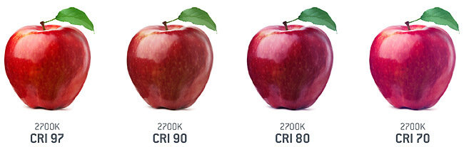

    Dark ages? The quality of the light is far better from halogens. Go look up the CRI of your LEDs, it will not be 100. All of the lights I have listed have a CRI of 100. Lumens are lumens whether they come from an LED or not. I bet your phone has a blue light filter. This is because the blue light from the LEDs in your phone mess with your brain and effect your sleep. Blue light is much worse for your night vision. Finally go look at all the videos out there with LED headlights. They all flicker. Whether this effects you are not is up for debate but all LEDs that I am aware of use some sort of PWM to regulate them. I have put together a lot of horticulture LED systems for miicrogreens, LED's have their place, that place is just not in my non retrofit halogen headlight housing. When it comes to trash look at how waste full that burned out LED headlight system is. There is way less going on in that halogen lamp.

    I am not speaking or defending Johnsonman as he can do that for himself.
    1) Your link you posted on LED’s blinding is outdated. See cups pics above.
    2) LED’s with higher CRI Index are becoming more common place.
    3) That Taco link about putting in higher watt halogen bulbs into the reverse lights assys sounded cool so I looked into it. Stock lamps take up 3Amps. Taco Guys adds in new ones that take up 5Amps (plus 2 over stock). Total circuit in his case was 10Amps. Possible danger, but probably ok? I’ve read too much about wire harness burn ups on these higher watt bulbs/set ups to stay away from them.
    4) Stock Halogen Bulbs suck. I’ve tried new Sylvanias and they do not cut the mustard.
    5) Significantly Lower Amp Draws on LED Bulbs make your engine run smooovv!
    6) Looking forward to the next generation of LED Projectors. Those Morimoto ones have some nice light. They do require a harness only to convert from 9006 plugs. Instant on versus delayed HID. When I turn on the light I want it right away.
