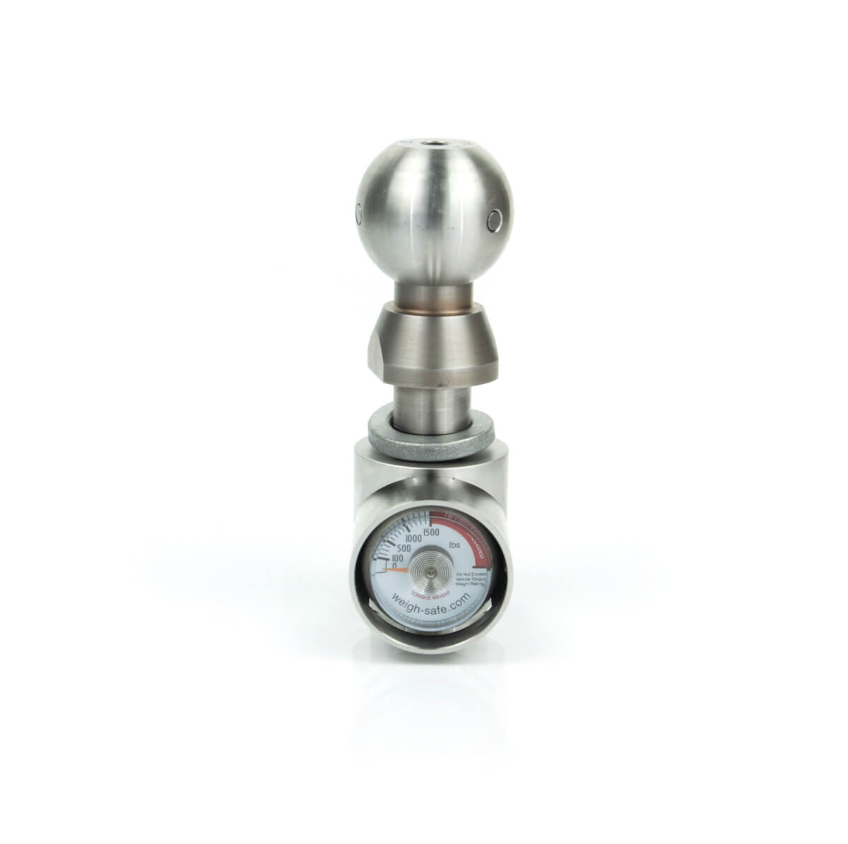

    I recently came across an article by a company that manufactures towing products/accessories that I found informative, I'm in no way endorsing/promoting their stuff.
    https://www.weigh-safe.com/towing-safety/definitive-guide-to-safe-towing/
    That being said, I'm now interested in their universal tow ball so I can easily determine tongue weight when I pull a trailer.
    Tundra2 likes this.

    That ball could be really handy if you carry a lot of different weight loads and want to use different bars for each. I wish I could rent something like that for a day.

    I have a weighsafe trailer ball. It works great for properly loading my tractor on my trailer or loading my dump trailer.
    Lil Steve and onesojourner[OP] like this.

    That actually makes a ton of since for loading stuff like that. I might look into one of those.

    I found mine on CL for $50.
    It has been pretty handy for sure!

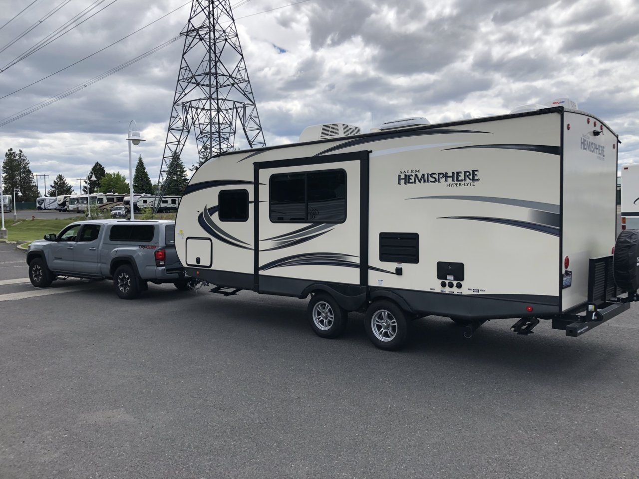

    Heading out on a couple day trip.
