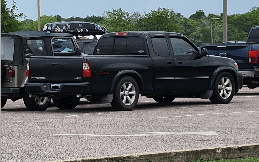

    How she looks now
    Bought this truck for $2800 about 5 years ago, with 330k miles.
    It needed a lot of little things and a few big things. But had a solid foundation.
    First it needed an alternator, ignition coil, windshield was leaking, most the dash lights were out, needed new clock spring, the T3 grill was falling off, valve covers were leaking bad, cats bad, AC resistor was bad, etc...
    It took lots of jumps just to get her home.
    First things to go were the ugly bull bar, side steps, air bags, motorcycle hauler thingy in the bed, hot air intake, and altezza tail lights.
    She got some JBA jewelery right before covid and before JBA stopped making em and the price doubled for the same long tubes design, now made by a different vendor.
    PO had installed like an AutoZone special hot air intake and removed the fender liner, the the tire was pitching debris at the filter.
    Hot air intake replaced with a Volant intake.
