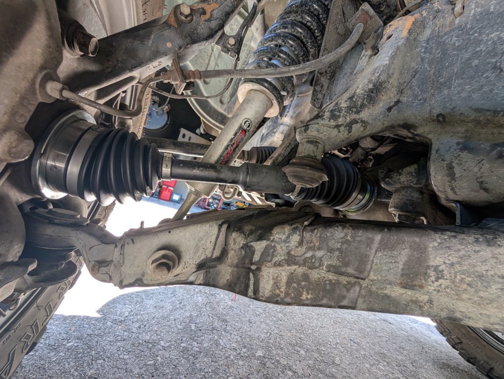

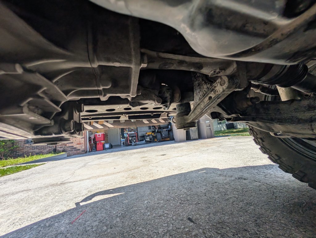

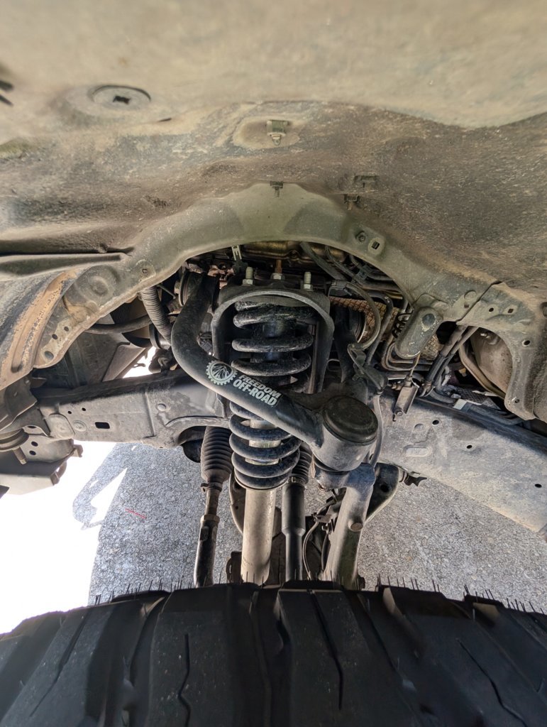

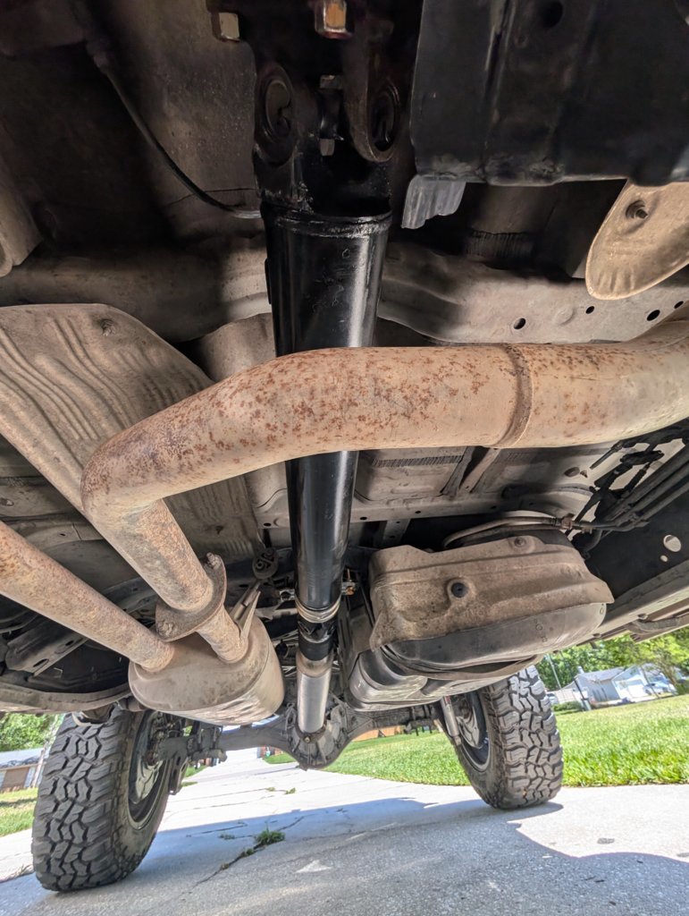

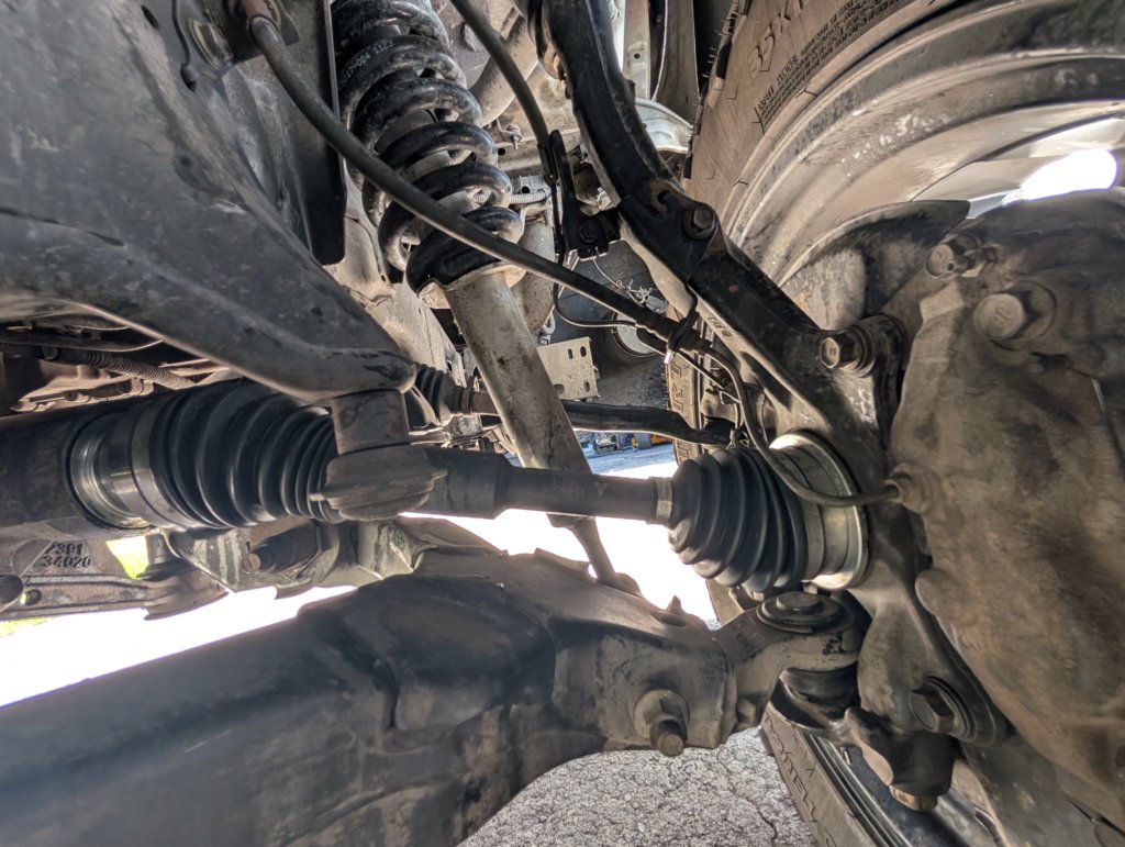

    I've got it too. Lol 2012 tundra, 5.7, ext cab 4wd. 35/12.50 20. MT's. Diff drop. Freedom off road upper ca'a for 0 to 4in lift
    Just had driveshaft rebuilt and then balanced. Have an aftermarket shaft that I tried and it does the same thing. New bearings,seals and shaft axles in rear end. New extended CV axles up front. Brakes good, rebalanced tires, changed all fluids_ differentials, and tranny. Tranny was bad. On 2nd drain and fill. It seems to happen and more prevalent in higher gears, like 5/6th. Almost like a motor mount issue. 2in block in rear, 3.5 rough country struts up front. It's stiff I know. Just removed away bar today and the front rides so much better. It hit little bumps hard but was great on dips. Read on another forum/post hear about the bar. It lets the front work independent so shocks are felt across the whole front end by hitting a hole or whatever on just one side. Got a new tire in yesterday that will have put on Monday. One of my tires is chopped up from it digging into rear of front fender well. Previous owner cut out wells some and there was some sharp steel sticking out. I'm thinking transmission issue. I'll update with any new finding.
    Just went through 2yrs on no 4wd. I adjusted actuator motors quite a few and couldn't get it to engage. Welp, finally got the 4hi gear in right position and bam! Working now. (Sorry for long post lol).

    Hmm ok. I've had my lower ball joints, upper came with control arms,tie rods end and new steering rack and pump. Next is definitely new leaf springs. Mine are shot.
