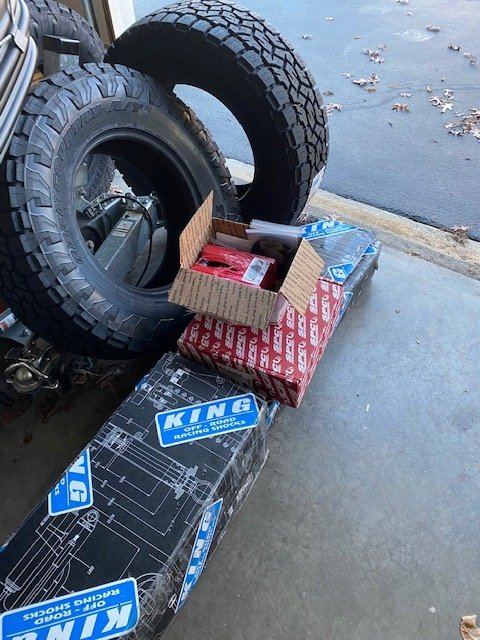

    Tomorrow is the big day to start the great refresh. My local off-road shop is installing:
    • King 2.5 with remote reservoirs all around with 3" in the front. These were tuned by Accutune with the "Adventure" tune.
    • SPC UCA
    • Coachbuilder +3 shackles for a +1.75" in the rear
    • TOYO Open Country ATIII 285/70R18
    Bumper and lights come in this week as well.

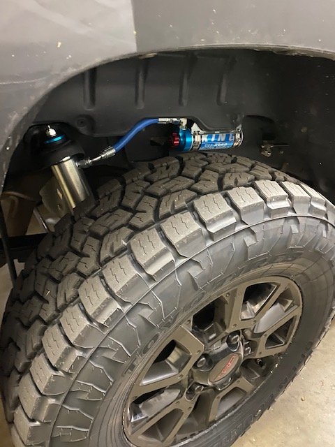

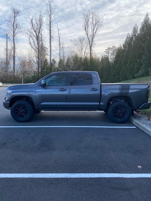

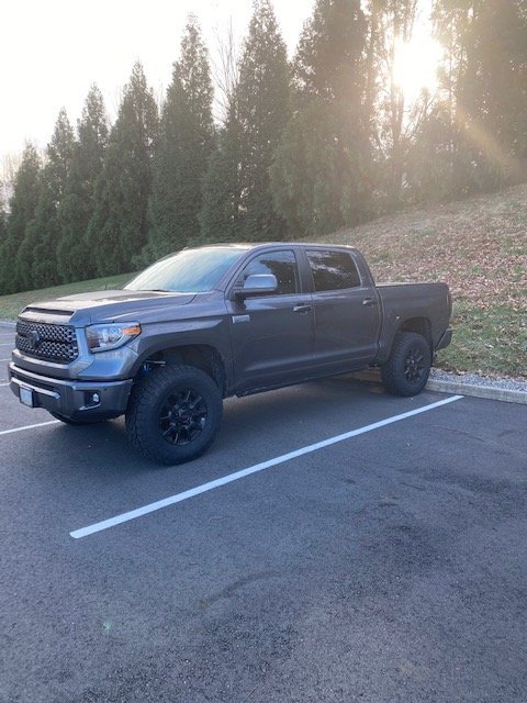

    Ok, first phase of the Great Refresh is complete.
    • King 2.5 with remote reservoir coilovers . Coilovers adjusted 2 turns more than factory showing 10 threads above the collar. 2 CB shims driver side, 1 passenger side
    • King 2.5 with remote reservoir shocks in rear
    • CB +3 shackles
    • SPC UCA
    • TOYTO atIII 295/70R18
    I was aiming for a 3/1.75 lift but measurements show that I actually gained close to a 4/2 lift.
    The ride is a night and day difference from the old 6112/5160 setup. So much smoother.
    Also, the installation took the shop longer because they said removing the factory rear spring bushing for the CB shackles was an absolute nightmare.

  13. Dec 9, 2020 at 9:01 AM
    HulkSmurf14
    Aug 9, 2019
    #34377
    2,608
    2014 Tundra Limited
    Tastefully enhanced...
    Looks incredible and I can only imagine how smooth it must be! Well done sir! Your refreshes are solid showings!

    Sean492
    Sean492 New Member
    Jul 15, 2019
    #33254
    317
    Sean
    Winston Salem, NC
    2018 MGM Tundra Sport
    Truck looks great. The stance is spot on and the black stripe works! Great job representing the MGM crew

    Thank you... I agree that the spacers align the 295s just right with the +60 offset of the Pro wheels. Gives it a more appropriate +28 offset.
