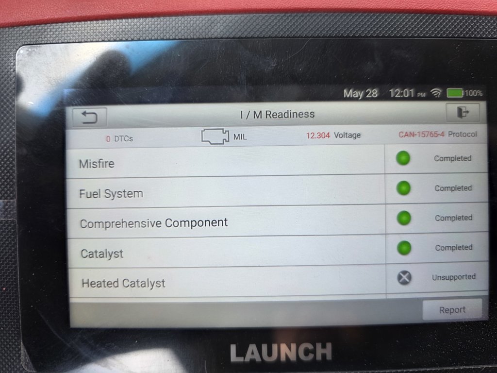

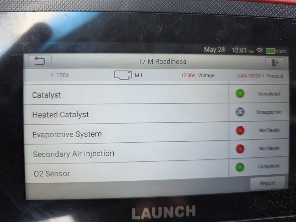

    Oddly, and for the first time ever. No CELs have returned since clearing. Its been over 100 miles. Not only that, all readiness monitors have compelte except for two. Thats a first. Just waiting for secondary and and EVAP.

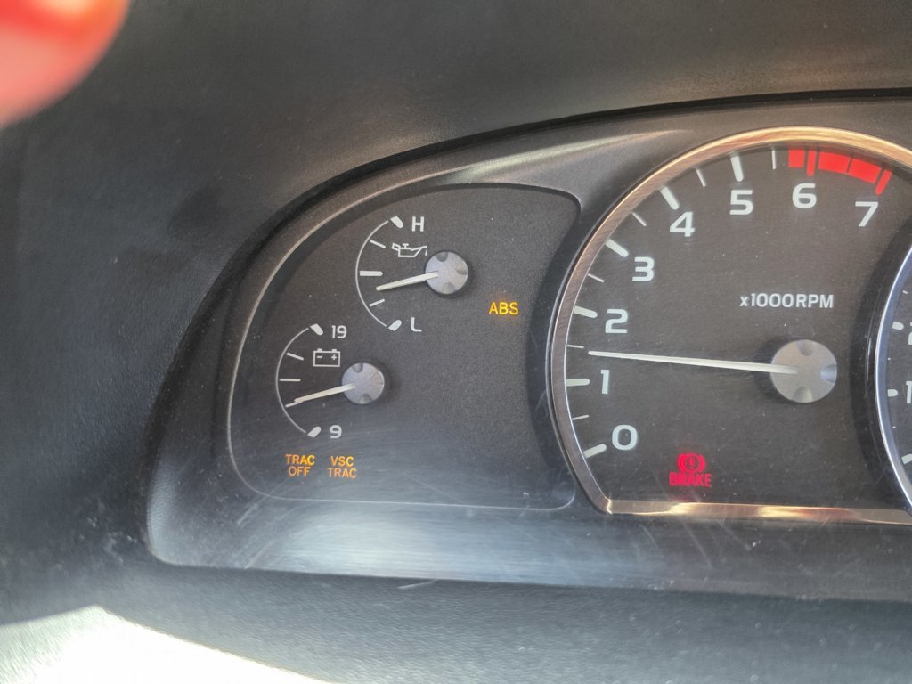

    Now how to get rid of those pesky ABS VSC and TRAC lights. No ABS codes are displayed on my reader
