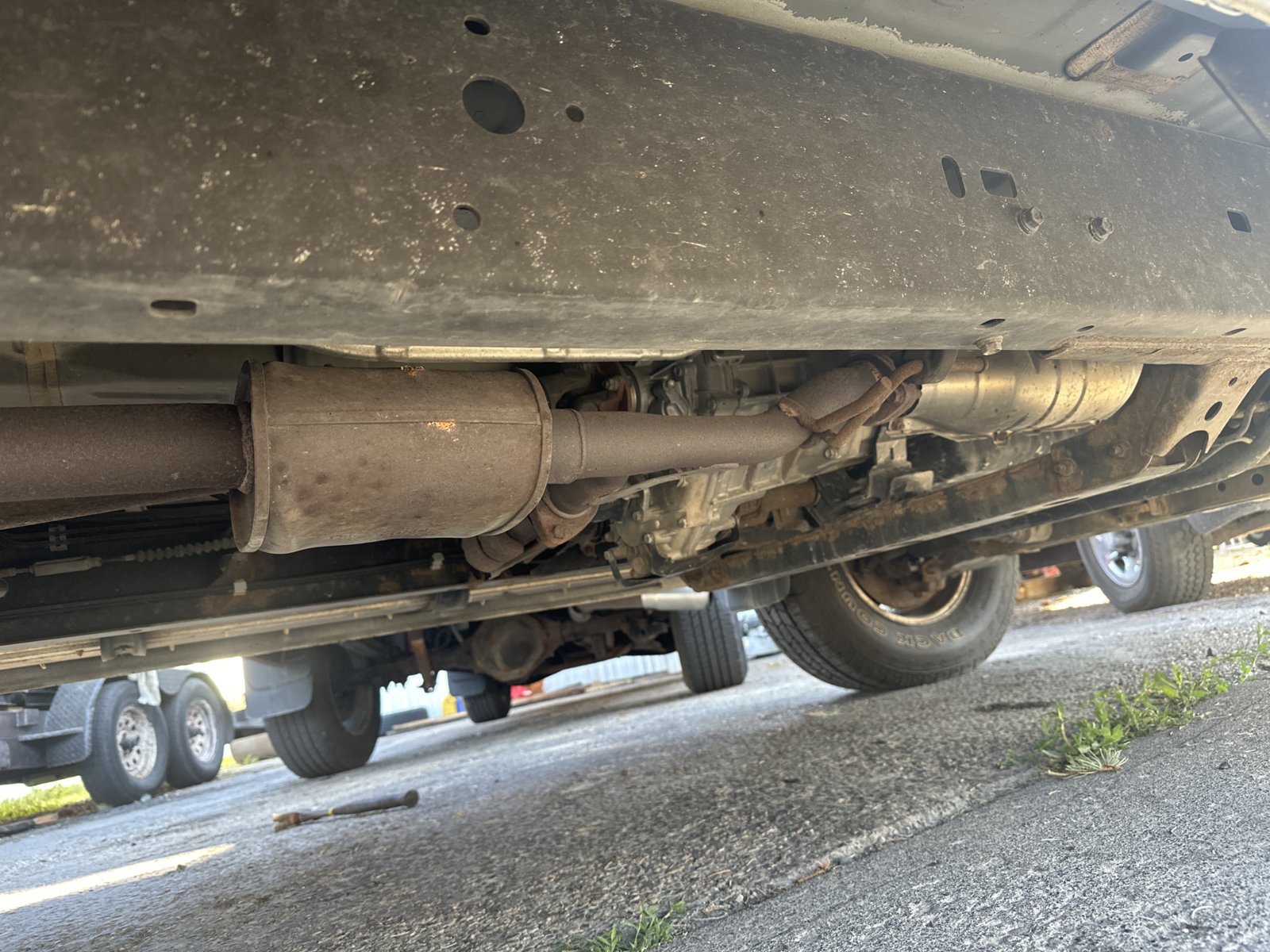

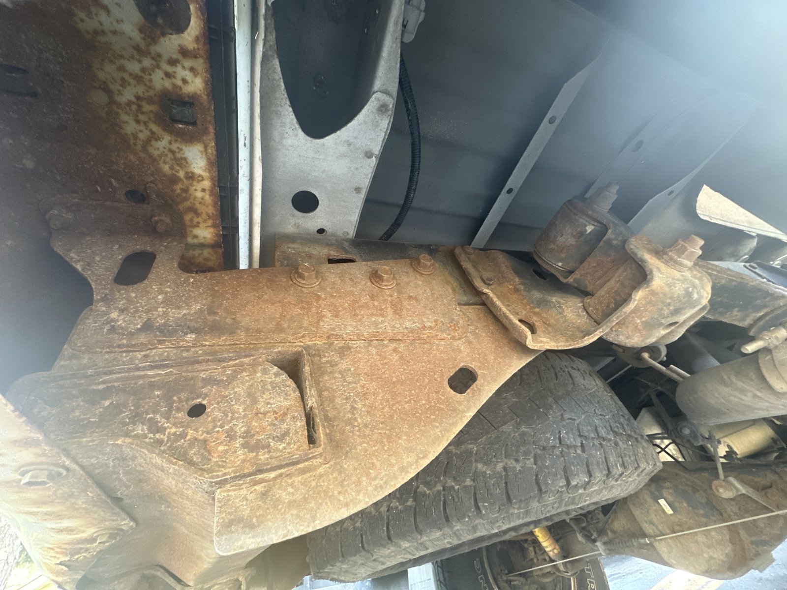

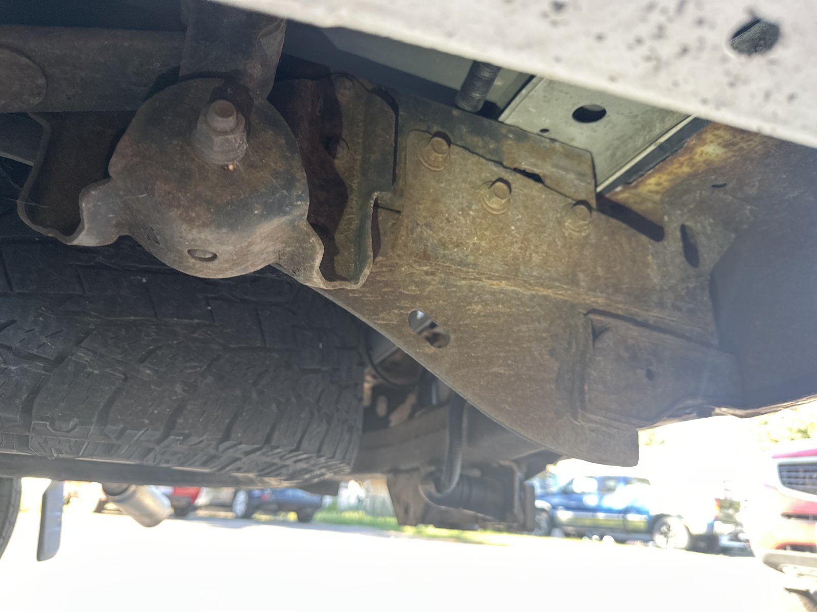

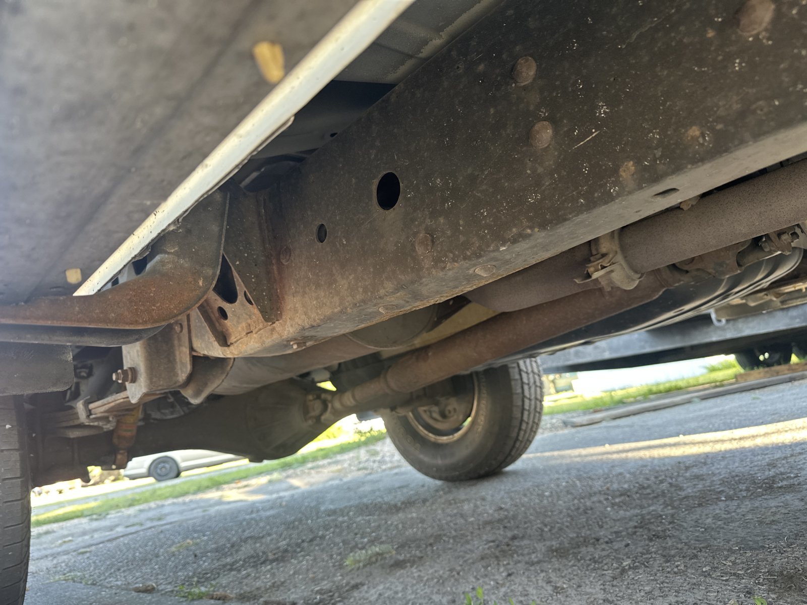

    Here are some more photos, I’ve been tapping around with a hammer and it’s not rusted through in any spots but it does have a fair bit of rust

    Not as bad as you think. You can pull the hitch/rear bumper reinforcement and restore that with a wire wheel and some POR-15 or just buy another one in better shape.
    The last pic area with the sway bar support I would definitely clean that up with a wire brush and put a rust protector on it.
    The rear bumper isn’t worth restoring. Best to just buy a new aftermarket when it rusts through.

    Ignore the tow hitch stuff. Mine is rusty, and it’s never left the south, much less seen any noteworthy amounts of salt. We’ve had members from Cali have their factory tow hitch rust to bits. It’s a poor design. I really don’t feel like that truck is awful. It’s more than I’d like to have on my truck, but it’s nothing that’s require extensive work to reverse, definitely shouldn’t require welding. It’s your money. I’d potentially wait out for something cleaner BUT that is really not THAT bad at the price point of $8k

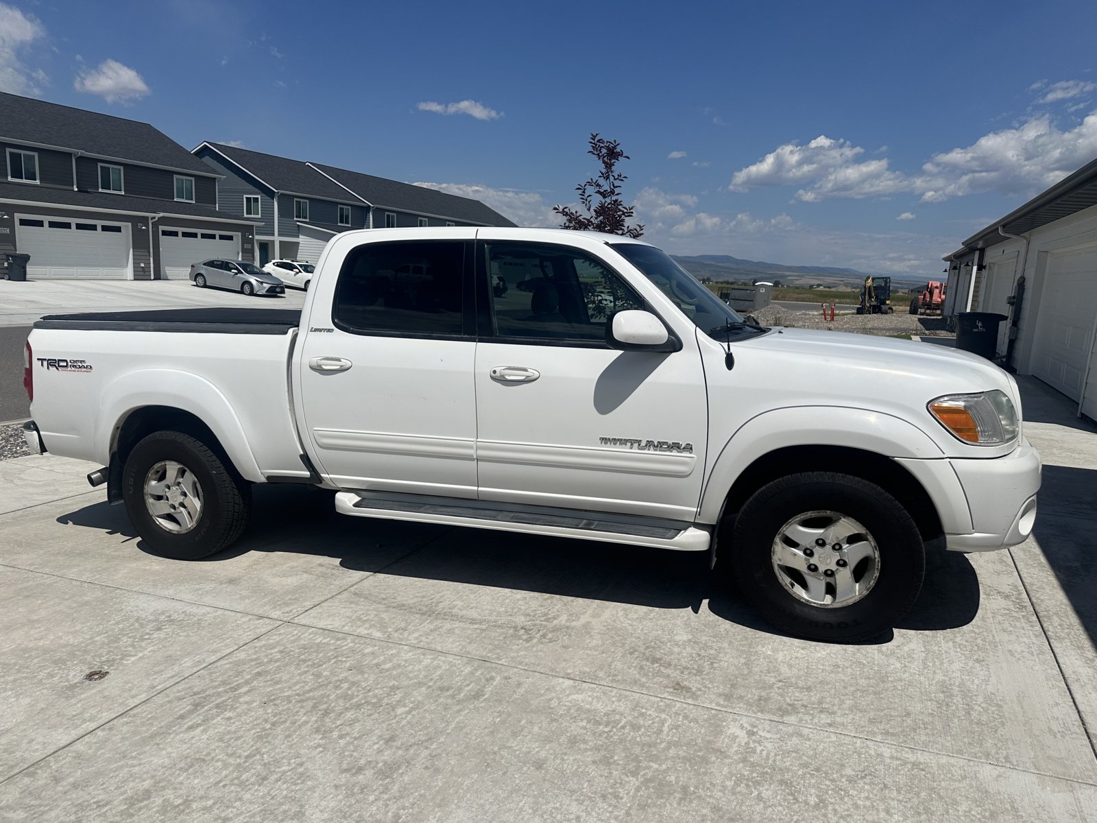

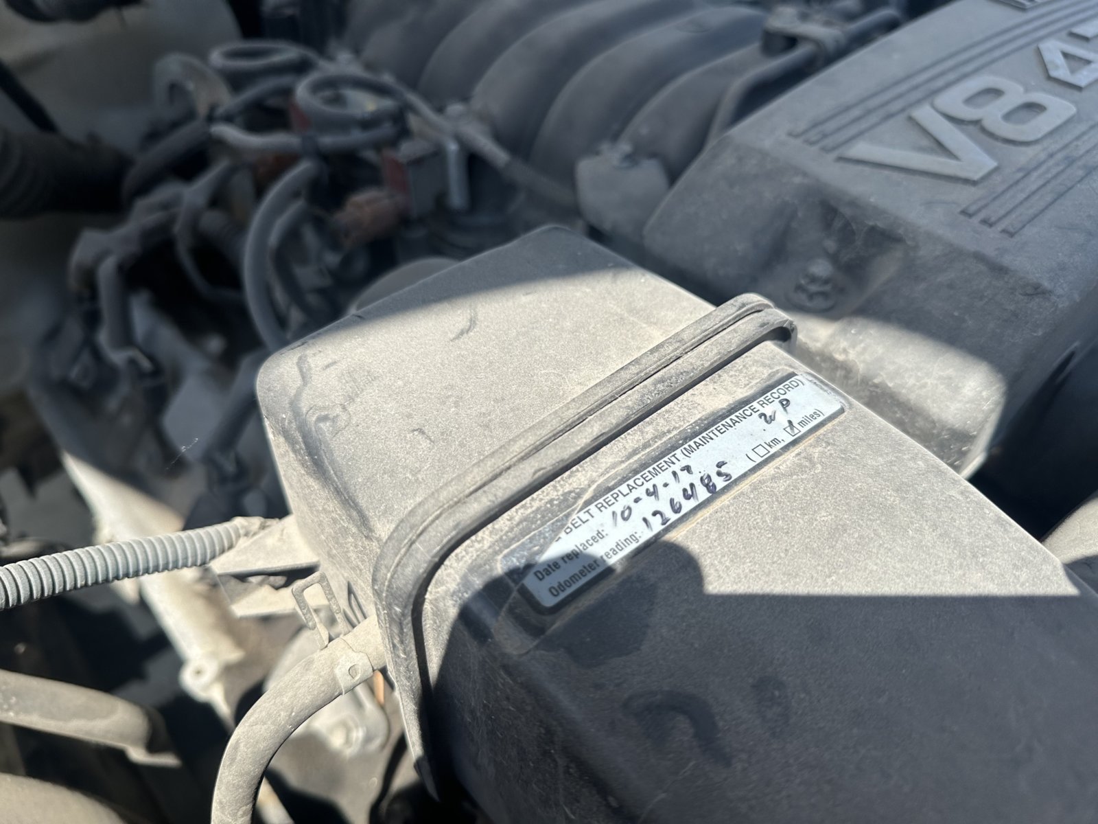

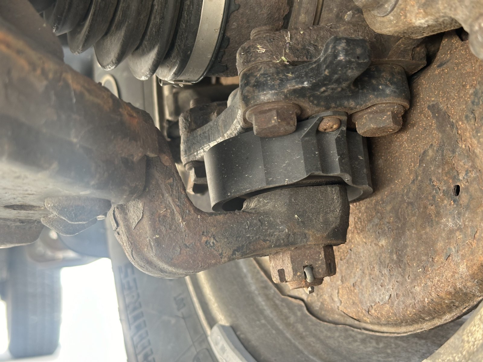

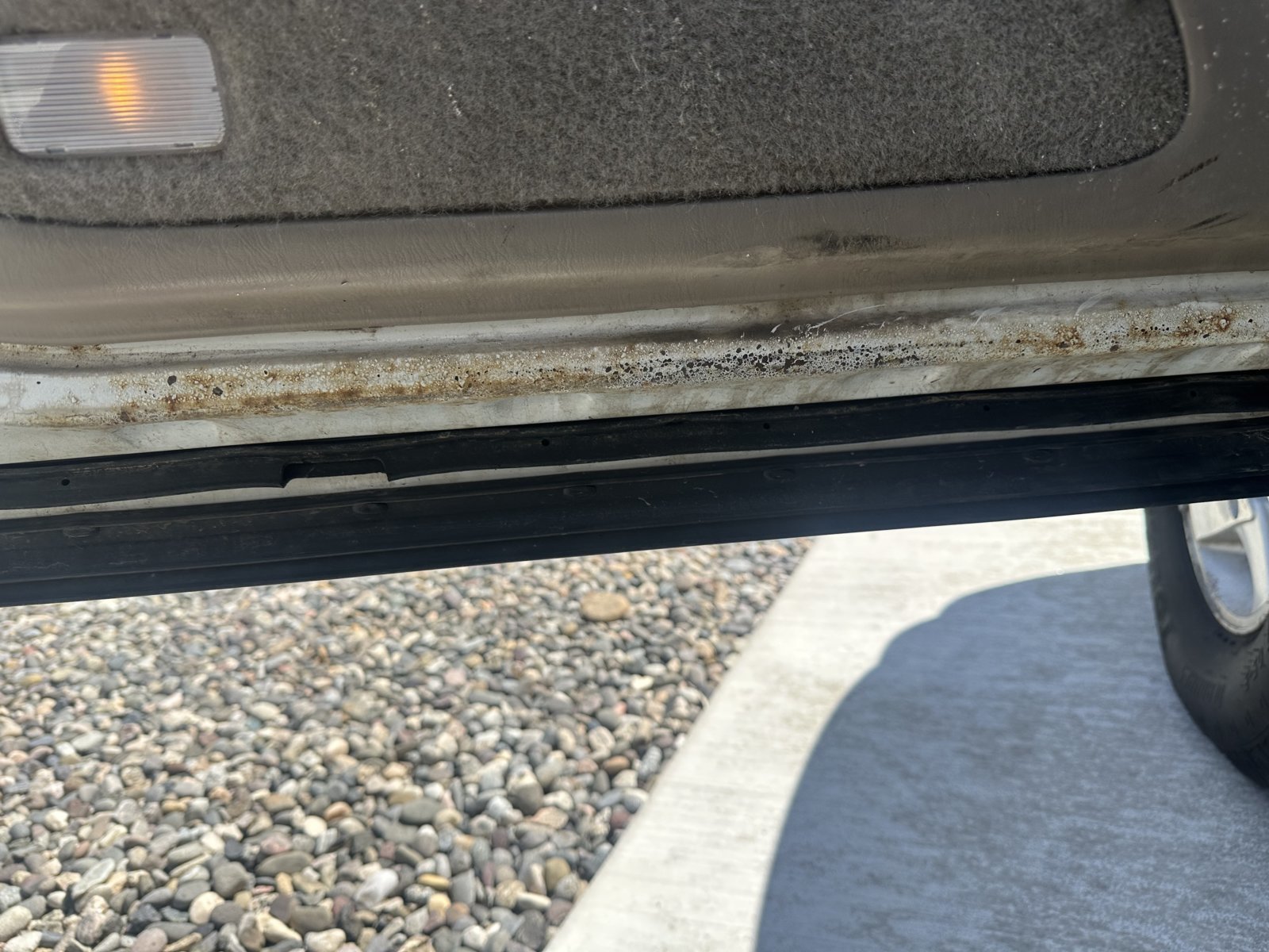

    OK, so I ended up buying the truck last night and drove it the 200 miles home. I now own a 2006 DC 4 x 4 limited I ended up paying $7700 for the truck. Here are a few photos, as well as a question or two.

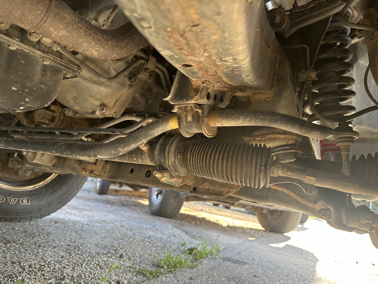

    OK, now for a couple questions the lower ball joints look to be original to me? Do I need to replace them?

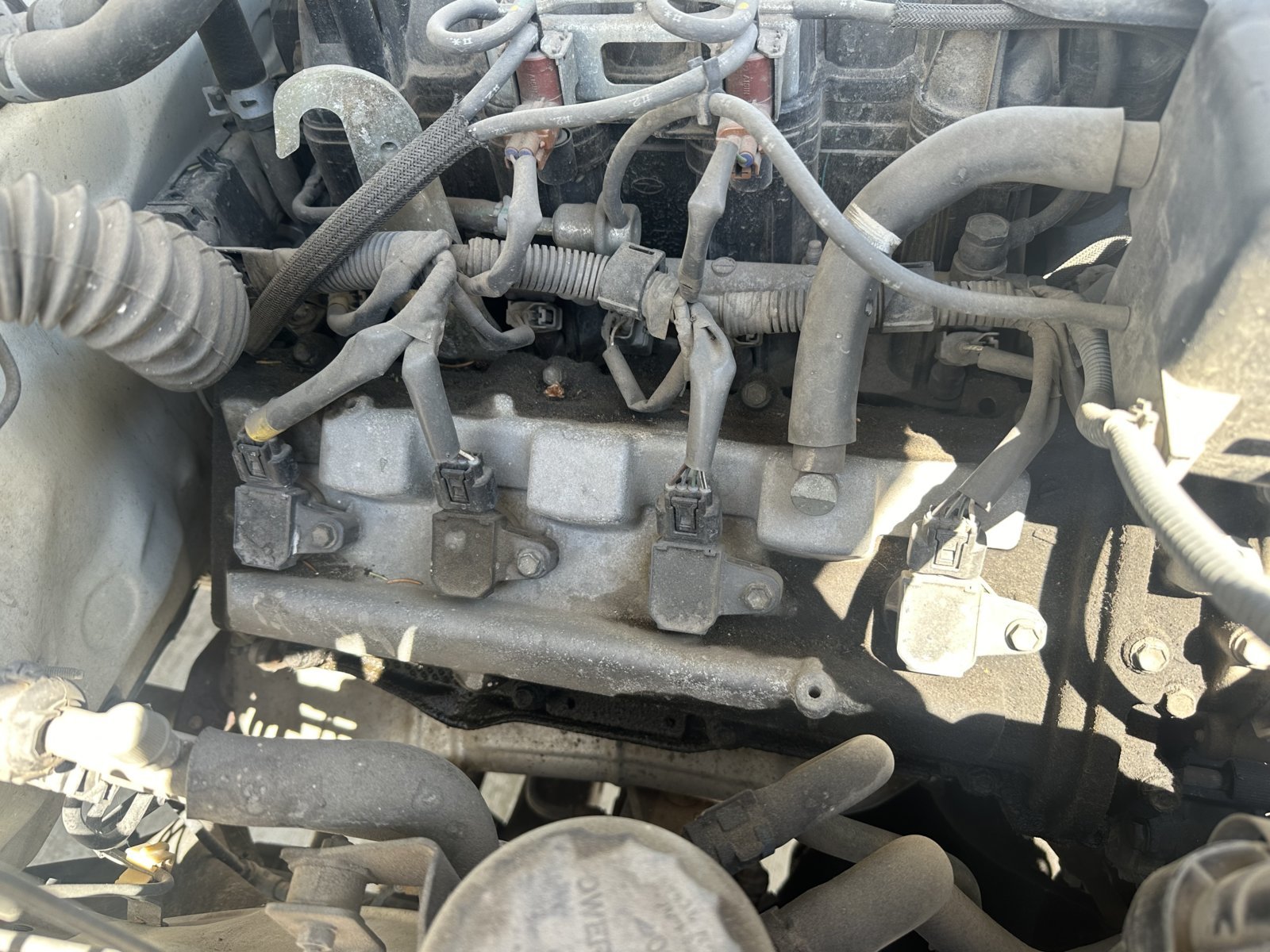

    it looks like the valve covers are leaking a bit? Should I just replace those gaskets when I replace the timing belt?IMG_6435.jpg IMG_6434.jpg
    The timing belt looks to be replaced about 100,000 miles ago and five years ago. My thoughts are that rubber usually rock so that’s less concerning than a 20 year-old belt? Obviously, I still wanna change it soon
    Kimosabe, Riverdale21 and w666 like this.

    I would just replace the LBJs and bolts and be done with any concern over it. The door you should pop the bottom seal off and see how it looks underneath. Also do the same for the inside of the door. If it’s rusting from the inside you’d want to know if anything to the outside will last. Otherwise, I’d just say sand it, prime it and paint it.

    Yep exactly.
    Read FAQ, go through truck slowly and methodically and you'll know what to replace/deal with. The pics seem to present a truck that is very much "savable" in terms of rust - so perhaps if you're willing to put the work in to clean/coat areas as you go it'll be worth the time investment. Even with lack of maintenance and the mileage/condition/strange ass early sequoia looking wheels - it seems like you got a pretty good deal there!
    Congrats, welcome and prepare to dump a bunch into it and bring her up to snuff.

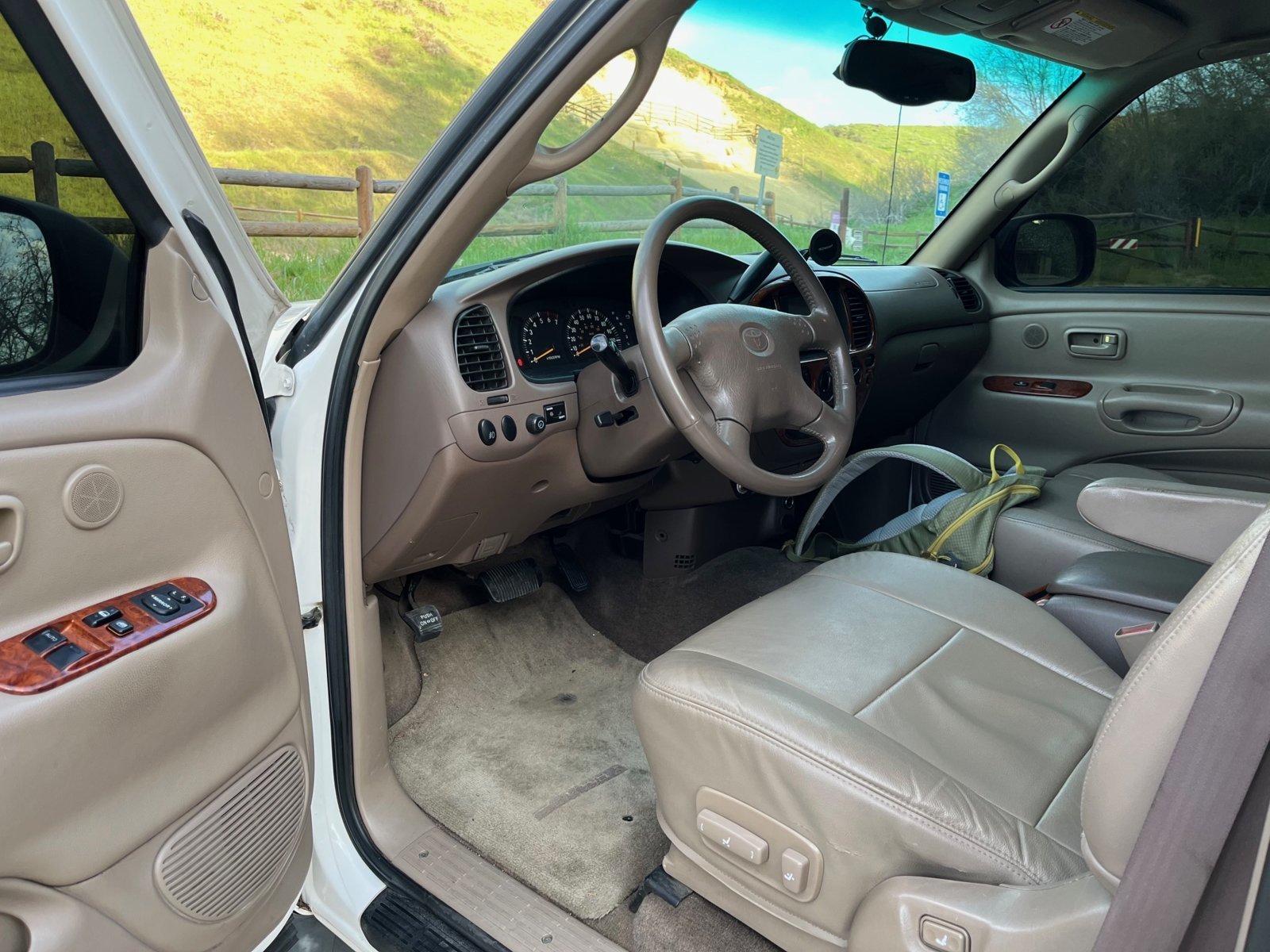

    I had a WTF moment when I saw the drivers seat. Every leather seat Tundra I have ever seen came apart by 180K miles. Must have been a small driver and long trips rather than in and out with fatass a dozen times a day.

    Mine is similar. Pretty mint leather on the driver seat. You're probably right. Original owner was probably a similar build to me. Average height but on the skinny side. Bought at 225,000 miles.
