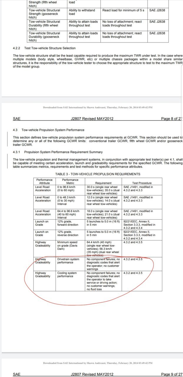

    Toyota contacting them to edit has been 100% verified to be true and accurate?

    Then the SAE J2807 test would be considered useless as well.

    Not sure how you concluded from my statement---which is regarding TFL testing not comparing the Tundra to the previous externally cooled transmission variants, or lack of vehicle telemetry, or lack of stating vehicle settings, let alone lack of long term survivability of the transmission (albeit hard to test, but the main worry of people from what I've read)---that a standardized tow test is useless?
    Their conclusion is transmission "only" hit 250 degrees so it's fine---that equals me saying towing tests are useless? Okay. If their video is comprehensive enough for you then good for you, or maybe I'm missing the details in the video.

    Bold statement above is one if the criteria in the J2807 test. So if you are stating their (TFL) test to be useless, I'm simply carrying over a comment made into another test standard.
    And my comment was meant to be a question rather than statement, I thought I used a question mark...seems I didnt.

    In that case yes I disagree with that testing standard. I glanced through the J2807 and didn't see anything about safety lights, everything seemed to be braking, acceleration, handling, etc. I didn't see anything in regards to the transmission specifically. Regardless, that seems to be a requirement based on a value that could be arbitrary. Say for instance the transmission is at 399deg and the warning light is set to 400deg for whatever reason (like how the toyota light is 300deg which seems insanely high, but I'm not a transmission engineer). So your tranny light hasn't come on but you're absolutely cooking everything and it wouldn't last for 50 miles at that temperature but the rear covers it for 10 miles up a grade. That doesn't seem right, and based on the bolded statement sounds like a basis for that test?
    Whether the new tundra needs a trans cooler is an entirely separate discussion, but when a video is titled to answer that question and there is no direct comparison to anything valid that puts that reviewer in question (and don't get me started on their off-road "tests" lol).
    And to wrap up this response, I once pinged the tranny light on my 4runner. Could've been a handful of degrees less and the light wouldn't of come on. For arguments sake let's say that light didn't come on and I let off the gas a minute earlier. That passes that test, that passes TFLs "test", well the fluid was burned to shit and even after replacing it my torque converter went out 2000 miles later. Now obviously that's pretty poor correlation, but is where my viewpoint is coming from. Toyota has a trans cooler for 12(?) years, and showing that the "oh shit you're fucked" light didn't come on so the truck is fine, is not enough to justify removing the cooler. This post wasn't supposed to be this long, just wanted to be thorough :D

    FWIW, the warning light comment.

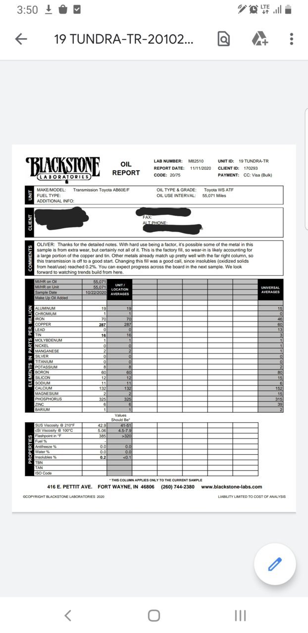

    Also, in the other thread I posted an UOA for WS that was used rather well.

    I'll cross post the UOA

    Cool, now if TFL would've posted that then I would credit them for providing at least something useful :D
