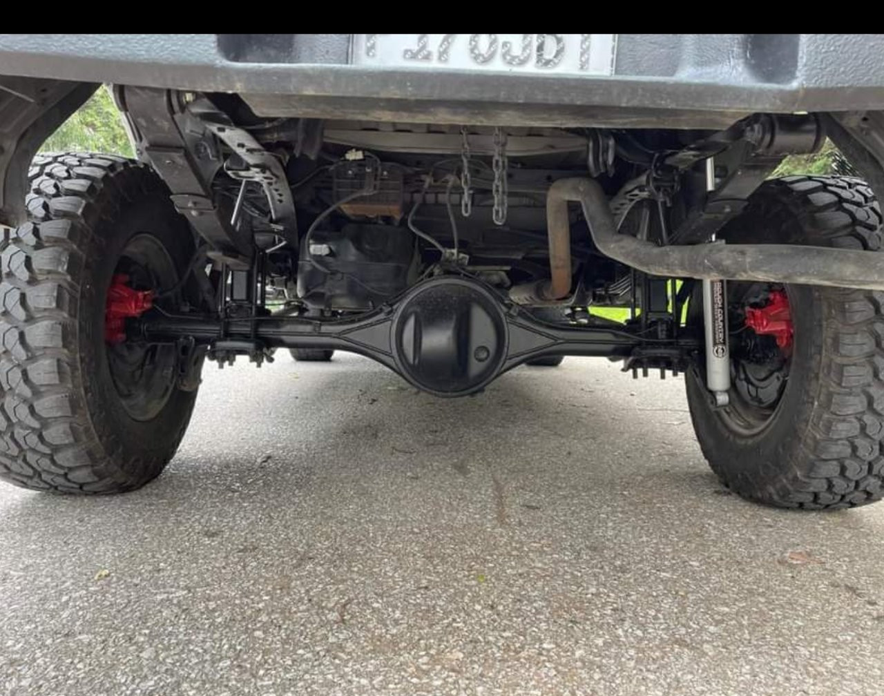

    Saw this 2012 Texas Edition for sale (central america).
    Sorry for the ignorance, but something looks for me strange with the rear suspension of this one. The right shock (image side) looks loose.
    Will be glad for some of your thoughts guys.

    looks like it has 3"(?) lift blocks under the leaf springs. To me, that's a hard pass. Next to a body lift that's my second least favorite way to lift a vehicle. And definitely not the safest, in fact it's one of the cheapest ways.
