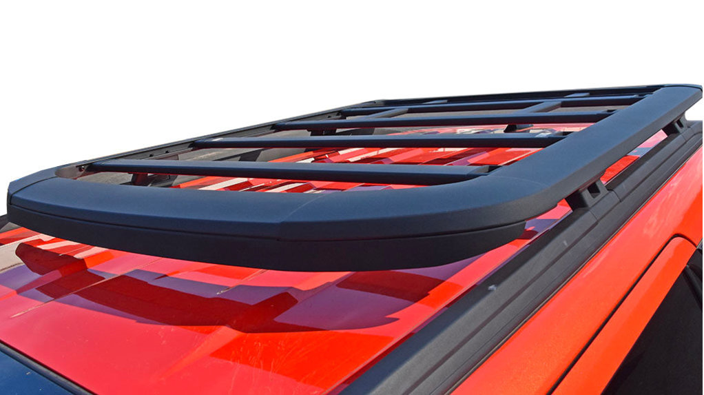

    Not to my knowledge. Some of them came with this lip spoiler on the bottom in the front. Not sure if that makes a difference or not, mine does not have one. Topview.jpg

    My 2023 has the stock roof racks. Noisy from day 1. A friend of mine that works at Toyota told me it is the weld seam for the roof. The sizes are all different because quality control is not there on the new way of doing it. Some trucks/Sequoia's are worse than others, but you can test it by taping (blue painters tape) over the front of the right and left side drains where the rubber boot touches the roof (drain). They used to use a rubber seal on the roofs of Tundra/Sequoia's. Your issue may be different as the mount looks a little different from the photo, but can't see the front attachment.
