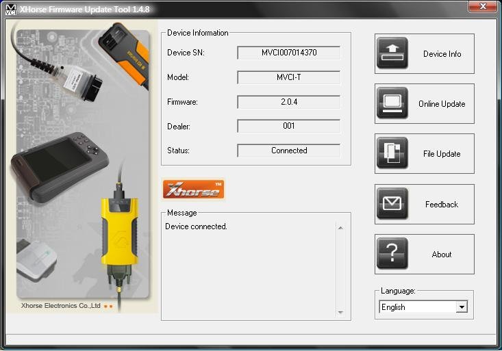

    If you look online you will find Mini VCI cables for sale, that is the cable the majority of people on fourms are using to access TechStream. There are two different cables available, one is cheaper and uses firmware 1.4.1, the other cable which seems to be harder to find now, I got mine on Amazon years ago uses firmware 2.0.4. Apparently the 1.4.1 cable does not allow some functions to work, but it seems vehicle dependant on which functions work or dont. I know so far with my 2.0.4 cable I have been able to program keys, run the brake bleed program, reset thermal degradation, disabled the seatbelt chime, disabled the steering wheel and seat moving on entry and exit. I have no experience with the 1.4.1 cable or the VXDiag cable. The way the process worked for me is I bought the cable on Amazon, the seller then sent me the software and license key. You only need to subscribe to TIS if you want to download updates which I cannot confirm work or not with my cable, the update opens with a program embedded in TechStream called Calibration Update Wizard, the files use an extension of .cuw, I tried it not connected to the truck and it seemed as though it would have worked.
    An informative post

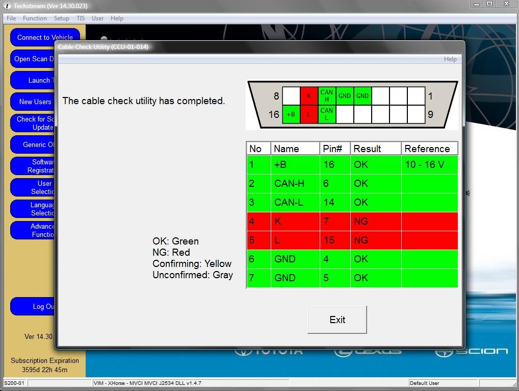

    This thread got me curious about my cable so I hooked it up and under the Xhorse updater it shows that its 2.0.4 but when you open TechStream down the bottom it shows 1.4.7. I ran the DLC3 Cable Utility Check and it fails on K and L lines but passes the rest. Not sure what if anything all this means but so far I haven't had an issues with what I have used the cable for. I believe the K line fail might be because the Tundra uses CAN-H+L? Im not really sure but I seen another guy in a Prius forum that only had K-line working and the CANs failed because the Prius apparently doesn't use them, he said even his actual mongoose cable failed the cans and passed the K just as the mini vci.
    https://priuschat.com/threads/techstream-cannot-read-hv-battery-ecu-data-list.153431/
    Edit: After some further investigation it seems TechStream might display 1.4.6 because that is the driver being used to recognize the cable but since its working I'm not going to mess around with trying to find a 2.0.4 driver unless somewhere here has one that can a confirm it works.
