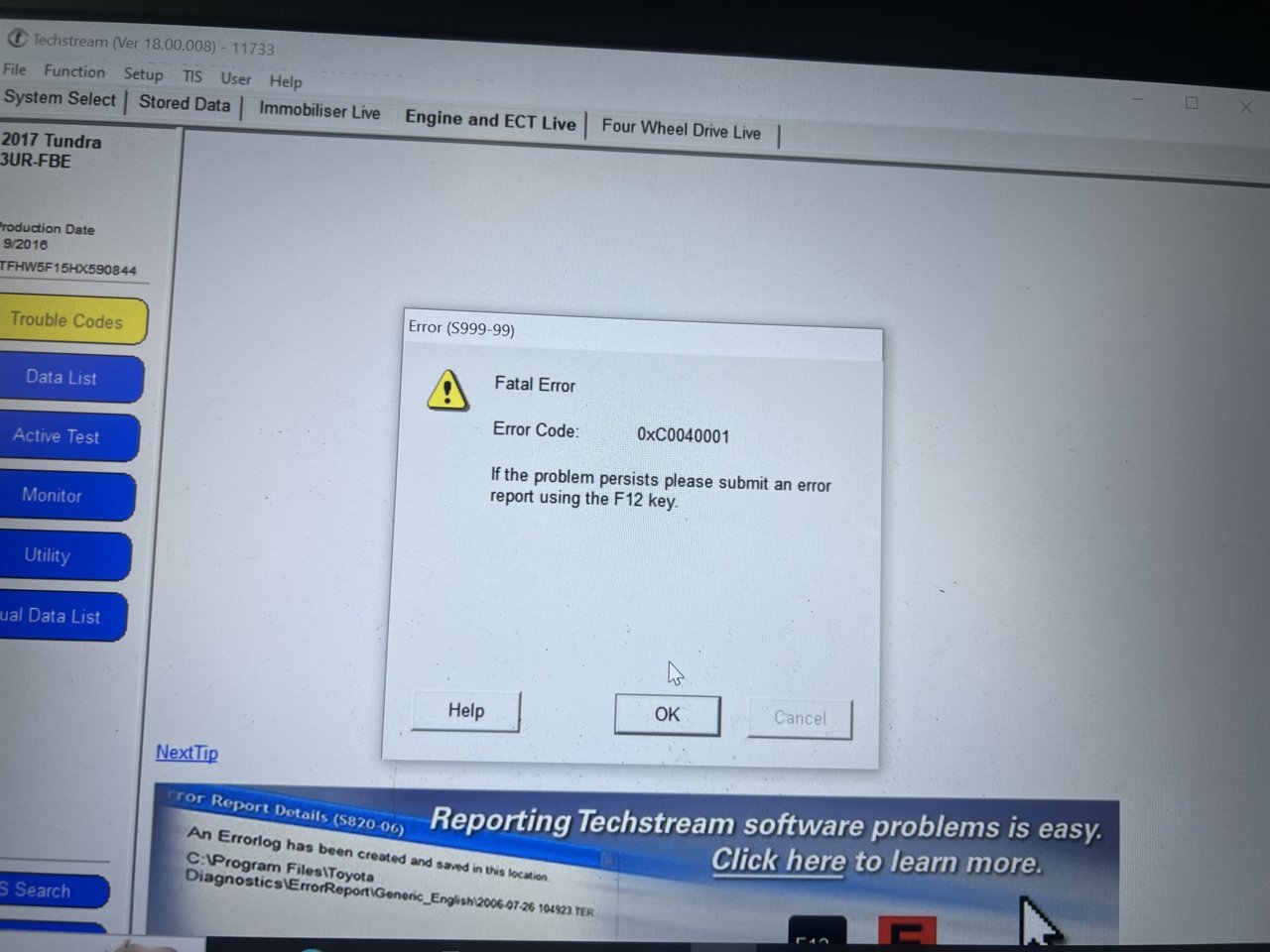

    Looking for anyone with 2.0 firmware to look at engine / ECU data. I have the $50 1.4.8 firmware version but that isn’t letting me access what I’m looking for. $600 is steep for the right cable.

    Seems like they recently made a bunch of changes. I had a 17.x version software and my patch wouldn’t launch anymore saying the software needed to be updated. Updated to a later version of 17.x and had the same issue. Got v18.x loaded this morning and now the patch works and I can connect to the vehicle, access customization options etc, but I get an error code when I try to look at the Engine ECT system. Google says the 1.4 firmware is the problem.

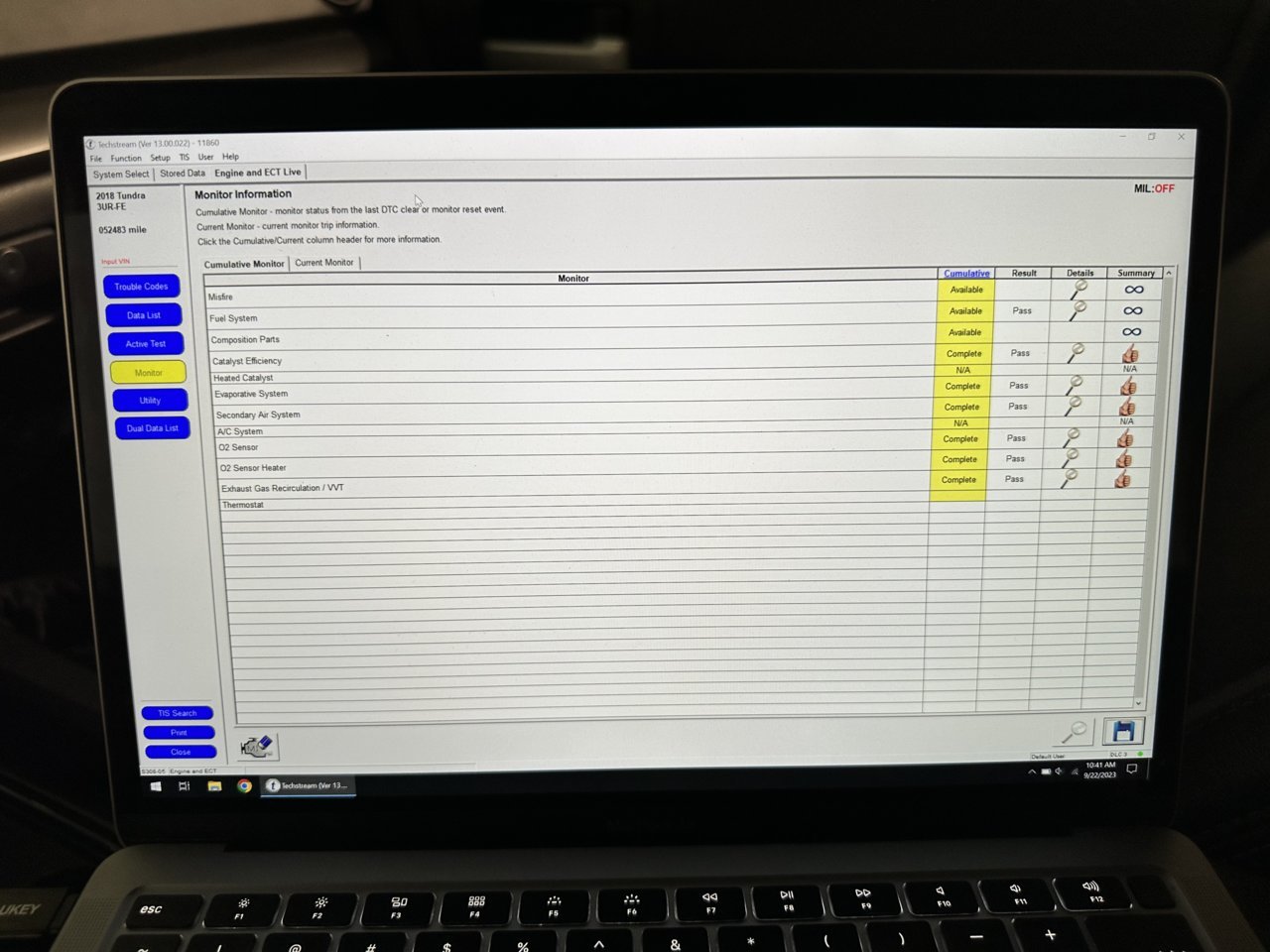

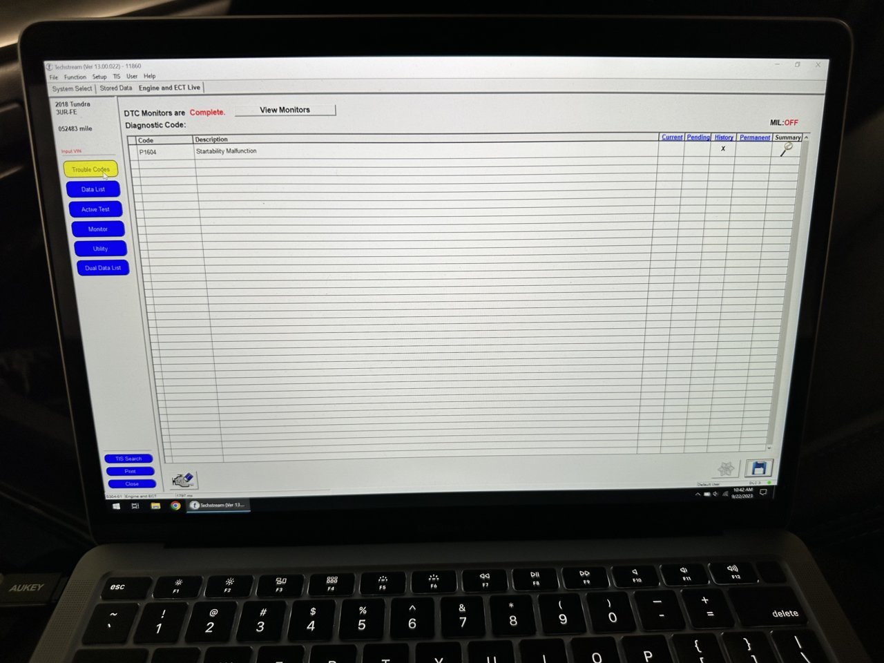

    This what you’re looking for? I’m running a much older version of TS, 13.00.022, but had no problems clicking around in that ECU

    Sure is. WTF...

    I got it. Deleted Techstream and downloaded older v13.x as shown by @TRDFerguson
