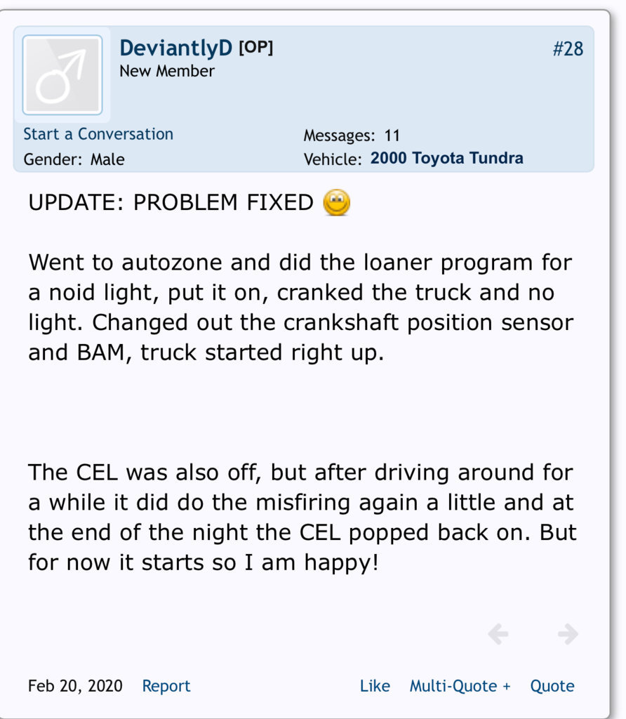

    Man, that stinks! Did you get the crank position sensor/wire tucked back out of the way? If in the wrong spot it could have gotten rubbed through on your test drive....
    jerryallday and Weagle[OP] like this.

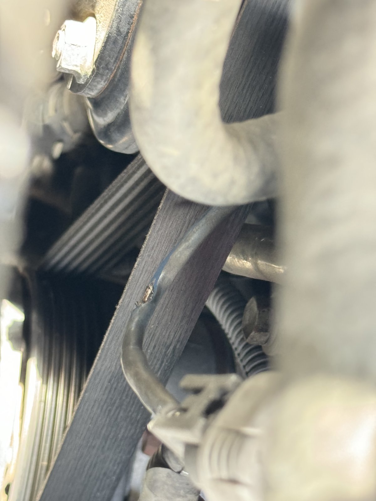

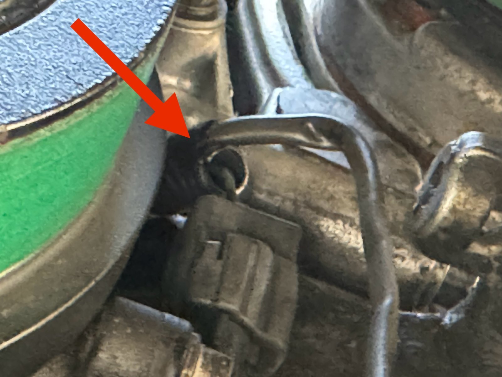

  8. Aug 15, 2024 at 6:50 PM
    jerryallday
    jerryallday New Member
    Jan 4, 2021
    #57084
    1,027
    Jerry
    Pasadena, Ca
    2006 DC SR5 V8 Grey

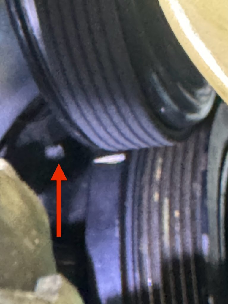

    BroHon and Weagle[QUOTED][OP] like this.

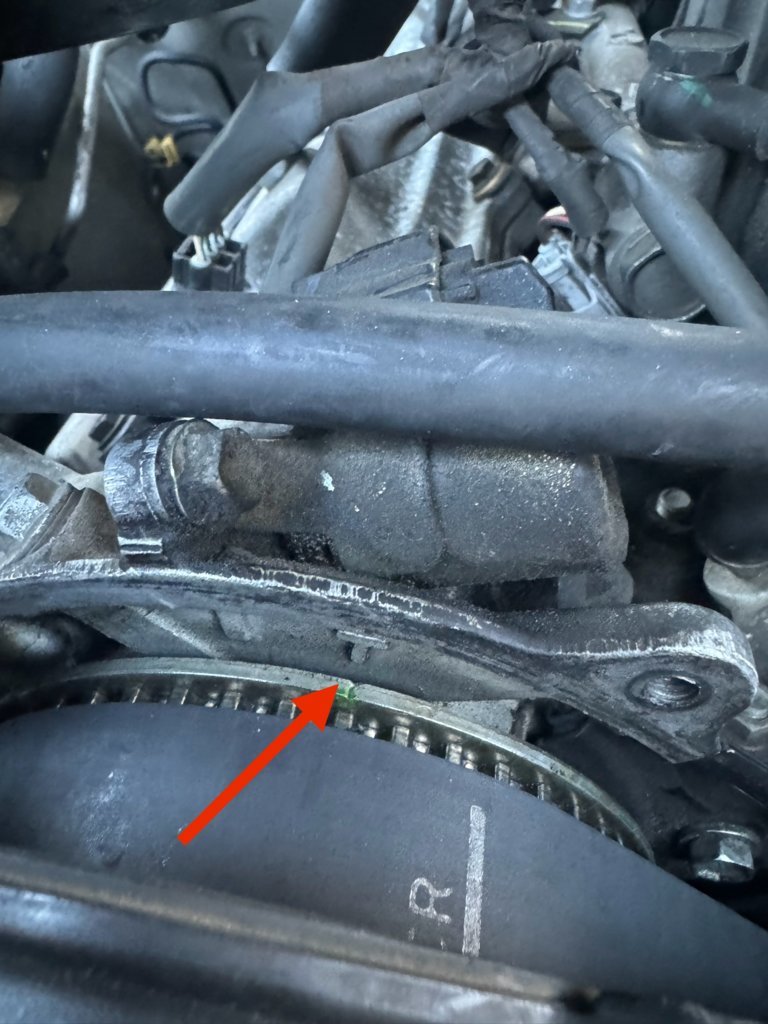

  14. Aug 17, 2024 at 6:58 AM
    Weagle
    Weagle [OP] I survived my timing belt change
    Sep 24, 2023
    #104402
    1,070
    Prattville, AL
    2006 Tundra SR5 DC 4.7 2WD LSD towing pkg
    Bilstein 5100's with 2883's - close to 2" Replacing the 2883's and going back to the bottom perch ASAP -mobile/apple play stereo with sub and backup cam -Power stop HD front calipers and rotors for towing -20" wheels with 32" tires (305/50's) Toyo AT 3's with no rubbing -Westin nerf bars -Detroit axle new (not rebuilt) steering rack with poly bushings, inner and outer TRE's -Suspension Maxx extended front sway bar links -Overland tuning - medium level -Power front leather seats and steering wheel from 06 Sequoia -fully de-chromed/blacked out trim -all light housings incl 3rd brake light and tag lights replaced with smoked lenses, LED where appropriate -mini projector headlights -fully rebuilt trans and new torque converter -new complete drive shaft with spicer u-joints and carrier bearing -all LED interior lights including backlighting -new lower window seals for all 4 doors -all new hardware and clips for tailgate Next: Dirty Deeds racing exhaust with LT headers, yellow box, 12 hole DD fuel injectors, redo or replace door panels

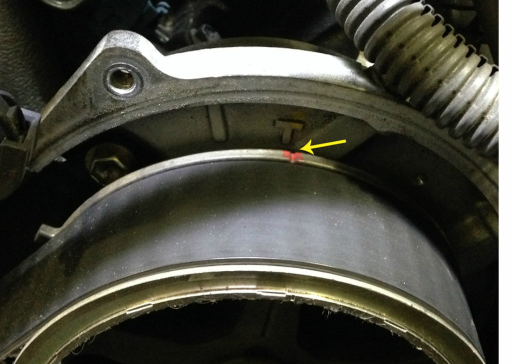

    This is not easy to see in this picture with the lighting and camera angle, but the crank harness feels like it is connected fully and appears to go directly behind the fan bracket as it should.
    i'm pretty convinced it jumped time - a cog But I don't believe enough for it to brick the engine
    I remembered the first crank after the TB change and it was so quiet that I could hear the very slightest soft chirping noise coming from the passenger side front which is where the timing belt tensioner is located. Which not coincidentally had the stripped bolt hole repaired with a heli coil. It concerned me but then it went away and I forgot about it
    and I also remember how it sounded when I tried to crank it for the 2nd test drive. There was a bump or pop noise immediately, and then it didn't start immediately as it always has and just kept turning over even though I released the key due to the auto start feature (unsure of the correct term but where you can release the key and it keeps trying to start).
    that heli coil seem to be installed correctly but if that is the culprit, I guess a time sert is all that is left to correct the problem

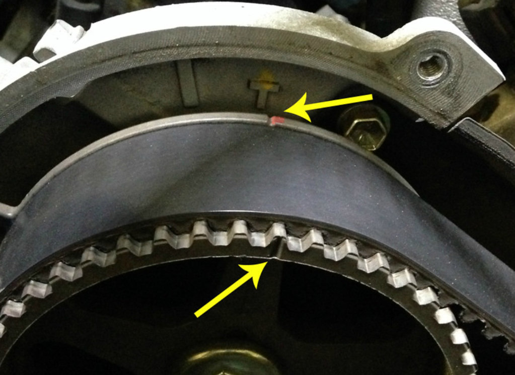

    You saw the thread that shows the trick for jumping the timing belt forward or backward a tooth at a time, right? Verify timing. If needed, use that tip to jump the belt back. But weird it happened. Why was it able to?
    Weagle[OP] likes this.

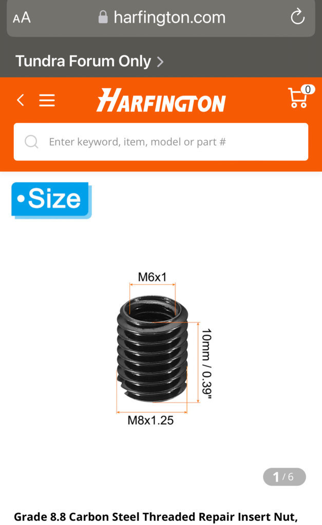

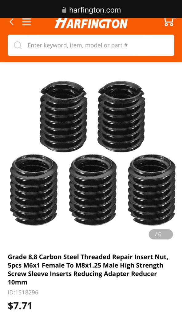

    I'm about to start digging back into this to diagnose. Had to get it moved before I could start and it was in a tight location - not where a tow truck could move it
    I don't know yet if it is the timing belt tensioner whose bolt hole was stripped and we repaired with a heli coil but I'm just looking ahead to consider my options
    I had a long conversation with the service department at a local dealership that I trust more than the others First mechanic was a PITA and wouldn't just answer my question and had to go into the "we would have to diagnose." But the second mechanic was really good and thorough with me.
    All this to say, if it is stripped, then the heli coil failed I believe my only option is a big sert which is a larger time sert to repair a threaded bolt hole that has already been repaired one time
    The dealership told me yeah if you do have to use a time sert and it fails, then You have no option other than to replace the engine. They were not the only ones to tell me that
    That just didn't sit well with me. I thought surely someone makes a double side threaded hardened steel sleeve where you could just tap the hole out bigger and put in the sleeve with the inner threads being the same size as the tensioner bolt.
    and then I found these
    I know I'm getting the cart way before the horse but I guess I'm just terrified that I'm potentially one step away from the engine being worthless.
    Is this a viable option for the timing belt tensioner? Seems like it would be. And some Loctite thread locker red on the outer threads of the sleeve
    I'm not sure this grade is strong enough, but surely there is one stronger. I think 8.8 is not as strong as 8 and is more like a 5. Or maybe 8.8/5 is strong enough since I believe the original hole is aluminum

  19. Aug 23, 2024 at 4:55 PM
    assassin10000
    assassin10000 New Member
    Oct 27, 2020
    #54157
    2,199
    Andrew
    Northern CA
    '05 SR5 AC
    Pretty sure that mounts to the oil pump housing and will NOT require a new engine.
    Our blocks are iron. Your tensioner mounts to aluminum.
    Just FYI.
    Weagle[QUOTED][OP] likes this.
  20. Aug 23, 2024 at 5:04 PM
    Weagle
    Sep 24, 2023
    #104402
    1,070
    Prattville, AL
    thanks much! The stealership should've known that.
    but that does confirm that the tensioner mounts to aluminum so there are multiple options, including replacing the oil pump housing

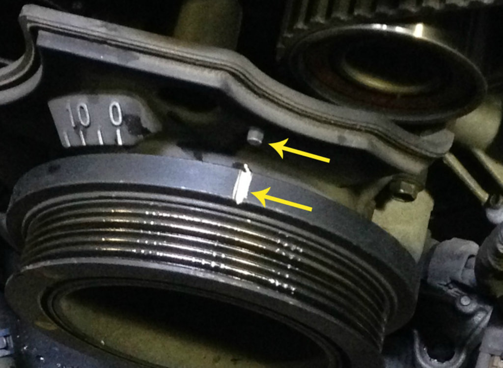

    OK, I'm finally digging in to the issue. I've got both of the top belt covers loose enough to see the belt.
    if it jumped time, then my issue should most likely be the timing belt tensioner pulley whose boot hole was stripped and repaired with a heli coil. Timing belt seems reasonably tight, even though I can only check for tension a couple of inches away from the cam pulleys. For comparison, I would estimate that it is slightly tighter than the serpentine belt is about that same distance from one of its pulleys.
    My question is if I rotate the crank until the cam pulley timing markers are on their mark, will the crankshaft be at TDC?
    I'm hoping to confirm before I have to drain the coolant and tear the whole front off again. Without taking the harmonic balancer off so I can take off the bottom timing belt cover My only other point of reference is the TDC mark

    I say this very cautiously, but I just confirmed some great news. It does not appear to have jumped time and thereby bricking the engine.
    also, I rechecked the crank sensor wiring harness while I was down there and it does appear intact and to immediately go behind the fan bracket. So now what? What a coincidence that it would happen within 30 minutes of running my truck for the first time after a timing belt change unless it is indirectly related
    Ignore the timing alignment marks on the belt. It has already been running and is purely coincidental that they happen to in the pics
    The first three are of my truck. At the bottom are pictures from an article shifty linked in another thread about aligning these without the harmonic balancer/damperener removed.
    My crankshaft mark is at an awkward angle and difficult to see because I didn't remove the fan, fan shroud, radiator etc. it's a little easier to tell in person that it appears to be on the mark
    Driver side cam timing mark:
    Passenger side cam timing mark:
    [​IMG]A
    A little concerned about how far the timing beltshifted forward on passenger side, but it appears to be within the ridge on the pulley (not pictured)
    From the article @shifty` linked:

    So now I'm back to diagnosing the problem. I just don't think it is a coincidence that it happened right after I changed the timing belt
    even though the crank sensor wiring harness appears to be intact, it as always cranked immediately so I'm really suspicious of the crank sensor
    I see where this poster had a similar issue, although he had some other problems as well. He used a loaner Noid light from autozone to confirm that the fuel injectors were not receiving the power and switching signals.
    He got no light when trying to crank, so then he replaced the crank sensor and it started right up. I guess this would be an easiest way to confirm that it is related to the crank sensor and or wiring harness.

    What he did in a roundabout way was confirmed that the crank sensor was causing the power to be shut off to the fuel injectors
    I'm not trying to confirm it's fuel because I don't believe that's it. I'm trying to confirm if the cranksensor and harness are functioning

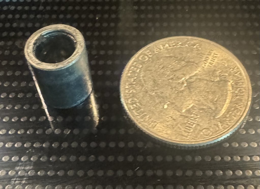

    Found the source of the bump that shook the hood and made me think it had jumped time
    Not sure where it came from, but I knew I found another one loose on reassembly the first go round
    Still don't know why it didn't crank. Crank sensor wire and harness seems to be OK I guess I should test it before I put everything back together

    Given I haven't done TB/WP yet I'm not sure what I'm looking at, but that appears to be a standoff/spacer you'd find to hold, like, an accessory bracket in place.
    Is it possible you missed a spacer on one of the accessory brackets, and that's why the belt is sitting so far off? Maybe someone who's done their TB already would know.
    That's pretty stout, too, any dents inside the hood?

    no dents - it was still within the lower timing belt cover
    It's possible that pushed the timing belt out a little bit. The timing belt is still Within the acceptable range but not what I would have expected
    I Think that is exactly what happened I just went to take a picture of all of the pulleys and the timing belt is back in position. I did the bump start method to loosen and then remove the harmonic balancer/damper. That's the first time the motor has taken a turn other than me lining up the timing marks since the incident
    I'm still going to take the timing belt off and fully inspect to be sure there is no damage to any of the pulleys and the tb
    I believe it is something like these that are on the old water pump
