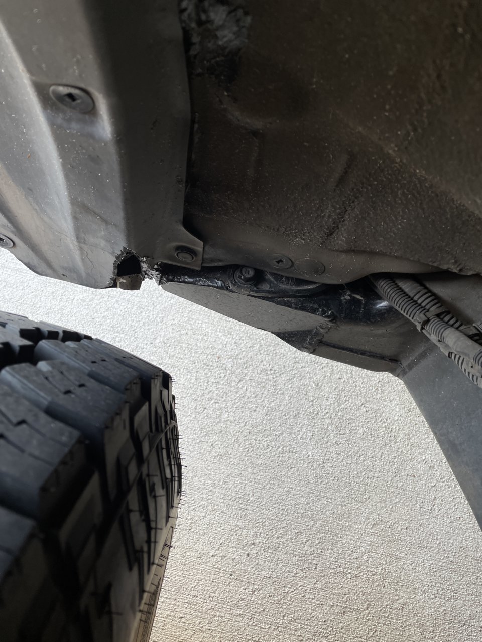

    Yeah, BMC is simple and there is really zero risk. Using the cut off wheel is the easiest part...I have a welder and did the plate myself. IMG_9648.jpg
