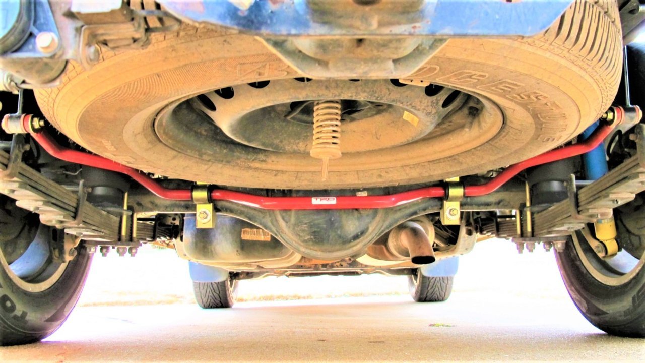

    A rear sway bar makes all the difference in the world if you want the truck to handle better on pavement.

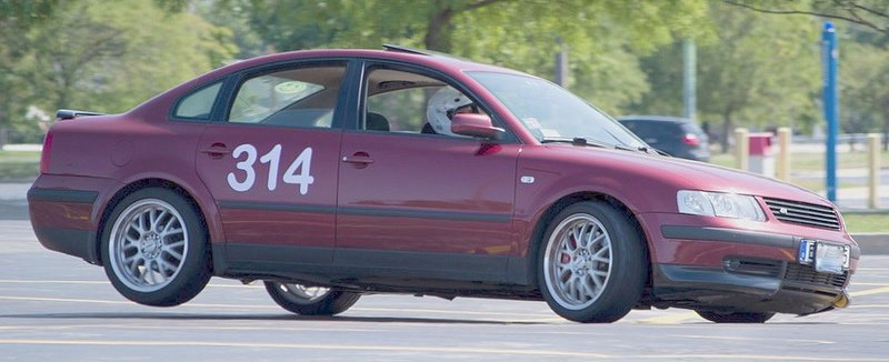

    Sway bars actually lift the opposite wheel away from the road, reducing traction. In extreme cornering a rear sway bar will actually lift the inner wheel completely off a road. (the vehicle tries to roll to the outside, compressing the outside suspension, which lifts the sway bar and pulls the inner wheel upwards towards the frame of the vehicle)
    However, they do this by pulling the body of the vehicle down..compressing the suspension and lowering the center of gravity...which DOES improving cornering, as long as you are on a high traction surface. On a loose surface you will loose grip much more quickly and go into understeer straight off the road.
    Multi link IRS suspensions will take advantage of this, changing toe and camber progressively with suspension loading to assist in steering. A solid axle simple loads the suspension... on both sides when cornering, instead of merely the outer side.
    It is indeed more predictable and feels like a better corner....unless you take it too far and realize how much less traction you have.
    This is a good photo showing what happens in extreme cornering with a rear sway bar. As you can see, the rear tire is not off the ground because of body roll, you can see that its actually pulled up tight into the wheel well, so much so that its been pulled off the ground by the sway bar from the heavily loaded outer wheel.
    With no sway bar or a weaker sway bar there would be more body roll, but both rear tires would still be on the ground.

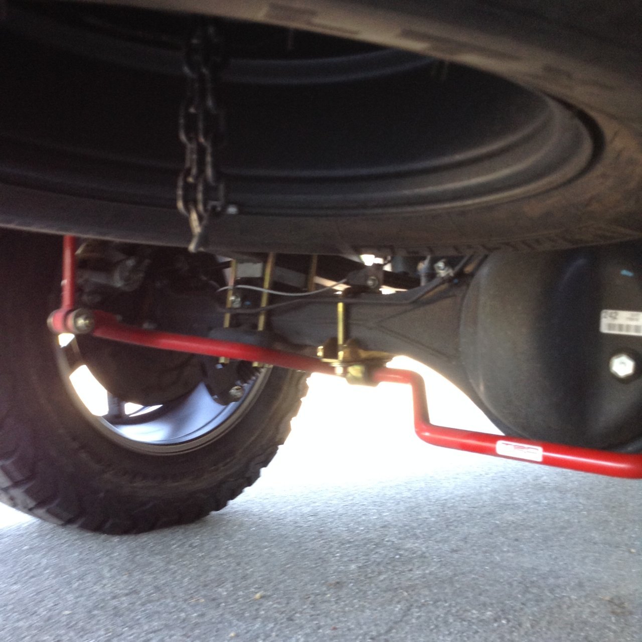

    A rear sway helped me in all 3 of the above areas. Wished I had added the Hellwig 7700 sooner.
    It also keeps my inside real tire in contact with the pavement on slow 90° acceleration turns. A real benefit on wet roads.
