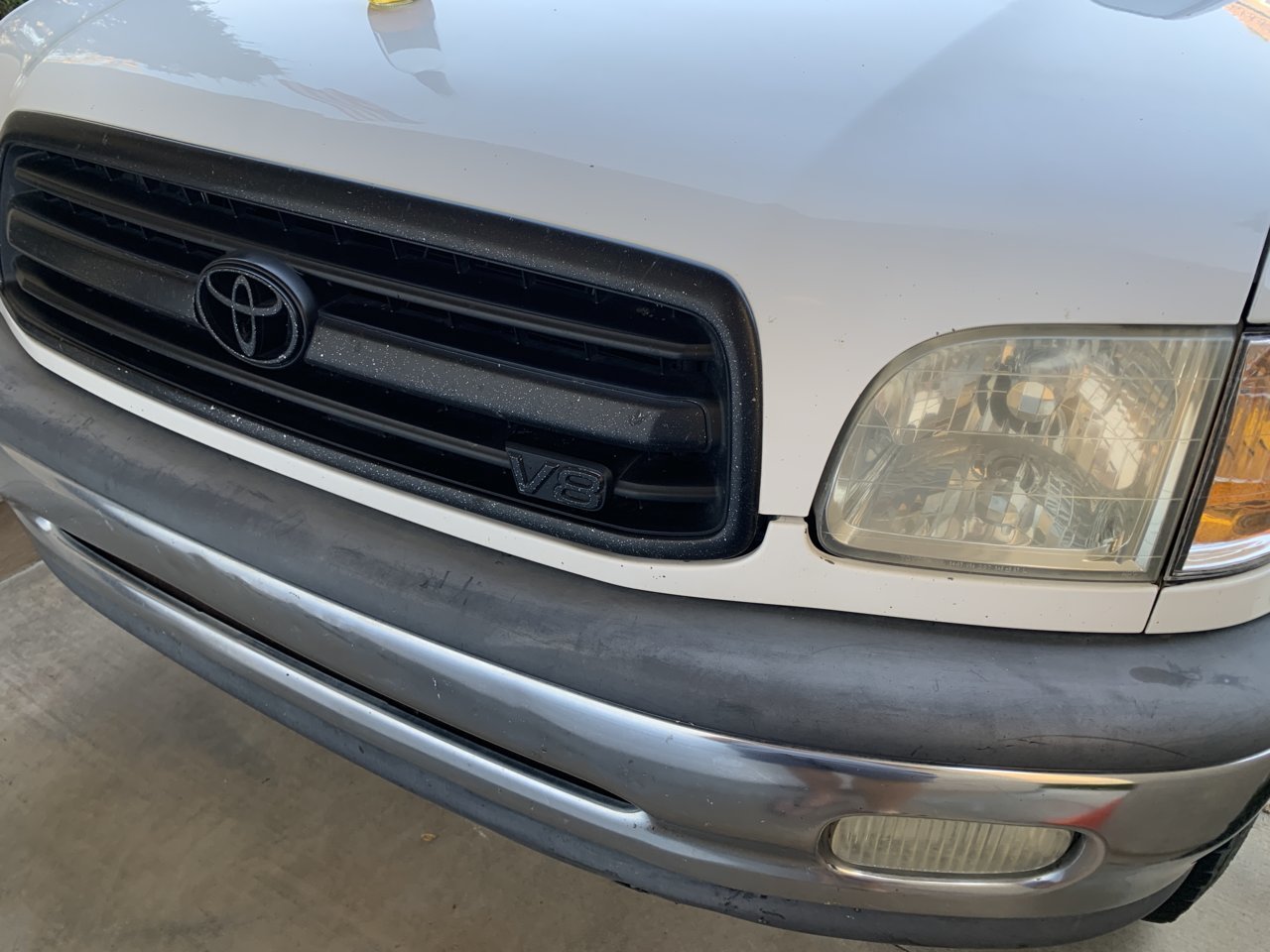

    Things It Needs:
    • Rear shocks rebuilt, both seals are blown. Anyone have any recommendations in the Orange County, CA area? Maybe SD. Not looking to send them to Icon $$$.
    • Headlights Replaced. They're not too yellow, but they are fairly faded. The HOA I live in now used transmitter stickers to get in the gate which they prefer to put on the headlights. Soooooo might as well get a new headlight before paying for the gate transmitter.
      • [​IMG]
    Have you considered doing the sand/polish/clearcoat routine? It works really well, costs only a few dollars and some of your time (which could be worth more than new lights... not judging). Lots of good info here and on youtube about how to do that also. Biggest tip, be careful, be gentler than you think you should, it will just take a bit longer and come out better. (this technique could also work on those marker lights too.)

    I've had hit and miss luck with it buffing headlights. I've done quite a few with my Rupes buffer over my detailing career. Did the taco, and they always yellowed sooner or later. Did the headlights on my father's camry for him, and those have been holding up great. I've been applying a coating of Meguir's quick wax every month or so. What clearcoat, or sealer, has worked for you?

    I tend to put a spray clear coat over them when I do them. Have been using a standard automotive clearcoat. Have had luck with a TT, 2x BMW, a Hyundai and my Tundra. Some less perfect than others sure, but all were made good enough to not need to buy another light.
    Rustoleum makes one I have been trying out on some other plastics, and intend to use on my next headlight pair, it is supposed to bond to the plastic and protect it... Results are still pending on that. (So far, its the clear on a 3d printed art thing im working on (gets sun) and on top of the 3d printed handle in the rear hatch of my little electric fiat... both are just crap PLA prints, that have surprisingly held up under the AZ sun for a bit over a year after the paint protection... the handle did feel a bit soft in aug last year, but PLA without protection left in the sun here dies fast... Not the most scientific of methods, and purely anecdotal)
    Worst case, I sand a bit more to remove the clear.
    How high of a grit are you sanding to?
    I rough out with 1k... yes its slow and painful, I am not trying to remove the plastic, just the top oxidized layer, and I step through 2.5, and 5k, sand all wet. After that I hit it with Meguires 105, then 205. But I do a lot of it at the table, most of the time while watching a movie with the wife. So the time isnt a factor for me.
    The only thing I learned that was really important. Slow down, take your time. if your time is worth more than the lights. order lights. (I should have bought the 5 series set I did)

    I feel you with the intense sun. I’m a few blocks off the beach, it’s not as bad as AZ sun, but things can get baked here fairly fast.
    Haven’t buffed a headlight recently but I think I typically start at 1000 or 1500, then 3, then 5. I never have an issue with cleaning them up, it’s just usually the sealant. At work they’re not a fan of us using clear coat so it’s typically whatever buffing compound we have.
    I think I’ll give these a buff then shoot some rustoleum clear and see how she holds up. Do you use a buffer or do it all by hand?
    I really should give meguirs a try. Typically I use Rupes, as that’s what I have at work. Might use some Meguirs when I buff out the tundra to make it really shine.

    Headlight buckets are pretty cheap for these trucks. You can get them both for under 200 bucks and they'll last 10 years before they are cloudy. None of the driver's side seat belts rewind on these trucks. Just toss the slack on the seat so you don't slam the buckle in the door after you park it.

    I have a brand new driver front headlight for your year Tundra sitting at my desk at work in Anaheim if you want to swing by for it (no charge it's yours for free).
