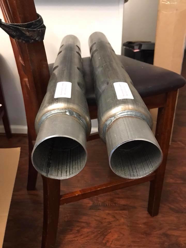

  6. Jan 24, 2024 at 3:13 PM
    texasrho83
    texasrho83 Old Member
    Mar 30, 2017
    #7025
    10,602
    Charles
    Conroe TX
    2016 DC MGM 4x4
    See build link
    Echo chambers
    FrenchToasty, cran2 and moodywizard like this.
