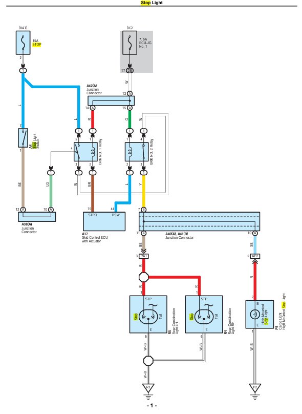

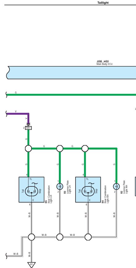

    So it is the brake/stop, parking light, and plate light on the right/passenger side?
    Doubt it's a fuse, both sides are the same circuit.
    Brake light
    Parking and plate light.
    The only thing these 3 issues have is a common ground.

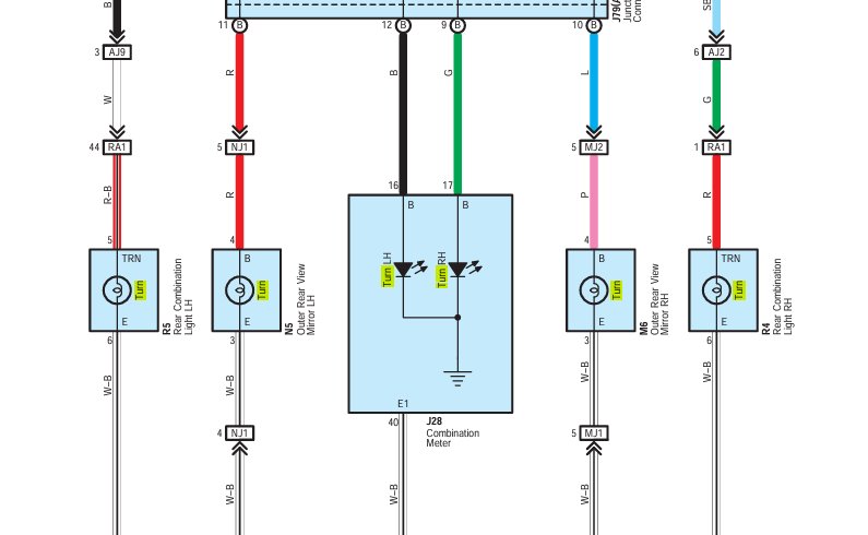

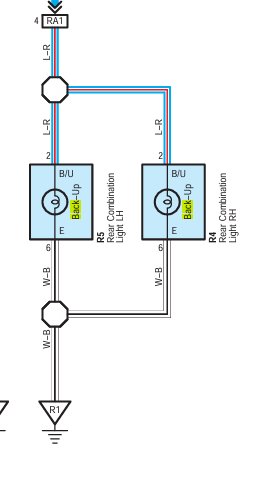

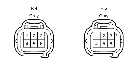

    But the turn signal and backup light use the same ground pin 6 of the R4 connector.
    But then I noticed this..
    Are you using aftermarket tail lights or LED bulbs in OEM housings?
    I'm guessing aftermarket tail lights but not sure why the plate light isn't working, or is it an LED bulb as well?
