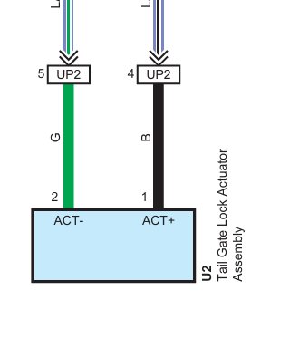

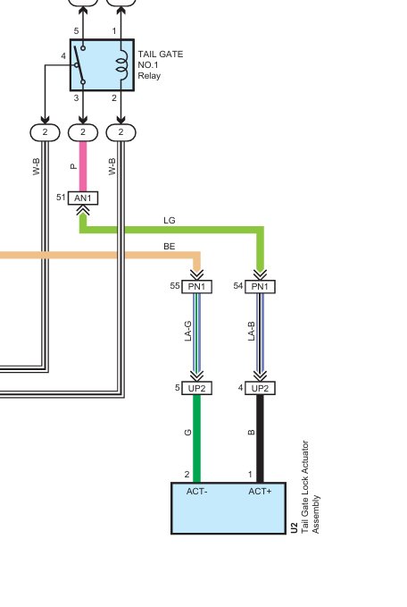

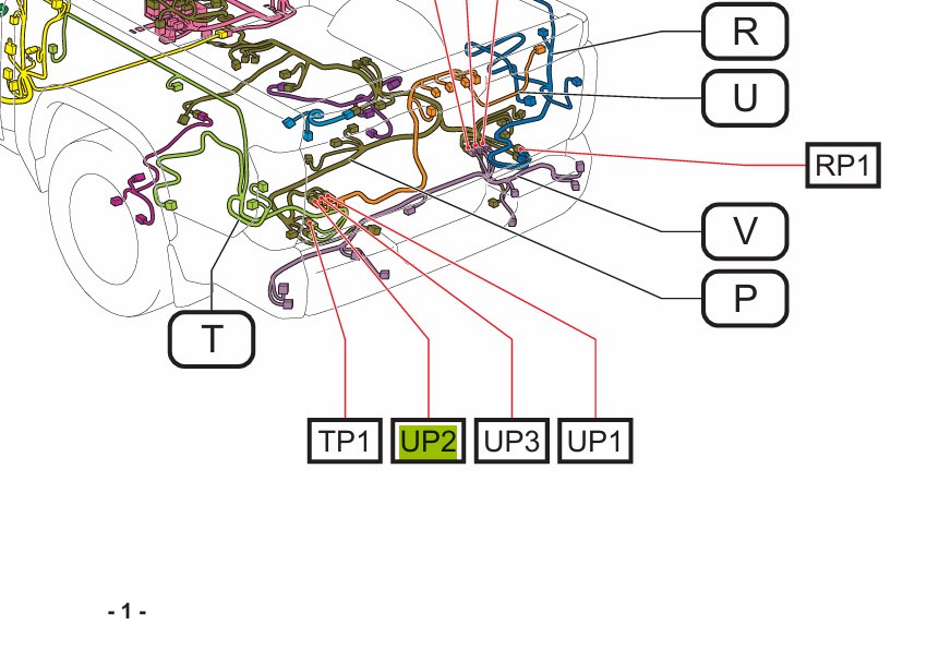

    At first I though to unplug the UP2 connector, but it provides a ground for the tail lights among other things.:eek2:

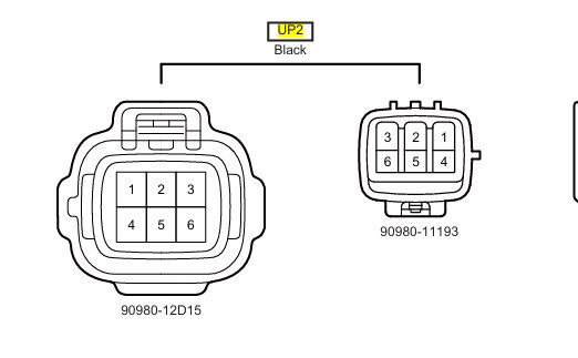

    You could install a bypass switch in the bed that interrupts one of the feed wires to the tail gate lock actuator when you don't want it engaged.
    In the UP2 connector, it would be pin 4 black wire to the tailgate, or pin 5 green wire to the tailgate.
    Good luck..
