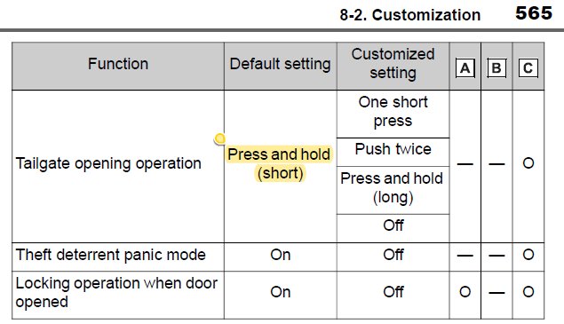

    This is a customizable feature to disable the fob button. Optionally, you can have the dealer program the fob to require either a long hold on the button or two pushes of the button. The factory default setting is a short press of the button and probably the setting most susceptible to a pocket dial. I turned mine off as the button on the taillight was sufficient.

    Dealer says they see the thread but dont know how to do it.

    Time to find a new dealer.... Do they even know that column C is what the dealer can do?

    Hard to say. Said they spent 1.5 hours doing "research"
