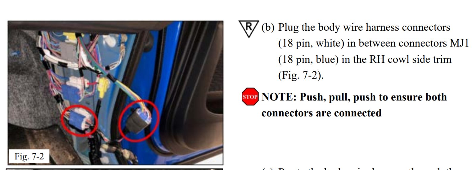

    Yes, the tailgate lock wiring shouldn't have it's own fuse.
    Even if it did, it would be an inline fuse close to where it connects the OEM wiring in the kick panel.
    The instructions I posted for OEM were on the passenger side and it used a bypass plug-and-play harness.
    Your unit may have either the bypass wiring harness, or it may have wires tapped into OEM wiring with wire taps.
    This is the OEM with the bypass harness instructions
    Accessory Installation Instrucution Template - 2004 (sparkstoyota.com)

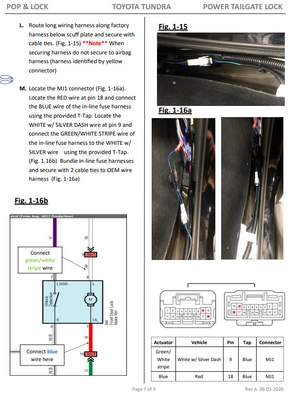

    My lock is old-school Pop and Lock so I had to tap into the OEM wiring with wiretaps.
    This is the Pop and Lock instructions that use the taps.
    PL8547HD_Toyota-Tundra.pdf (vehiclesecurityinnovators.com)
    @2mchfun posted the link to the wiring diagrams, but if you need me to post them here, just ask..:thumbsup:
