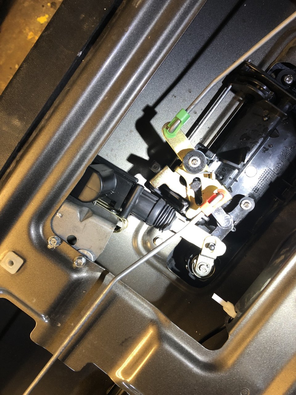

    If you are having problems with it locking and unlocking properly, you need to make sure it is completely straight up. Otherwise it won’t work properly.

    I didn’t take many pictures. But I took a video that I can’t upload. It won’t let me. Another guy posted about tapping into the white wire and the blue wire at the passenger kick panel. It worked! So this thread was mainly of the bracket that I chose to use.
