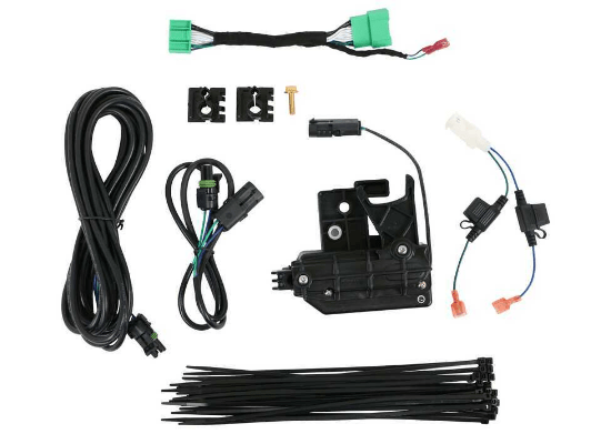

    They do now make a plug-and-play pop and lock for the tundra.
    Although there is no way around running a line to the cab.
    I just zip-tied mine to existing wire looms, poked a hole in the rubber bushing in the driver's floorboard, and tapped into the appropriate wires.
    Looks like now they have a PNP adapter so there is no wiretapping..
    Pop & Lock Custom Tailgate Lock with Plug & Play T-Harness - Power - Black Pop and Lock Vehicle Locks PL94FR (etrailer.com)

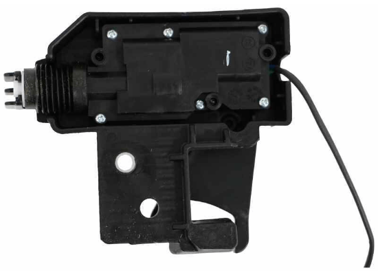

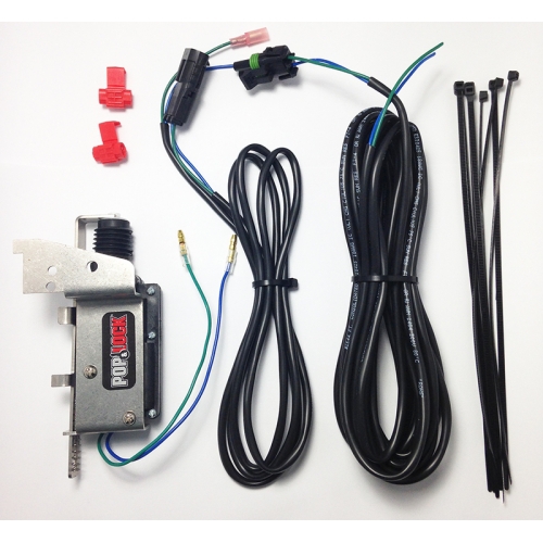

    I hear the newer ones with the plastic cases are a little quieter than my old-school PNL.
    Old one
    New one

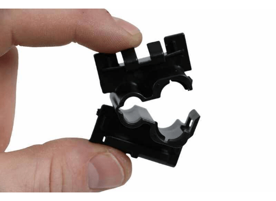

    Also the newer ones have the replacement grommet for the tailgate that has room for OEM wires and the P&L wire.
    Had to shove both of mine into the OEM grommet.
