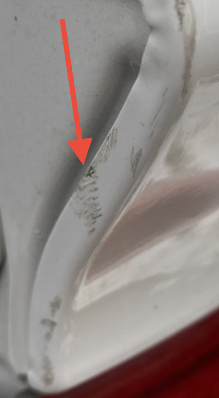

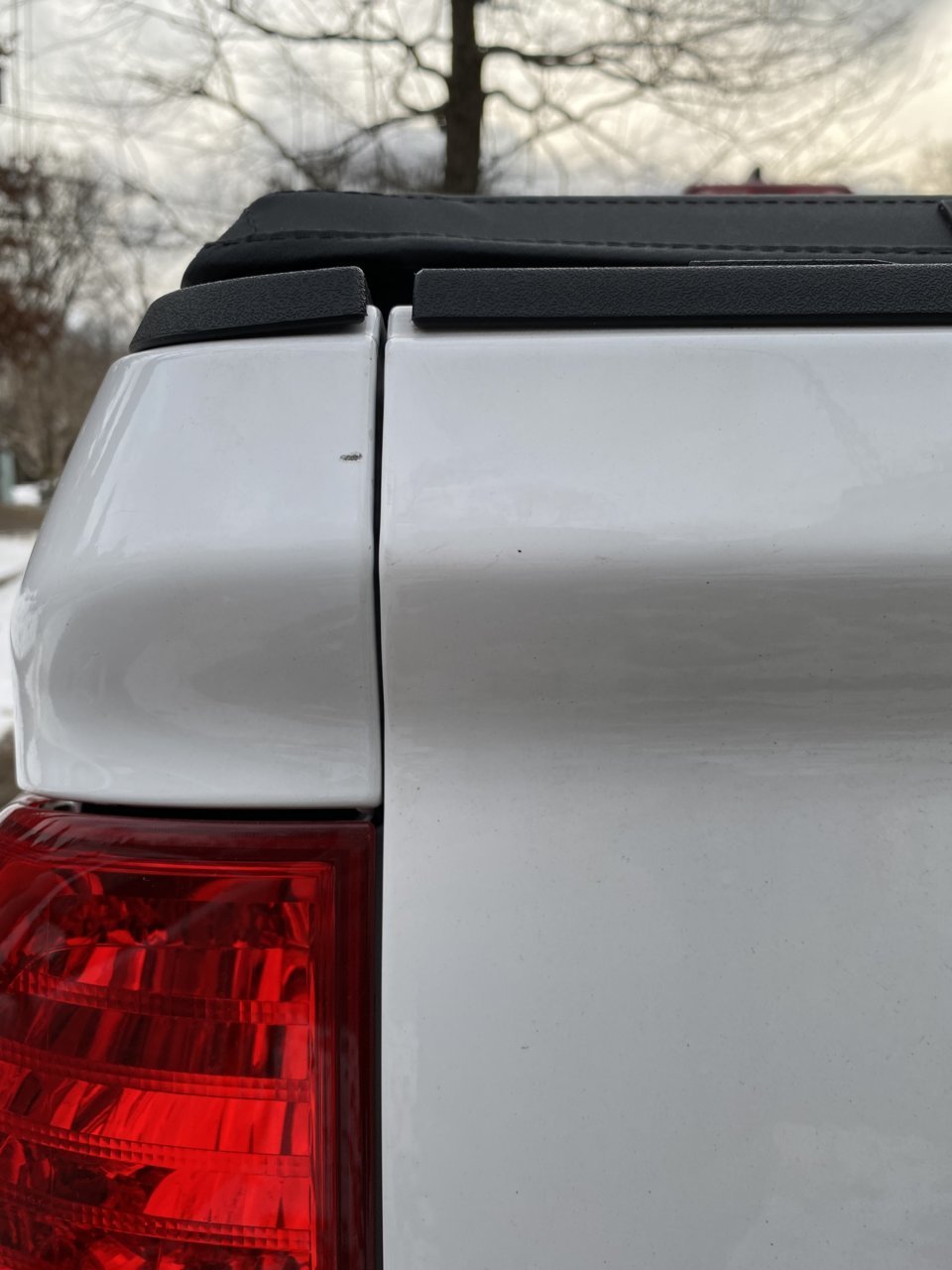

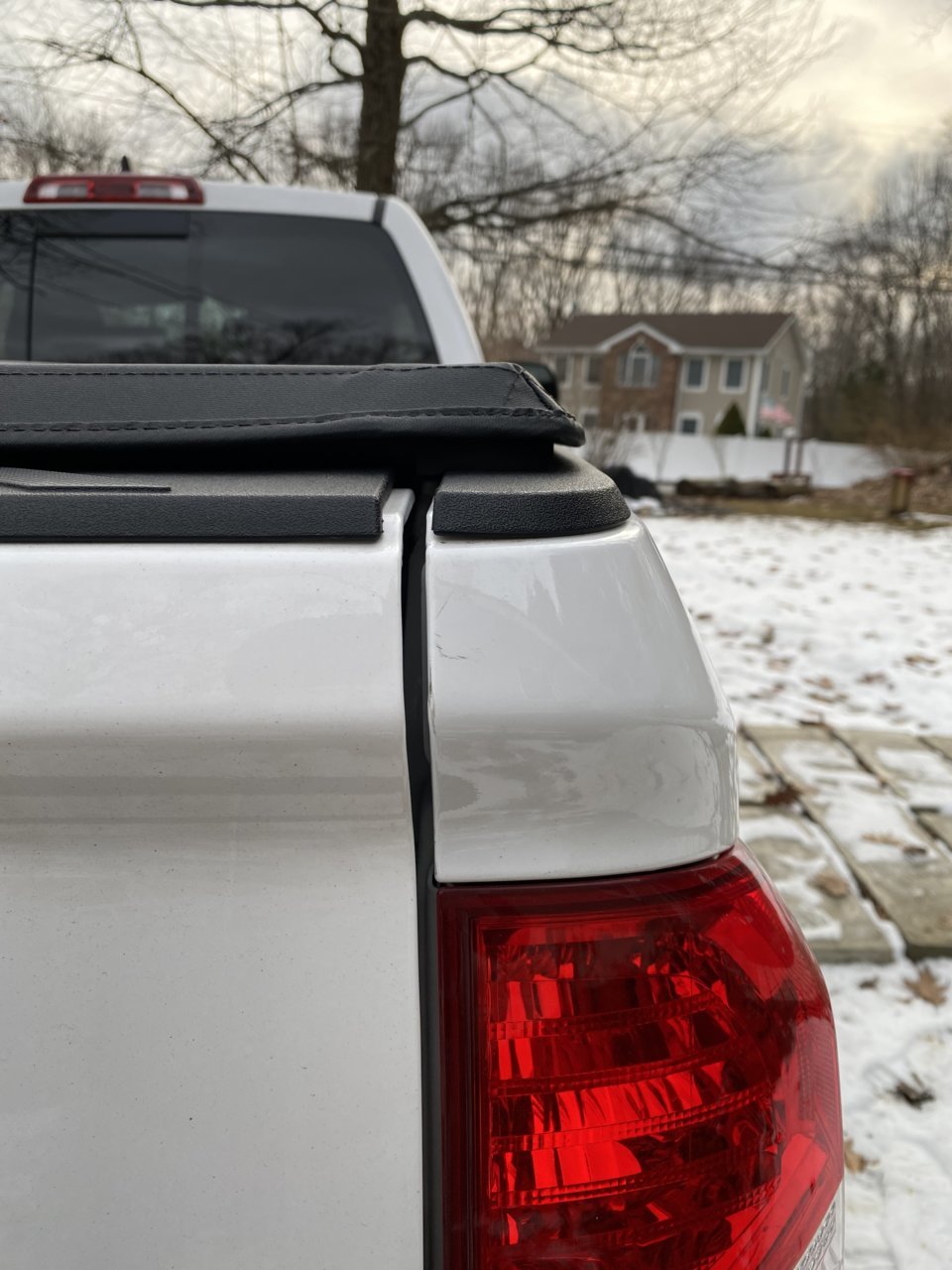

    What do your tail gate gaps look like?
    I’m not sure whether or not someone was trying to jam some sort of tool to open up my tailgate, but the gap on the right side is quite larger than the left side…

    Definitely not right, mine are closer if not equal. That rub isn't likely for someone trying to shimmy the tailgate open and shifting the tailgate - that panel would fold like a piece of paper before the tailgate shifts.
    Is you're bed square? A little variance is to be expected, but I suspect your driver front to passenger rear distance will be more than passenger front to driver rear. And the bed being out is why the tailgate does not fit right now

    I’ll definitely take some measurements… but this does blow.
    There is a small chip off of the tail lights… so now I’m wondering if someone was trying to get into my locked bed.

    Definitely looks like tool marks. Looks like someone was attempting to get in.

    Is it wider at the top than the bottom on the right side? Maybe some bead spread. They make stiffeners for that. The tailgate also has some left to right wiggle room due to the way it’s mounted on cams at the bottom. Loaded anything in the back that could have rubbed that side going in?

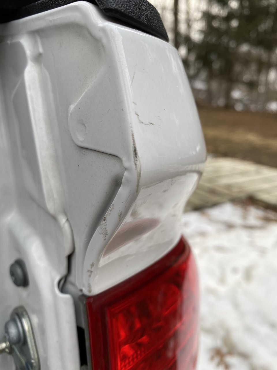

    Look for damage on the lower left side hinge

    Flat blade screwdriver marks?

    God dammit. I’ll go outside and check again tomorrow for any damage to either sides.
    Would there be a chance of even adjusting the side to side clearance? The left looks like it’s about to smash right into the tail light..

    I agree with the others here that it certainly looks like someone tried to get into your bed VIA the tailgate. If it were mine, I would pull the gate off and see if you can see any difference side to side, and adjust anything that looks to be slightly bent. Good luck.

    The plastic inserts inside the hinges tend to break after awhile, especially once your strut goes out and your tailgate slams down harder. The inserts are on both sides, but the driver side it the one that breaks most often.

    But I'll agree with others, looks like you've got some kind of tooling/prying marks on yours.

    Doesn’t look to have any other damage aside from the tool marks that were pointed out.

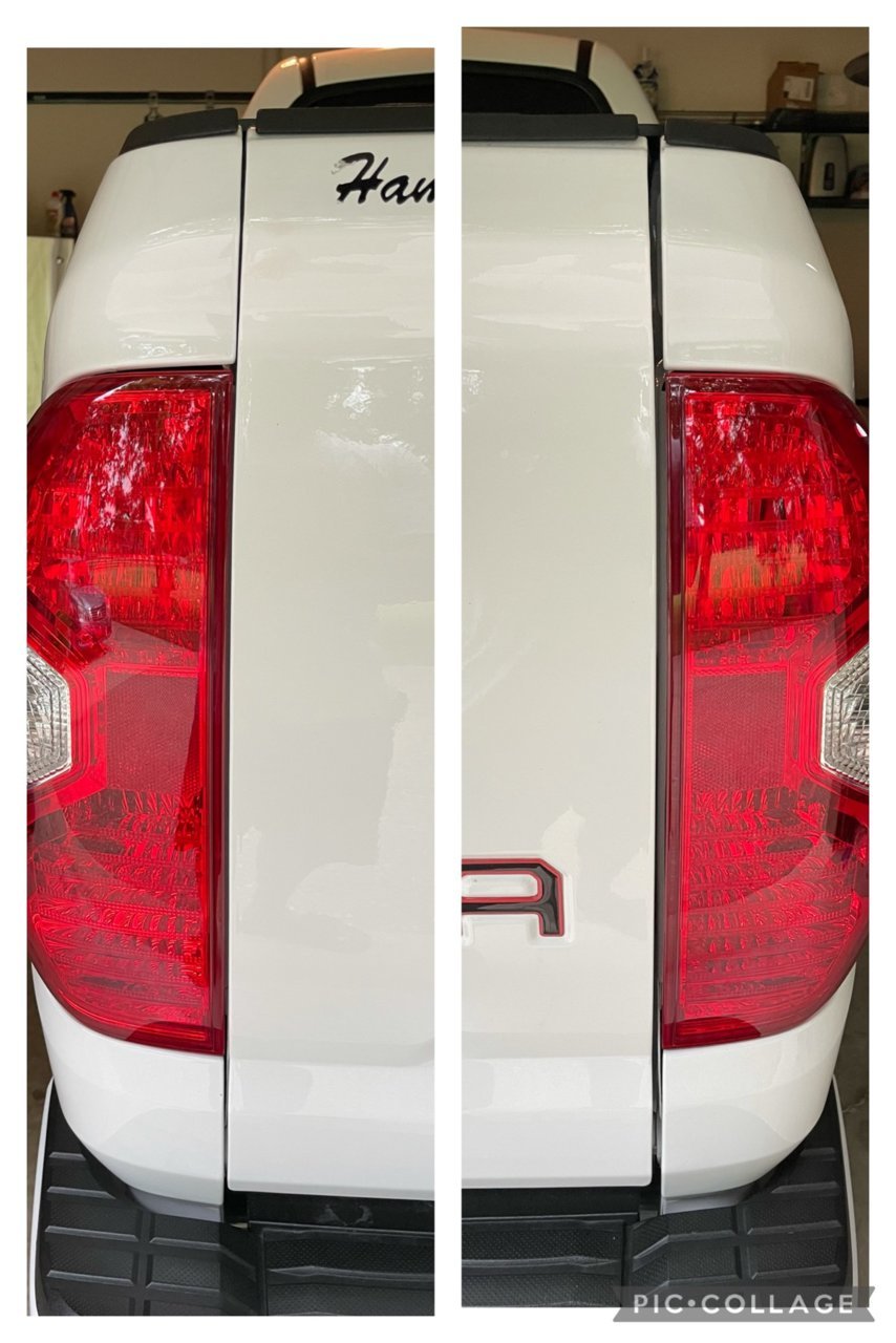

    HAHA Right?! I went to look outside when you posted this earlier. My tailgate sites perfectly.
