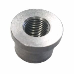

    While on a long roadtrip from Colorado to Florida last month, I opened my tailgate to find that the passenger side cable had come loose where it attaches to the bed rail of the truck. The cable and upper bolt remained attached to the tailgate, but whatever that bolt threads to was gone. There's just an over sized hole in the sheet metal of bed rail, but nothing to screw the bolt into.
    Yesterday, I went to my dealership's parts department, but 3 different employees couldn't find the part on any of their diagrams. They concluded there must have been a nut that was tac welded to the sheet metal that broke loose, and they told me there is no replacement part other than buying the whole sheet metal tailgate surround.
    I've temporarily fixed it by removing the tail light assembly, then I used a large washer and nylock nut to secure the cable bolt. It works, kinda, but I'd still prefer to have the factory part.
    Do any of you happen to know what actually secures that upper cable bolt? To me, it should be some sort of threaded bushing that snuggly fits the hole in the sheet metal. If all else fails, I'll remove the other tail light to see what the factory part looks like. But I thought I'd shout out to this community, first, to see if anyone was familiar with the part.
