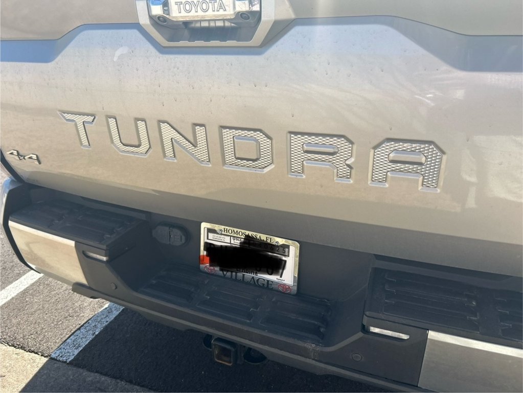

    Everything is bone stock on the truck except for these added letters to the Tundra badge on the tailgate. For some reason the previous owner added these chrome diamond letters and nothing else. Needless to say, I'm not a fan of them so I'd like to remove them. What's the best way to go about getting them off without damaging the paint underneath? Heat gun, acetone, etc?

    I've always just used a hair dryer and gentle prying, but on my Tundra a buddy handed me some braided fishing line. I blew him off at first, but damn that stuff cut through like butter. then I used straight rubbing alcohol to remove the mounting tape residue. The few bucks is well worth it, and you only need a couple feet of it.

    Heat and dental floss for me in the past, clean up residue with wd-40 and a rag. Easy work.

    You'll need a hair dryer, a small plastic trim removal tool, and some fishing line. I don't like using a heat gun on trucks as I don't trust that I won't boil the clear coat :anonymous:
    I would get it all hot, pick up a corner with the trim tool, and then start flossing away with the fishing line! It'll get a little tricky thanks to the embossed nature, but you can do it!

    I think the recessed nature of those letters is going to make any method difficult.

    Nope just some cheap, stick-on pieces. It's quite literally the only modification the previous owner made to the truck. I should have gotten the dealer to remove them, but I picked the truck up in Florida and had to drive back to Tennessee. Didn't feel like waiting around.

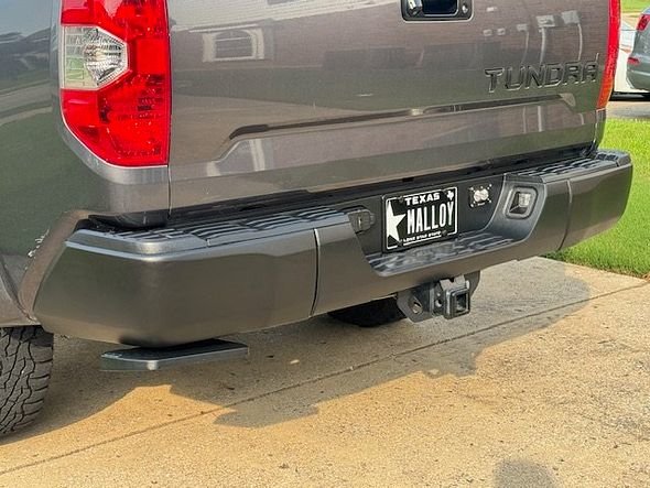

    I recently removed my carbon fiber inserts that were on my 2014 for 9 years after getting my black bumpershellz.
    They looked a lot like what you have there..
    As @memario1214 suggested I got under it with a dash removal tool and they peeled right off, most of them in one piece.
    Amazon.com: Tresalto Auto Trim Removal Tool Kit - 5-Piece No Scratch Pry Tool Set for Car Panel and Dashboard Removal - Includes Door Panel Tool, Push Rivets, Car Clips - Essential for Interior Trim Work - Blue : Automotive
    I then used Goof Off to gently remove any residue.
    I've used it on my truck paint before with no problems.
    I'm going to agree with @Matt2015Tundra I don't think you could get fishing line under that recessed area.
    I don't think you'll need to anyway.
    Peel up an edge and it should come right off.
    I wouldn't bother heating it unless you have problems.
    Kinda bummed me out removing it.
    It was my first mod to the truck, but it didn't match the black..
    Replaced it with this..
