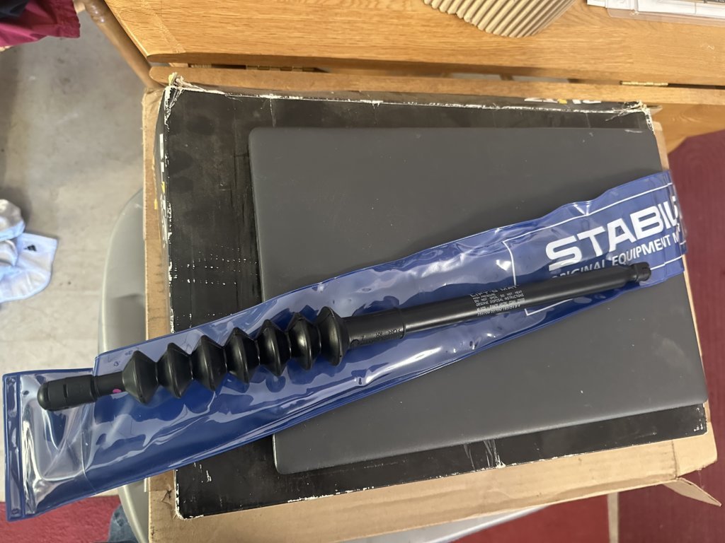

    2010 tundra tailgate assist lowering shock 66140-0C010
    No longer available from Toyota. My new to me 2010 has almost worn out and I like the
    feature so I'd like to replace.
    Can anyone help me with finding replacement??

    It would appear my search ability on RockAuto was flawed. I found it under a different name. On it's way.
    It's called a Lift Support - nothing to do with tailgate anything.......

    Things like this are usually provided by toyota venders anyways, But as @b6graham provided a clearly well priced
    replacement from Amazon. I found on RockAuto as well, but for me in Canada the shipping/duties makes it 45% more
    expensive so I just paid more on Amazon.ca and saved the hassle as well as getting it tomorrow, not next week.

    Stabilus is probably the top worldwide provider of these type of struts. they've been doing it a long long time

    Question about the shock and how the tailgate lowers.
    I bought my 2011 in Dec 2023.
    If I open the tailgate and let it drop, it doesn't fall hard, but it doesn't ease all the way down.
    How are they supposed to fall?

    That’s how mine is now, it doesn’t bang down but I’m replacing it now but my impression
    compared to the relatively good one on my ‘07 is that it’s time to replace before I need it.
    Less than $40 so for the price of restaurant dinner I’m replacing mine.

    My 2012 started out pretty buttery. Somehow one of my favorite little features on the truck.
    Over the past year, the strut is showing signs of deterioration. Instead of opening smoothly and consistently thru the entire range, the tailgate falls open about 2/3 of the way, bounces up slightly before dropping the remaining 1/3.
    I also plan to replace the strut in the near future.

    Replaced mine today. It literally took me 5 minutes from taking out the taillight to putting it back in. Very simple. Now the tailgate lets itself down easily.
