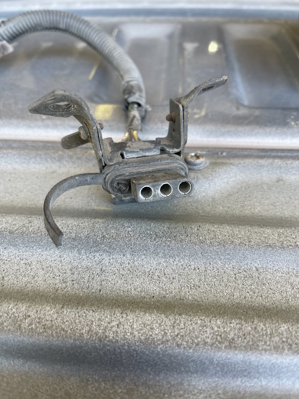

    Hello, I really hope you guys can help me out with this headache. So I recently bought brand new headlights, fog lights, front signal lights and taillights for my truck.
    I put them on and I noticed my dashboard was not lit up like it usually is. I checked my taillights and they were off. The break light will work and so the reverse lights but the the other red lights that turn on when you’re just driving. So I checked my fuses and the Tail 15A fuse was blown. I replaced it and as soon as I turned that knob to turn on the lights it blew it again.
    I decided to remove every light bulb from the headlights to the fog lights, turn signal lights and tail lights and when I replaced the fuse and turned the lights knob back on it blew it again and this is with no bulbs lights anywhere. I don’t know what else to do.
    I would appreciate any suggestion. Thanks in advance.

    Fuses blowing is typically the result of a hot wire touching ground somewhere. Anything like that which would cause excessive load/draw on the circuit.
    If it still blows with all bulbs out of each socket, I'm thinking pinched wire or one of the sockets is defective; look in each socket to see if anything is bent OR maybe it's something you did while reinstalling one of the fixtures that pinched a harness, so you may want to fully pull out (and leave hanging) every light fixture you removed to swap bulbs?

    someone rear ended me a few months back and the hitch harness was damaged. I was going to replace it but didn’t get to it just yet. So I unplugged it from the connector.

    The problem with mine was that the little metal wires inside the front left turn signal socket were not set in their proper slots. I don’t know how they managed to move but they were making contact. So every time I would turn my lights on. The fuse will blow. After pushing them back down into the socket, it fixed the problem. I know that my new front turn signal was different than my original one. I eventual kept the new housing but put the original hardness into it and just bought new bulbs.
