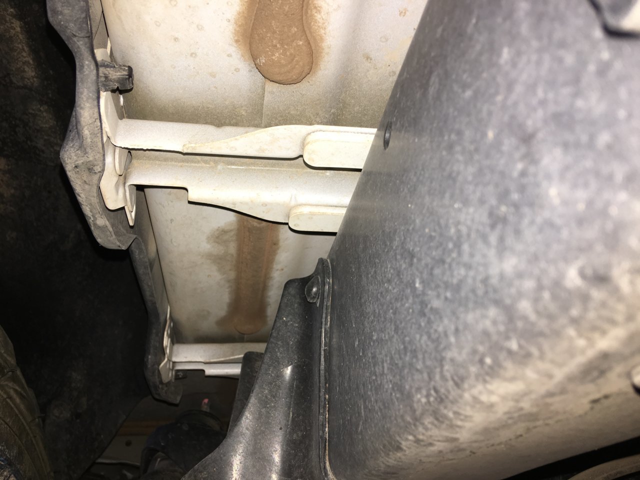

    I am a first time toyota owner new to me anyway..used 09 Tundra
    I am genuinely curious as to what purpose the metal tabs in the rear wheel opening that extend downward from the underside of the truck bed. Serve they have holes drilled in them leading one to believe they are used to mount something but I don't know what that something is or why they were designed like that

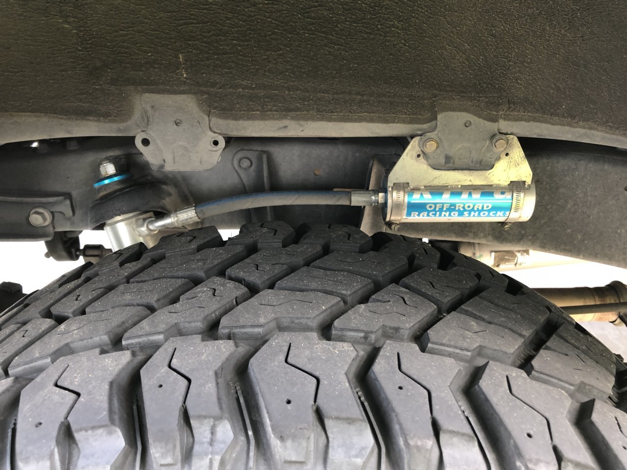

    I have seen someone mount reservoir brackets on those tabs.
    This guy just posted this video yesterday. Start watching around 5:00.

    2011 DCSB Limited 4x4 “Clifford”
    Sure enough my 2010 has them on both sides. They appear to be attached to a support that runs under the bed and to the other side.

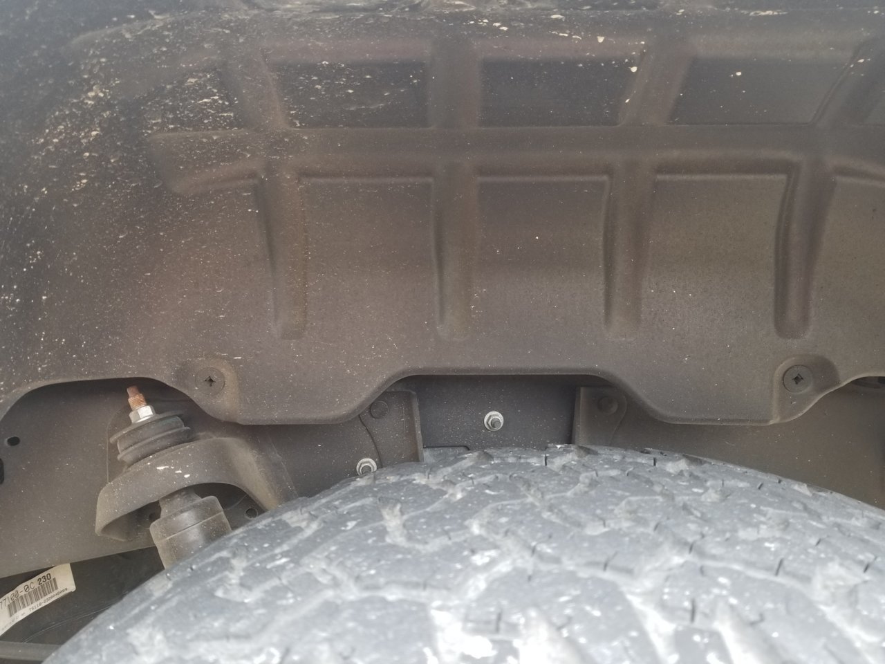

    I have the inner fender well liners mounted to those similar tabs. IMG_20180408_133430.jpg

    09 Dc 4x4
    Are those inner liners factory installed??
    Boerseun[QUOTED] likes this.
  19. Apr 8, 2018 at 10:42 AM
    ShreveportTSS
    ShreveportTSS Huh?
    Jul 4, 2016
    #3762
    1,395
    Eric
    Louisiana
    2018 5.7 4x4 Crewmax TSS
    As far as I know they are. They are not listed on the build sheet as part of the SR5 or Sport Trim add-ons.

    For reference I have a 2013 SR5 Crewmax 4x4. Towing package(if that matters).
    Not sure what they are for, but the bracket holding my resi seems to like it LOL.

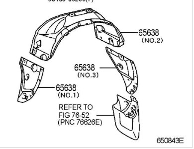

    My second gen has three pieces of the wheelhouse liner and doesn't connect over to those tabs. Thinking it's an add-on that Toyota included on the third gen to clean up the truck a little.
    Here is the third gen part # for the wheelhouse liner :
    65637-0C040
    65638-0C040
    Any 3rd gen owners that can confirm the wheelhouse liner is one-piece?

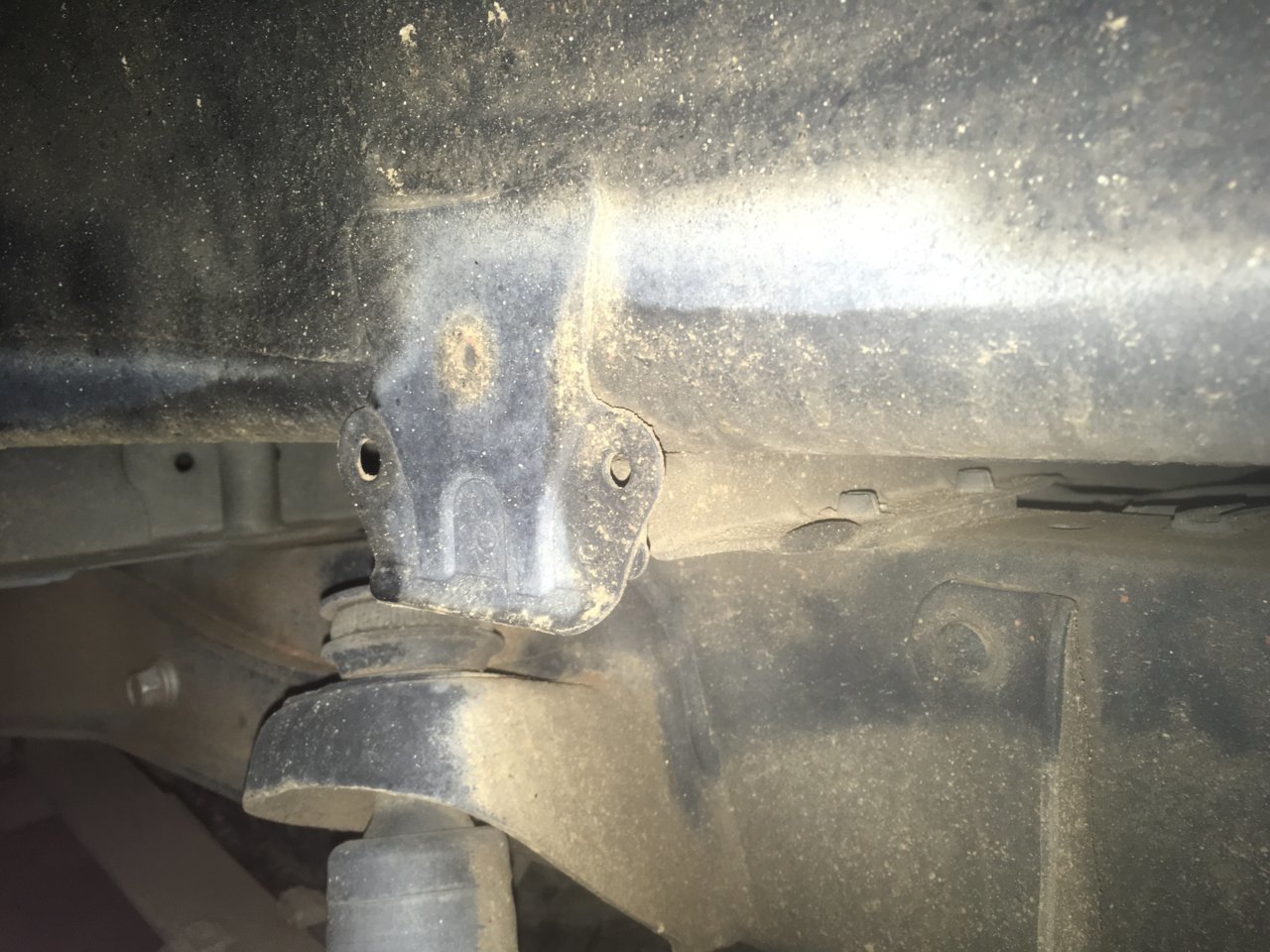

    NW Oregon
    Here’s a picture of the inner fender liner support that comes stock on ‘14 and newer.
    Several posts already showing the plastic liner itself, so I won’t repeat that
    @lugnuttz
    You could probably buy fender liners for a newer model and modify them to fit with shears and a heat gun
    lugnuttz[OP] likes this.

    good for KING reservoirs :D
