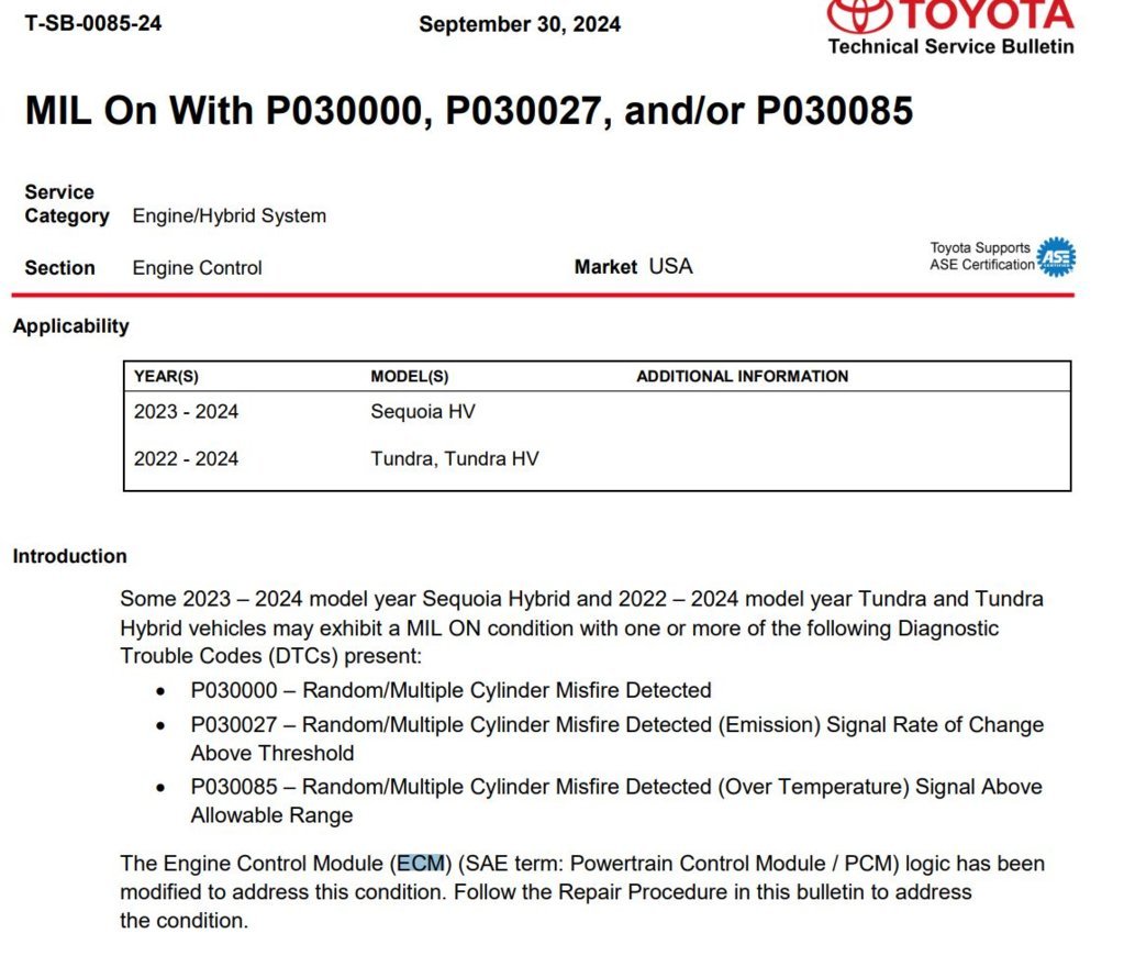

    Just saw this on Facebook group and thought it could be of benefit to post it here.
    Based on symptoms described by those affected, it looks like the trucks "start shuddering hard, give a brake malfunction error along with a reduced power warning, and instruct to pull over immediately." Understandably, it seems like classic symptoms of the dreaded engine failure.
    Well, it seems like in this particular case (if all conditins are met), the remedy is to request the ECM reflash. I attached the TSB to this post (included affected VIN ranges).
    Not sure how many dealers are aware. Hope this helps.

    Thanks for this update. Looks like only the Hybrids are affected. Glad that an ECM reflash will resolve the issue.

    Nope, both models. Says right there: "2022 - 2024 Tundra, Tundra HV".
