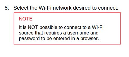

    Unless I'm misunderstanding the wording, this below from the TSB seems ridiculous from a security perspective
    Who in their right mind doesn't secure their wifi with a password?
  17. Jul 19, 2024 at 6:53 AM
    sudobash
    sudobash New Member
    Jun 13, 2024
    #118355
    606
    That is describing a Captive Portal, much like a hotel uses. It is not describing an Open Network.
    And plenty of Guest Networks are open, but require acceptance of a usage policy.

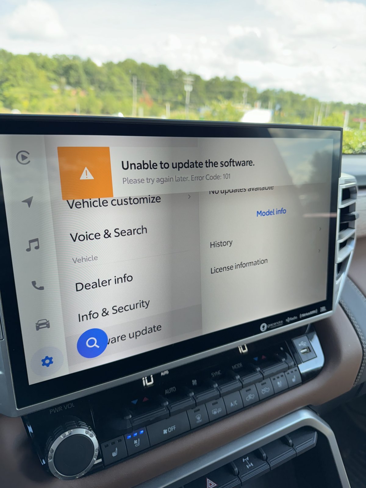

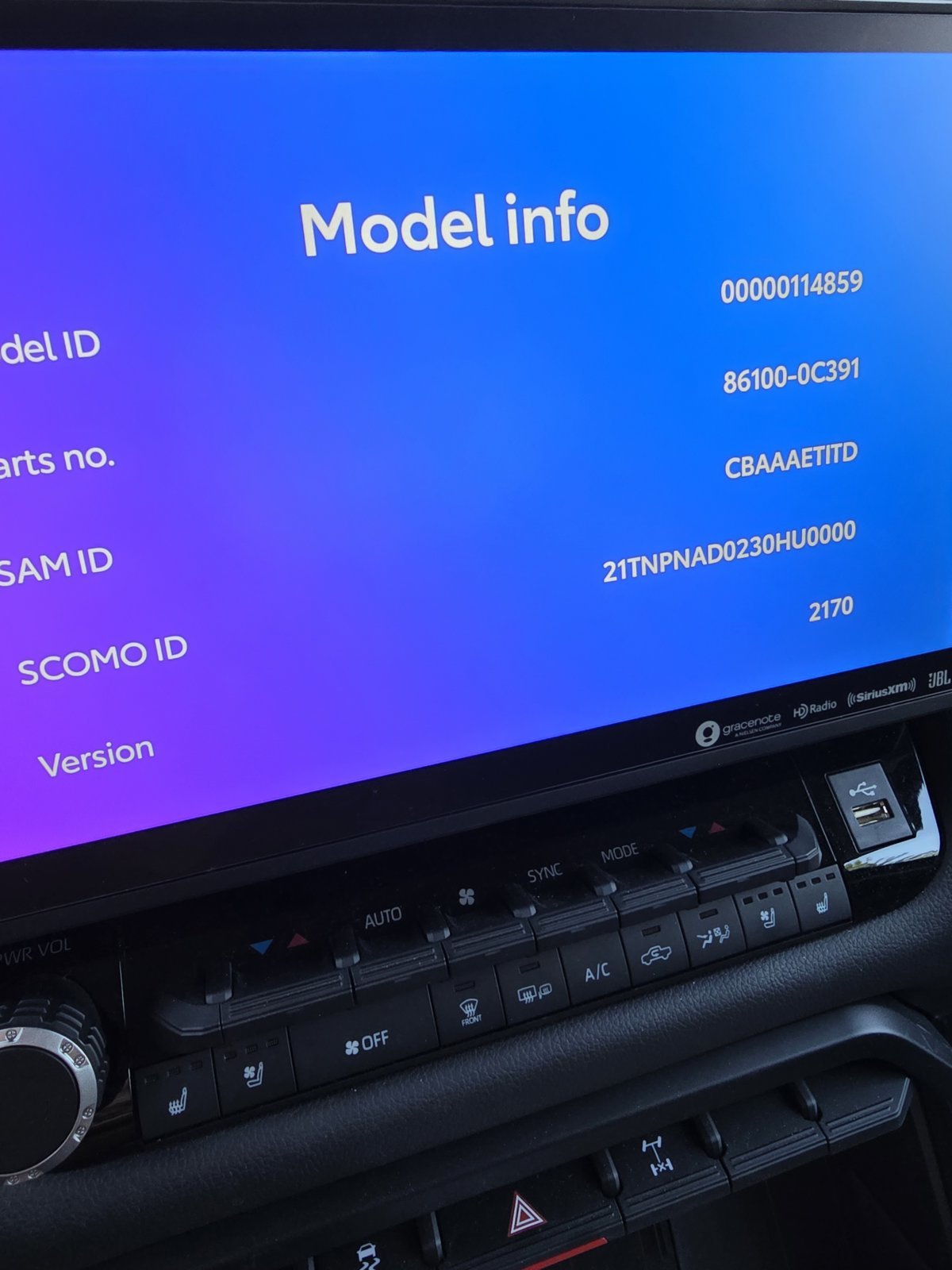

    I tried to update today, and I'm not sure it worked. I do see the HU SW updated to 2170 but that's it and I keep getting this message flashing on my screen.

    I'm now getting that error after updating yesterday. Smfh

    I am trying to do a USB update, but it says, "Software Update File is being requested" for over 10 minutes. Not sure it's working.

    After several hours of "software update file is being requested" the message came up that "your system is up to date".

    I loaded the update to 2170 yesterday. I like the Toyota toolbar on the left while using CarPlay, but I don’t like how CarPlay switches to Waze even when I am using Maps if I swipe to the CarPlay home page. I removed Waze and now it stays with Maps. It’s strange how it seems like it has set Waze as the default Nav app you would think it would use Maps by default.
